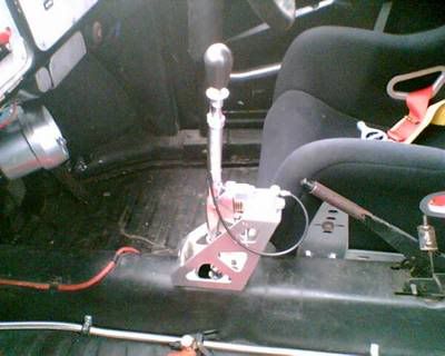

volkdent March 19th 2006 14:18
That shifter is crazy! Where did that come from? Looking awesome.
speedy March 20th 2006 16:22
hi volkit is a gwd seq shifter you can buy them from bernard newbury in england or gwd in germany, they are about 560 euro's and come either for a 4 speed or a porsche 5 speed , a company called cae makes them , they are available for many different cars , i posted the web address on the interior\electrical thread somewere
j :D
ricola March 21st 2006 06:14
Correct me if I'm wrong, but I don't think they are sequential shifters, just sequential style being so high...
Looks liek Bernie has started selling them now, must have passed his testing!
http://www.bernardnewbury.co.uk/stor...roducts_id=122
Rich
speedy March 21st 2006 16:34
yes rich you are correct , they are semi sequential , on the way up you put in first knock it down for second but when you knock it forward for 3 rd the spring mech shifts accross the gate for you making a very fast short shift , go down the box as normal , these have hardly any travel on the shifts so are very quick
cheers
jon
ricola March 22nd 2006 05:11
Not taking anything away form that shifter as it is very nice, but my understanding is:
sequential: clutchless/gateless changes, just push the lever back or forwards to change up/down
semi-sequential: as above but you have to use the clutch.
The GWD is just a high quality, short throw, sprung shifter..
Rich

Chris Percival April 10th 2006 03:07
Great project! More high-res pics needed.. :) I am planning to use one of those shifters. What are your experiences with it? What does the throw work out to be? Any problems?
http://www.fastbug.net/gallery/album...l_DSC00939.JPG

Originally Posted by Chris Percival
It's awesome! Is it a GWD??
Chris Percival April 12th 2006 04:50
Its made by CAE-Automobiltechnik.. GWD just buy them and sell them on. I got mine from ebay. :)

DORIGTT April 12th 2006 09:28
So speedy,
Any truth to the shifter not being 'smooth' enough to shift it quickly?
speedy April 12th 2006 11:38
hello chris and dorigtt, the shifter works fine, it is a bit time consuming to get it set up ,you must put another 4 holding bolts in the base to keep the shifter solid or you will find that consistant shifting is near impossible , i made a plate to sit on top of the base and bolted through this, do this and shifting is a pleasure the throw is about 1.5"-2" depending on how you set it , on my standard i had to cut the handbrake down 25mm to use it but this is no big deal , i have heard allot of people have had problems with this shifter ,most of these will be fixed by making the base more ridgid as the pivot point is 150mm above the tunnel
hope this helps
cheers jon
p.s will get some high res pics on as soon as i can

Chris Percival May 3rd 2006 14:35
Can it not be mounted in 'reverse' ie backwards to how its mounted in the image above so it clears the handbrake?
