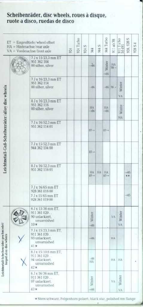

Does anyone know what size (originally) the ones that "64bug" is using? I am trying to research these wheels and I know that there are different styles. The ones pictured have much more of a "flat" face and not as much of a lip. I would like to know what the width and offset are. I know there were about 10 different width/diameter/offset combinations available. Thanks.

Bullyboy March 12th 2008 20:05
i think those are the big offset 928 wheels

Chisel86 March 13th 2008 11:43
I kinda doubt it. Hugovw1976 is using 8x16+52et (951 362 116 01) from the 928 up to 85, and the ones that 64bug has are not the 16" version. Unless he had the 7x15+65et and cut them down, but the rears don't look like they have a 65mm offset...
Bullyboy March 14th 2008 17:57
front were cut down and re-welded to 5.5s
7JX15/65MM 928 361 019 00
the 65mm offset are the only ones that stick out past the outer rim, which his do on the front and the back.
