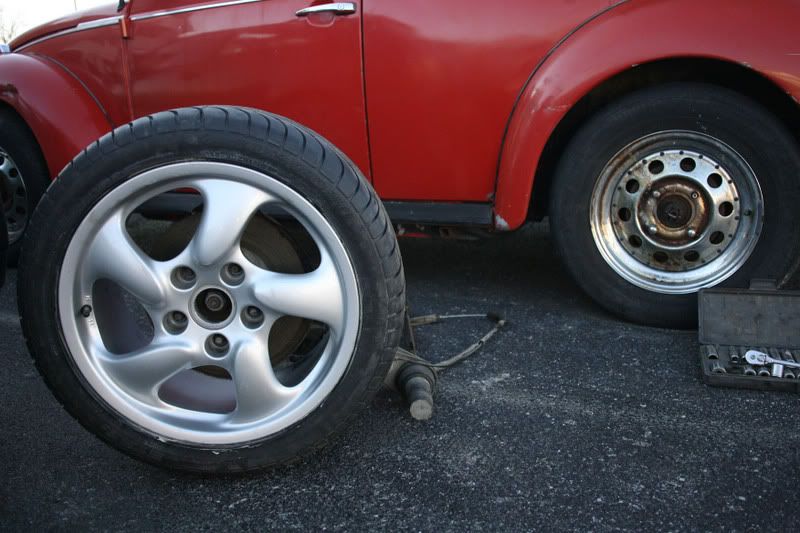

here they are, and check out the ones that came on my sweet ride :cool:

i couldn't bolt these up until today when i got my lug nuts, but here's what i'm looking at:
http://i91.photobucket.com/albums/k2...7.jpg~original
i'm pretty ignorant about 944 stuff, but doesn't this have to be a center bore issue? if i use spacers i'll run out of stud because i only get 5 turns at this point.
if i machine the wheels they might not take the center caps, and if i machine the hubs they won't be hub centric to any normal porsche wheels.
any advice?

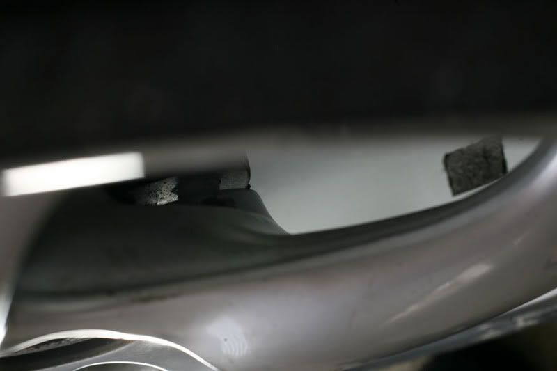

one could maybe call it a depth problem. here's a picture of where it rubs:
http://i91.photobucket.com/albums/k2...3.jpg~original
so the bore is fine until it hits at that point, i guess.
