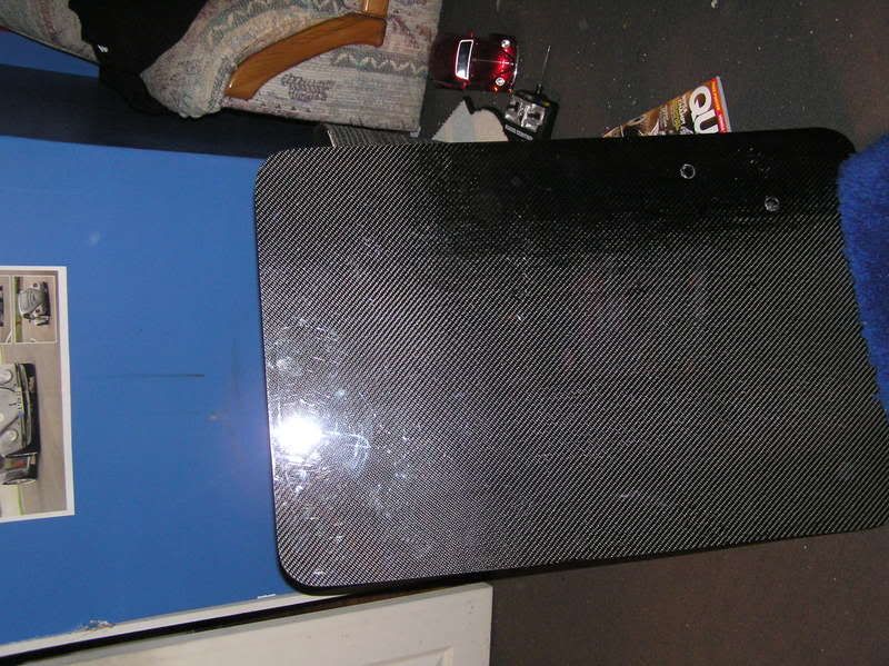

HEY got Some time to do abit on the Panels here's some pics
chris.
chug_A_bug December 31st 2007 22:19
all I did was Measure where each pin was and re-marked it on the back Side of them
then I was just going to take side cutter and cut off the back of the pin so it will sit Flat
and I'm just using super Steel epoxy from Lepage just got it at Crappy tire.
