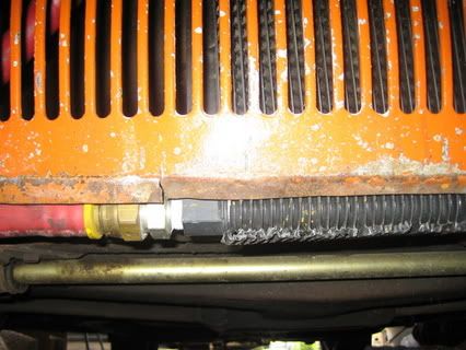

Here's my setup on the race car which may work on a street car. Oil cooler is a Perma-cool Maxicool unit, 10.5" x 14" x 3.75" including the 900 cfm fan. I'm running 1/2" lines and -8 fittings on everything. The oil cooler sits in a custom frame of aluminum angle that bolts to the body and has a brace underneath to a stud on the block. There is a thermostat inline to turn on the fan and a manual override switch in the dash. For a street car you could run a smaller one that would fit better behind the wheel.

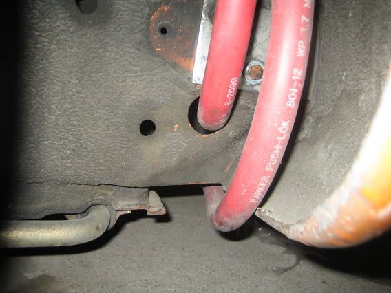

petevw April 15th 2009 01:40
Thanks for the info/pics.
I have what looks like to be a Mercedes oil cooler. Made couple brackets to attach the cooler to the beam/pan bolts. The in/out fitting of the cooler are really close to the beam so i will try to figure out a 90deg fitting that will allow it to attach to the oil cooler(M14) and end up in a -8AN/JIC.
I'll try to get pics up soon.

I've mounted the oil cooler up front. Modified my mounts and flipped it around so the fittings are facing forwards. It was looking like the fittings would hit the steering box and beam. Waiting for the PARKER Hydraulics salesman to figure out how to get the M22 oil cooler, to a -8AN. We'll see what he can come up with.
If i don't like were this is heading, i may go for a Setrab as Nigel and Zen have setup. I'll need some pics, if going that route. The Setrab may save me money, as plumbing the cooler up front with sexy AN stainless fittings/hose is not cheap.
