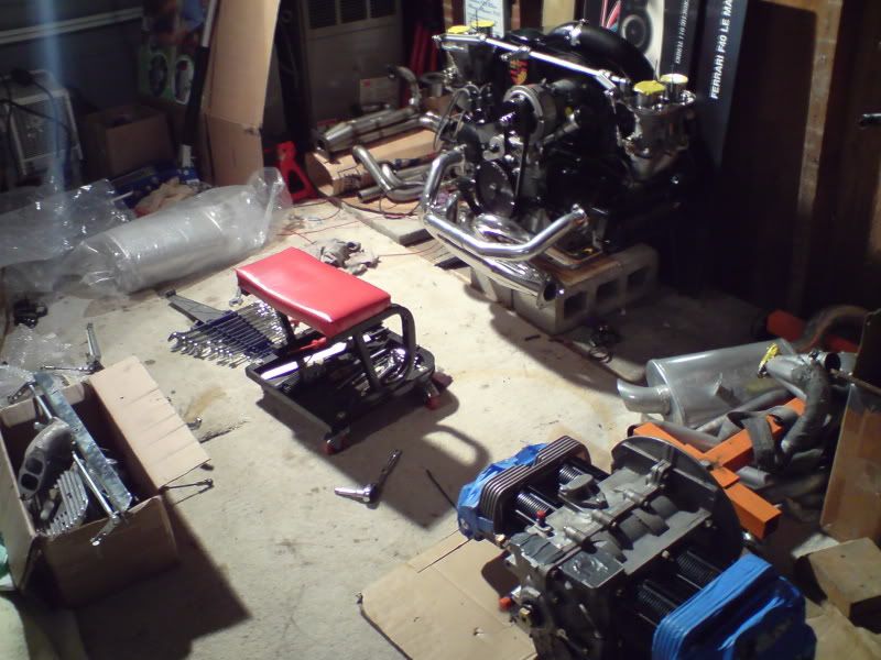

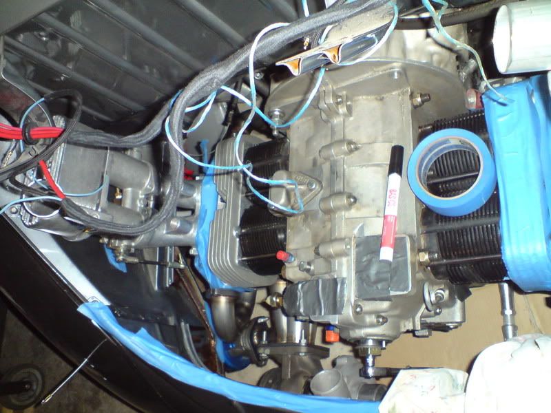

Test fitted the 2332 EFI turbo longblock. Had issues with the ARPM case not mating up to the Autocraft trans. Thought it was the trans input shaft bottoming out on the flanged crank. Tossed on my empty case from the blown 2332, it fit with no issues. Tried another trans with the ARPM case, no problem. Seems like the ARPM case and Autocraft trans are of the same size. So need to chamfer both.

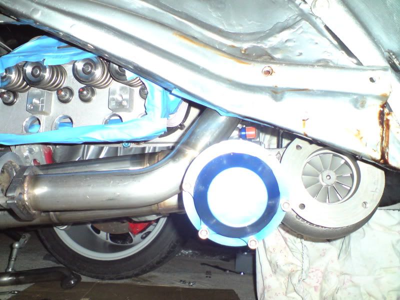

Bolted up the turbo header and the #4 exhaust pipe was hitting the body. Header is custom. Stainless under the apron for a T04 turbo. When it arrived, it was missing the #3-Jpipe. So had to wait for it to show. Will need to cut the flanges off the pipe, cut down the header, and reweld. You can see how far off it is bottom left of the pic.
To give you an idea on timeline. I sent my turbo, and wastegate to California on March 12 '08. Finally header got done and i was to pick it up when in Vegas for the Bugoramma(Oct '08). Header box, with turbo didn't fit in rental car. ;) Parcel sent to Buffalo. Picked up from Buffalo. Missing pipe finally made it to my house in Jan 23 '09. Now i need to modify it cause it doesn't fit. :mad:

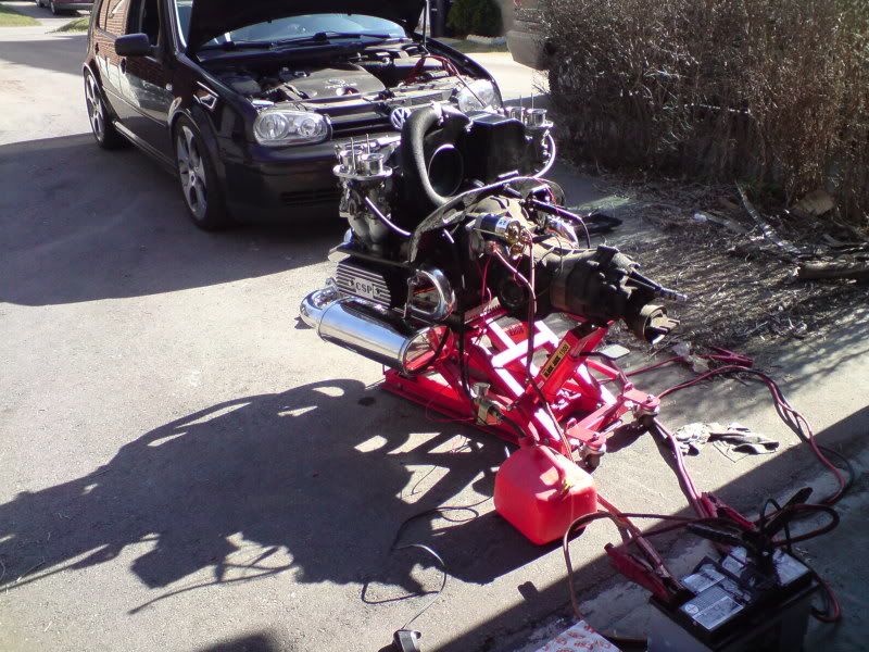

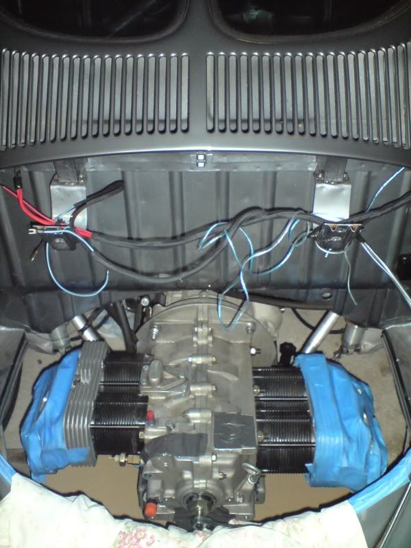

So since the turbo motor was taking forever, concentrated on getting the 2275 together. The A1 sidewinder exhaust didn't fit well. The #1Jpipe was quite a bit off and had to muscle it on. It was missing #1pipe) from the original shipment, and was sent afterwards. The rest of the header isn't sitting properly and leaking when bolted up. So need to cut that #1 flange off, reweld in the proper position to relieve the pressure, and get it ceramic coated again. Dammit....
Smoked a Pertronix in the dizzy when trying to fire it up. Bad new coil. Borrowed a 009/coil from Greg(TunedPerfection). Looking at a Mallory dizzy now.
The engine fired up really nice in my driveway. Should have good power, as the ATV lift left some divets in my driveway. :D
Both headers interfere with the kafer brace drop bars to the frame horns. I had to remove them. They were setup for use with a Type4 motor. I will have to modify and reposition them later when the engine and driveshafts are in. Time to tear down the 2275, and install in the split. The DTM shroud will be cut above the valve covers. This will make them removable for the install in the narrow engine bay.

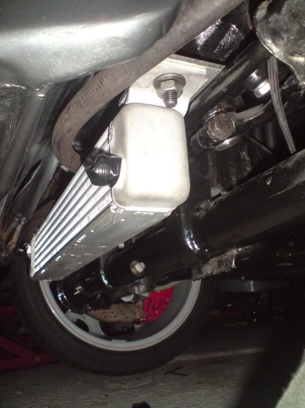

Here is the oil cooler mentioned in the other thread that has been flipped around to have the fittings face the front. When facing the rear, the fittings were too close to the beam and steering box. Aluminum angle was used to get it mounted to the beam/pan bolts.

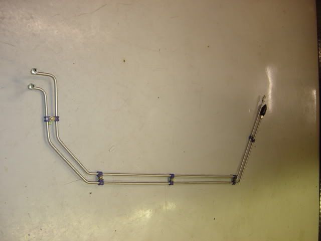

Trying to come to a decision if i should pull the hose out and do all the oil/gas plumbing in AN fittings and stainless braided hose. Need to decide this week.

I would keep the hose Pete.
Stainless will rub and scratch the inner paint of the tunnel which was flooded with POR 15 btw.
You do not really see the hose either. If you must have stainless braided hoses do it in the engine compartment with AN connectors.
Just my opinion. In the NSU I will use stainless pipe thru the tunnel. The good thing about the NSU is that it has 3 access panels from the bottom of the tunnel so I can properly secure the pipes.
NO_H2O May 3rd 2009 09:50
As far as the oil plumbing goes. I would bend up a pair of 1/2" ridged stainless lines (heavy gauge) to run from front to rear and use shorter lengths of hose at either end. The pressure flux and cooling will be better with a ridged line
Here is a pic of 3/8 lines for fuel but it is the same idea.
http://i209.photobucket.com/albums/b...4.jpg~original
petevw May 3rd 2009 10:37

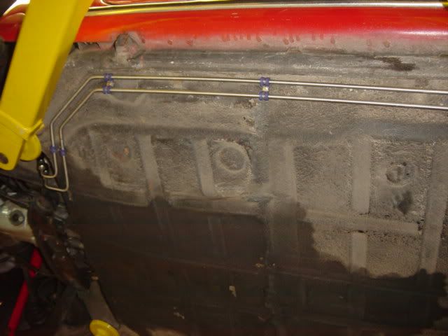

Thanks for the comments. I had a fuel hose burst on the super the night before a criuse, what a mess. Was thinking the stainless braided would offer better protection, especially from the shift rod that moves around in the tunnel. I'm liking Dave's idea. Stainless pipe, with hose ends for flexability. How to secure inside the tunnel? I'll look at it today.
I secured my oil lines with a rectangular shaped washer from one of the pan bolts. Drilled a hole thru the tunnel, and sent a bolt thru the washer to hold the lines up against the side of the tunnel.

Man what is it with you and J-tubes? Sweet project though, got any updated shots of the rest of the car? I'm really diggin' the atv stand for the motor and tranny, have you tried using it to get the drive train in and out of the car? Stainless or aluminum hard line is the way to go for fuel and oil to the front of the car. The easiest way to secure it is to use adel rubber insulated clamps which can be found in hardware stores or aircraft supply shops.

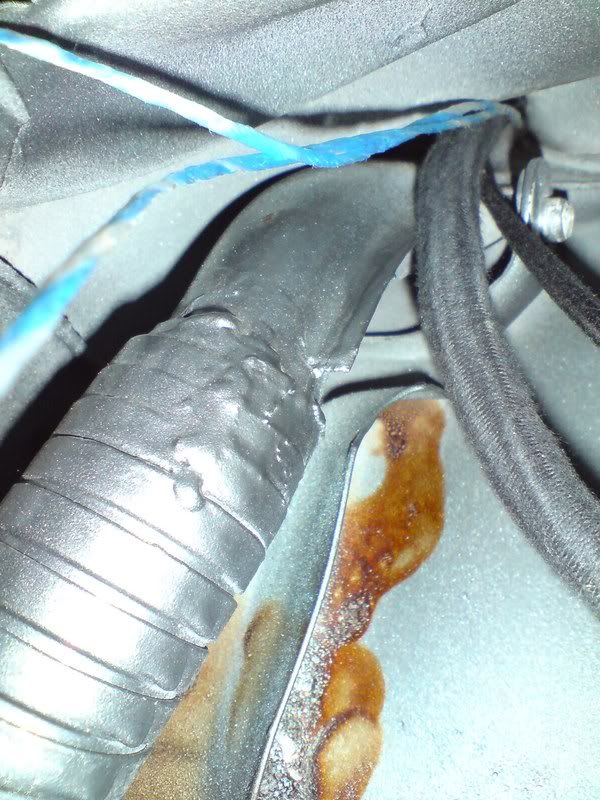

Took a look inside the tunnel. 2 fuel, and 2 oil lines will be very tight around the nosecone of the 5spd. I'll grab a few small pipes tommorrow and see how/where they can fit in there.

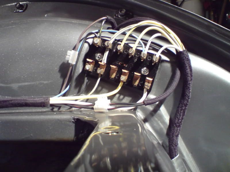

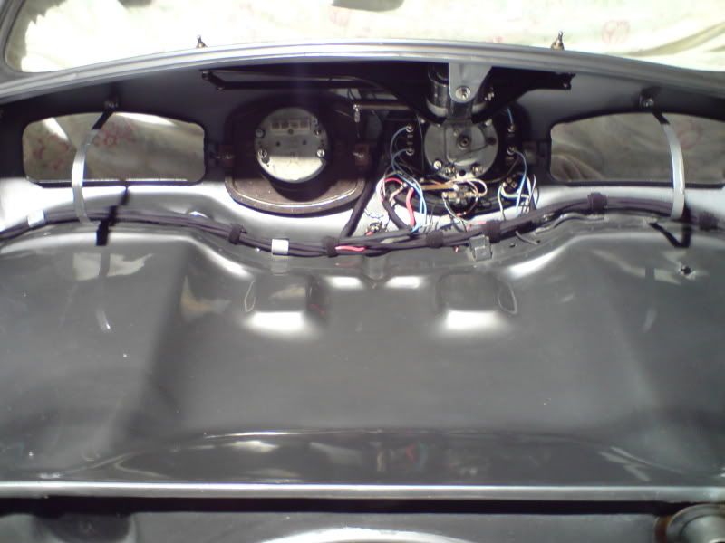

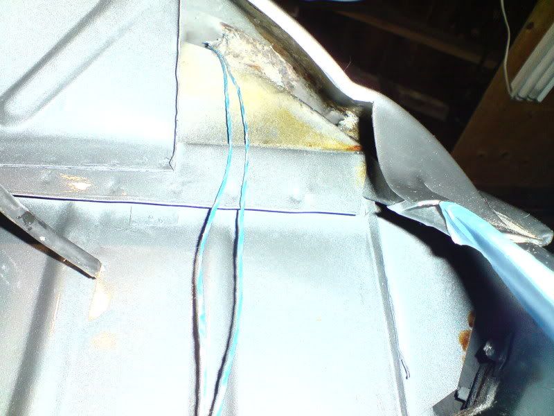

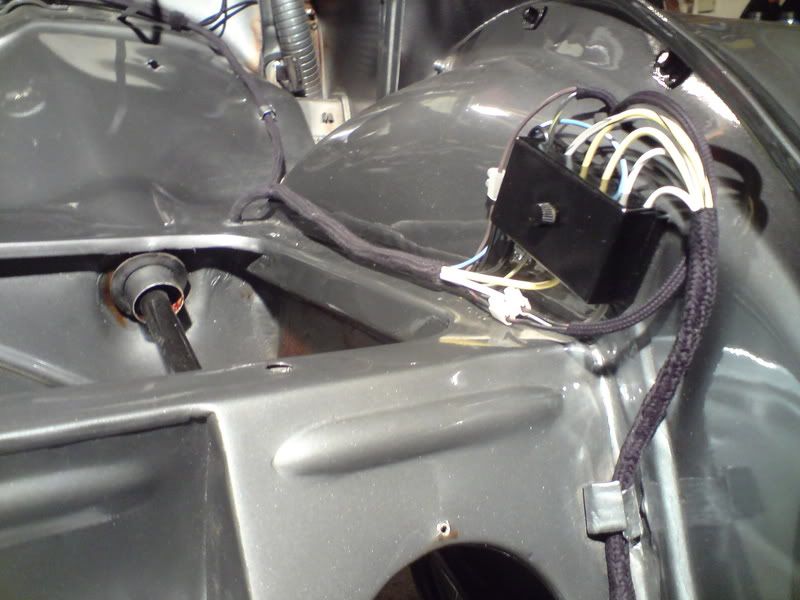

Main wiring harness is now installed. There is only 1 guy that makes these pre-52 harnesses in his garage. He starts making them only when he gets a few orders. Harness is PVC wire, soldered, and cloth braided. Same as OEM. About 2yrs in the making, that was installed in January '09.
Pulled nylon twine throughout body to use as pullcords.
I included some tricks of my own. Ceramic resistors to drop to 6V for the semaphores, that were found after looking in a few electronic junkyards around town. Rear tailights are dual circuit for running and brake lights. Need to terminate the rear lights, and headlights when installed.
If you have some line bending skills, you can bend the lines to tuck up in the body mounting bolt channel to run from front to rear and clamp them securly using some tabs at each body mount bolts. The pic I posted above was of a 912 that does not have the channel. I ran mine (fuel line) in the right channel so it would be protected. I will have to do 2 oil lines (1/2 inch) on the left side of mine when the oil cooler goes in the front bumper/spoiler. The heavy stainless is hell to flare for AN fittings. I bent everything then took it to a hydraulic shop to have them flared.

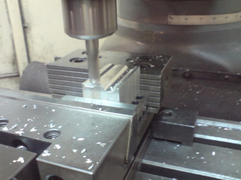

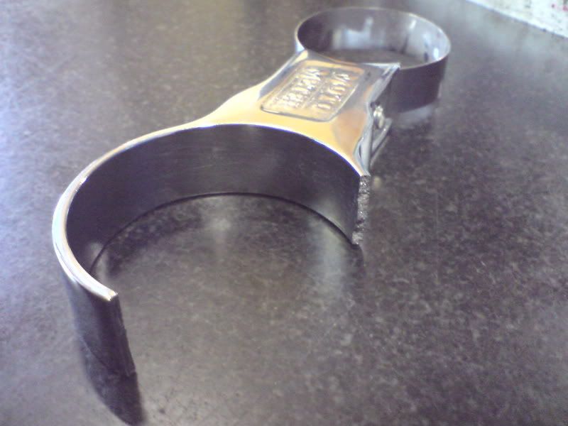

Didn't want to modify the dash for gauges. Bought a multifunction gauge to mount at the steering column with a Motometer holder. The gauge holder broke when i put the gauge in. :mad: So made a aluminum ring and bolted it to the Motometer center section. Need to polish it up now.
gauge:
http://www.aircraftspruce.com/catalo...2.jpg~original
"The E-3 can measure up to 4 EGT/CHT channels, a RPM input, a universal temperature sender input and a universal pressure sender input with a user programmable low/high alarm limits."
Need to wire up the motor and run a multiconductor cable to the steering column.
