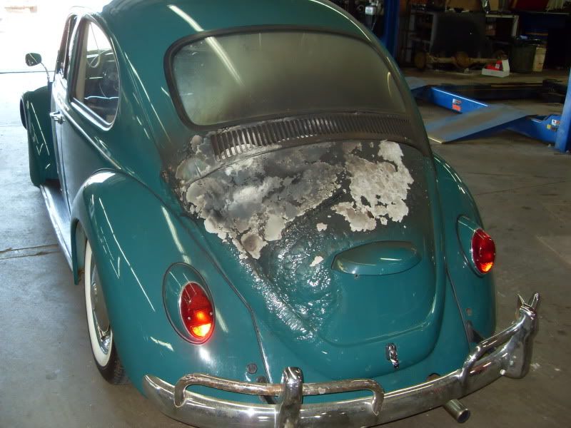

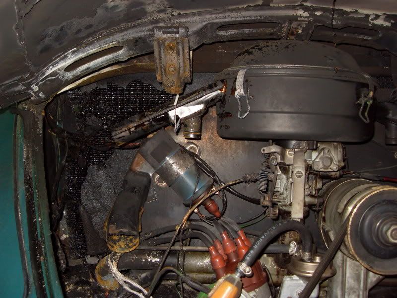

A bit of crappy news ... coming back from the Waterdown car show / swap meet this afternoon, I had a bit of a car-B-que in the 67 I just got. Looks like the fuel line tube that is supposed to be pressed in to the carb casting came loose. Car died out, I pulled in to a driveway, and a person in a car that was passing by was yelling that I had flames back there as I was getting out to take a look. I should have had an extinguisher with me, but didn't. Luckily some people driving by stopped, and had a jug of water that was enough to douse the flames. The sweatshirt I tried to use didn't do too much.
So the paint is burned off the engine lid and vent panel above that, and blistered on the quarter panel a bit. Underhood I think it was mostly the tarboard insulation on the firewall that burned, the wiring and hoses on the one side where it was flaming up don't look too bad.

It is quite easy to fix those lines for good. I usually give them a good yank when servicing it will come out if at all loose. I then sand it slightli and tin it with ordinary solder. I shake it while hot to live the thinnest smear of solder. I tap it back in and have never had one of those come out

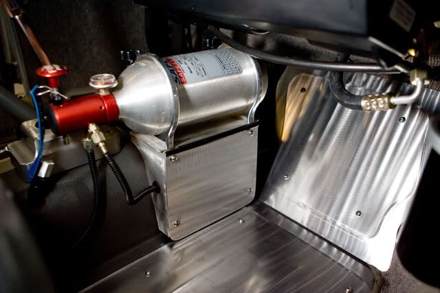

If you have the room to install a system, these are nice and give you some peace of mind.
We put one of these systems in the Herbie X. I will have one in my car but haven't had much time to get it done. I put a hand held fire extinguisher in all my vehicles and every one that leaves our shop. You just never know when you will need one. I think the system cost @ $350.

Ed I don't know if your car had this going on, but here goes ...
Public service announcement time:
Never put a filter on the pressure side of the fuel pump, avoid putting it in the engine bay at all.
Under the fuel tank or above the transaxle are ok.
- cheap filters can crack or even burst under pressure especially if the engine is running hot, the engine bay area will get warm
- filters can get heavy (filled with fuel) and wiggle the fitting on the carb loose
... fuel filter rant over
