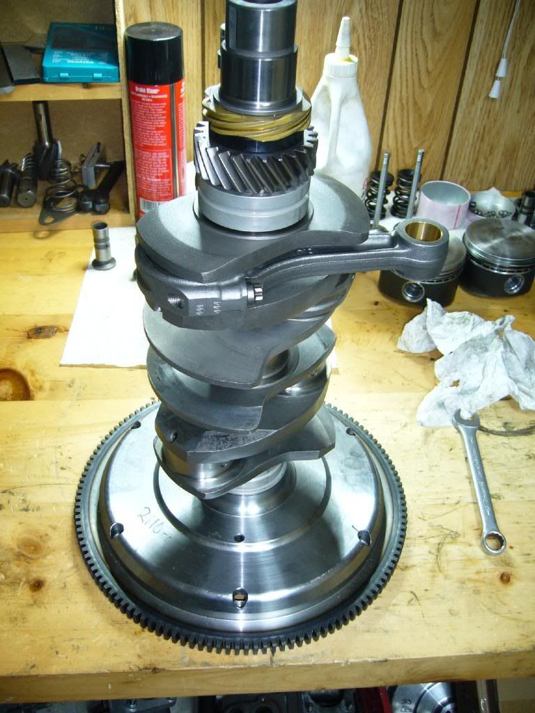

Here is the crank assembled, with the end play set. It's just about ready to be sent out for balancing. I've started to install the rods in order to mock the motor up to check the deck height.

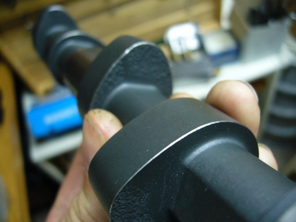

Here I've put a radius on all of the came lobes. The is to prevent and hard/sharp edges and limit any chipping or fracturing on the brittle edges. Just a little goes a long way.

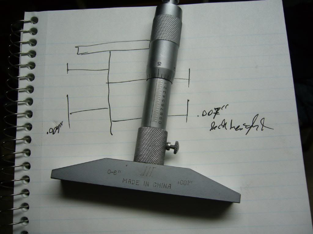

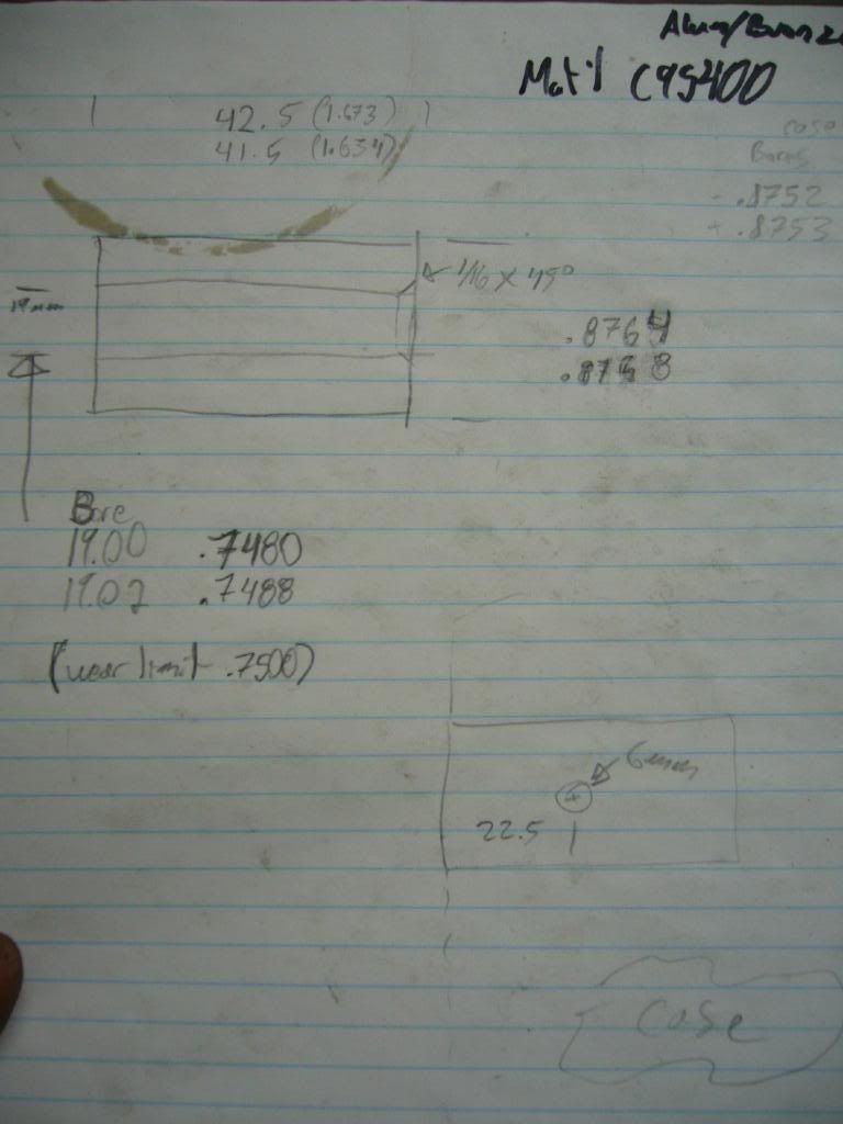

Although this was a relatively new case, abusive driving and a steep cam; the lifter bores needed to be sleeved. I use C95400 Aluminum Bronze. Here is my sketch:
http://i30.photobucket.com/albums/c3...6.jpg~original

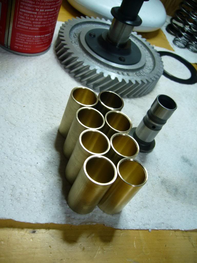

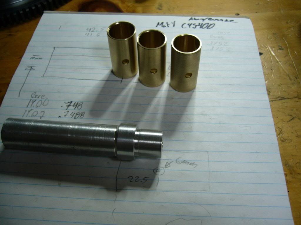

And the fresh bushings off of the lathe:
http://i30.photobucket.com/albums/c3...8.jpg~original
Ready to be installed with my specially made install tool:
http://i30.photobucket.com/albums/c3...9.jpg~original
Normally it would be best to use dry ice (-104), or my favorite, liquid nitrogen (-328) and shrink fit them in. But you have to use what you've got, so in the freezer for a day and then pressed in.
Installed in the case:

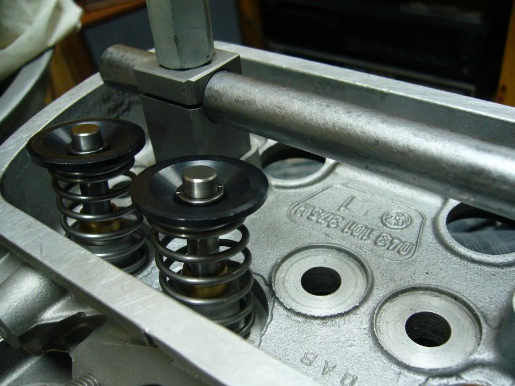

Dummy springs being installed in prep for setting up valve train geometry:
