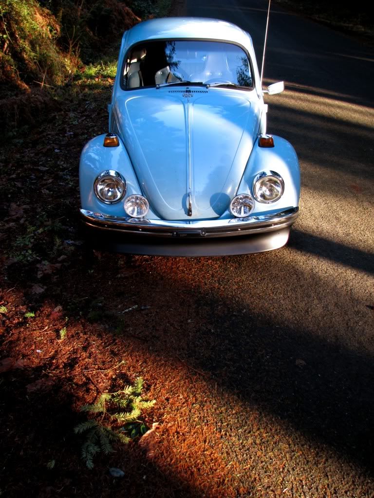

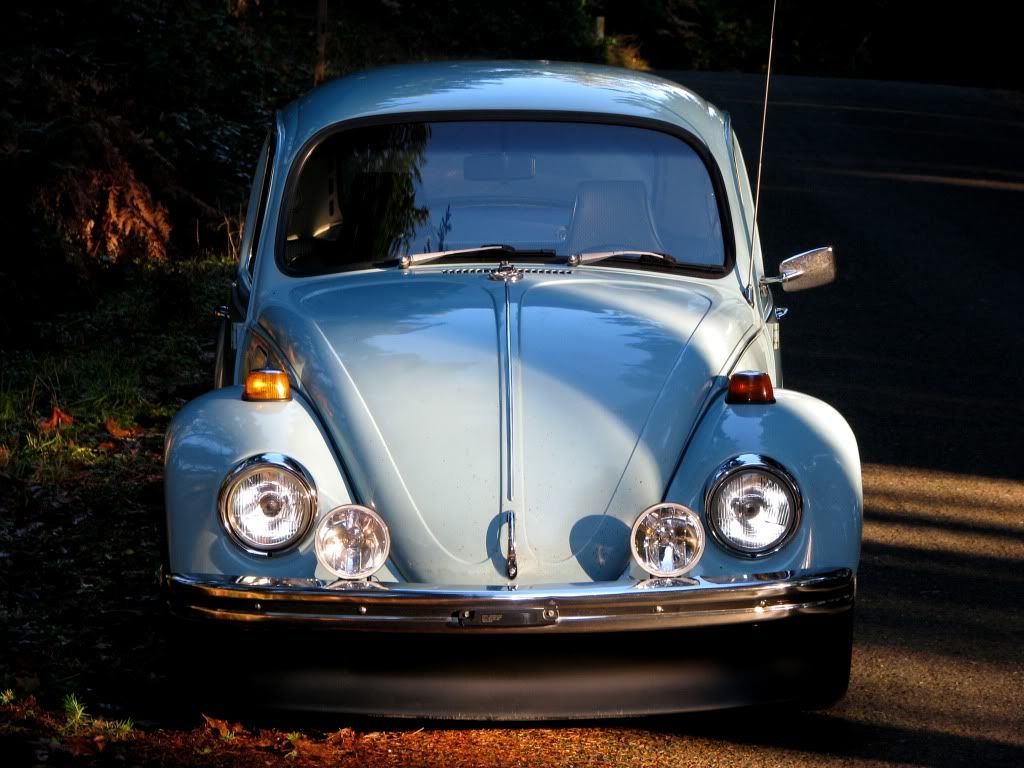

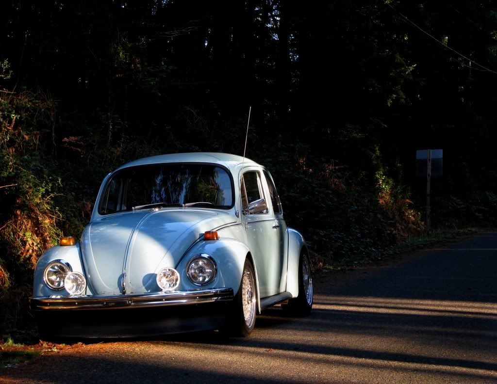

The newest addition (Christmas present to myself) would be the Kamei spoiler. ITS LOW!
http://i150.photobucket.com/albums/s...t.jpg~original

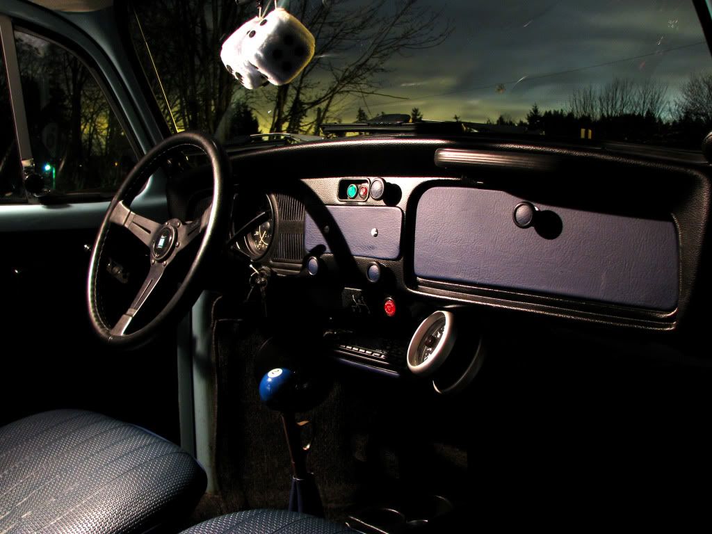

And the Nardi wheel.
http://i150.photobucket.com/albums/s...5.jpg~original

that Kamei Looks SWEET... nice Score from Ebay ;)

Looking good! Now lets see some photos of how you mounted it, you know...for archives sake.
Humble December 27th 2009 23:00
I love that look :thumbup:
Make sure you secure the spoiler to the fenders though or the mouting tabs will break.

Wow didn't even think of that! Good advice!

Looking very GL, have you tried it on the highway yet, the Kameis really make a difference.
NO_H2O December 29th 2009 13:40
Very nice. Watch those speed bumps and curbs. The Kamei is made of ABS plastic so it is forgiving to a point.

I am actually thinking about supporting the front of the spoiler from the front similar to like this
http://www.ssdd-motorsport.com/image...ts/247-1.pjpeg
You can buy the supports. I would attach it to the spoiler itself and the bottom of the bumper.

I'll try topost picks of my Kamei spoiler supports... They're a little more stealthy than the BMW ones in that pic... and don't require drilling holes in your fenders...
72marinablue January 4th 2010 18:48
That would be much appreciated!
kuleinc January 4th 2010 19:24
It involves bolting a plate to the bumper bracket bolt and one to the hole in the spoiler and getting a piece of rod and welding it to each plate. I can't find any pics right now, but if you use the right bumper bolt and position the plates in the right way the rod connecting them should clear the fender no problem!

Great pics! I like the BBS wheels too - very classy!
