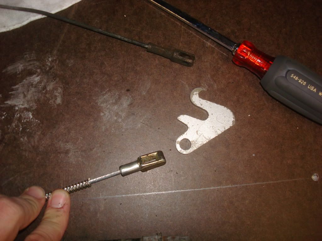

Alex, this is what the stock beetle cable looks like, connected to the swans from Lanner: Sorry I don't have a better pic.
http://i260.photobucket.com/albums/i...6.jpg~original
You probably ordered a wrong pair of cables, but by my knowledge, all beetle parking brake cables are the same, at that end, so it's a bit strange.

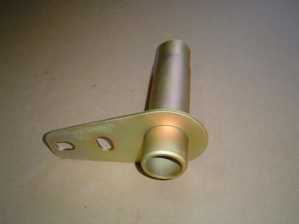

Oh, and do you have those 2 little tube-like pieces from Lanner too? Depending on your alu arms, you might need them, to fit the cable into that bracket.
Bug@5speed(US) January 15th 2010 23:50
Xellex,
Ok mystery number 1, is solved. This is what I get for doing this at 10pm at night after a long day..
The cable end I have is correct, so thanks for the pic as this cleared things up..
Now for part 2, the little tube like pieces, did not get them.. I thought I did not need them with the alum arms. Can you take a shot of the tubes, as this may clear up my problem.

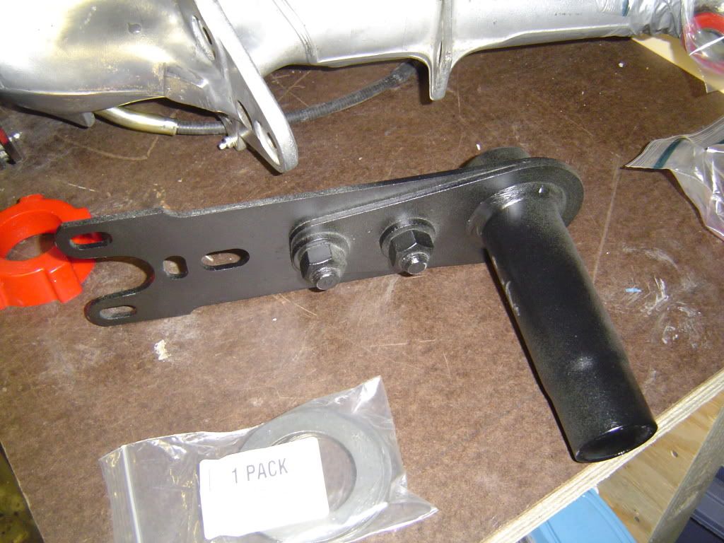

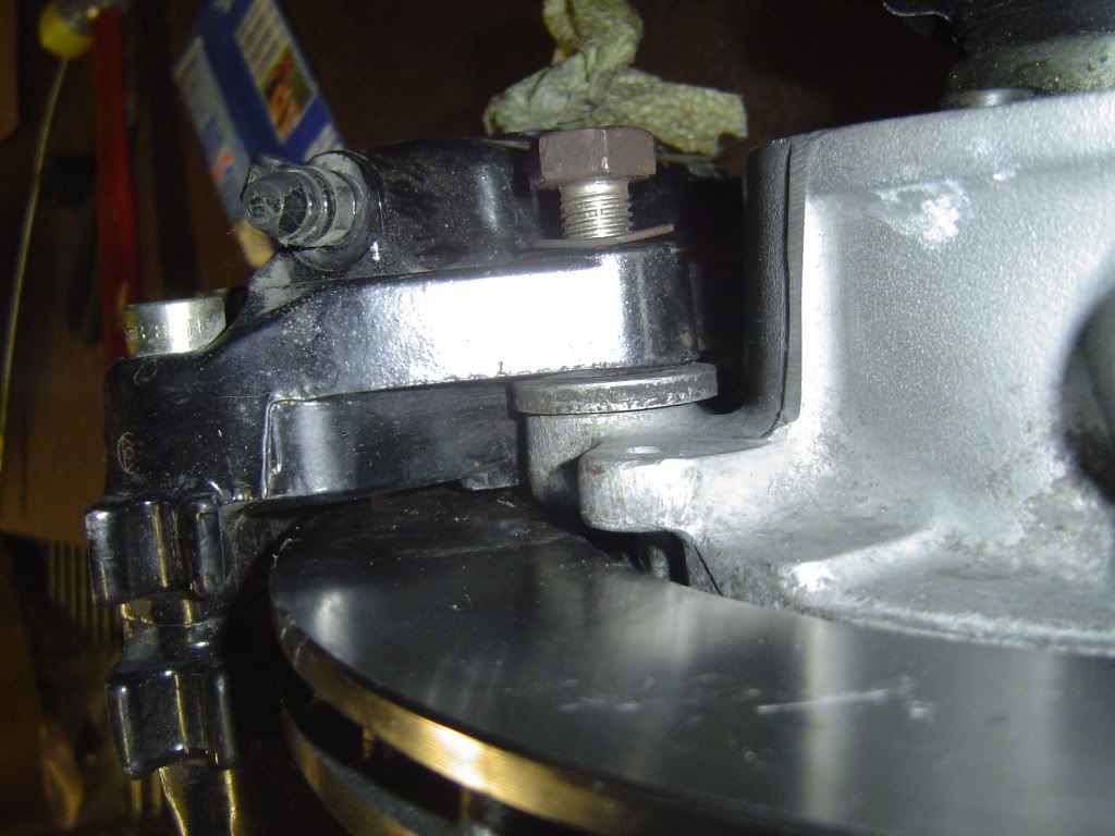

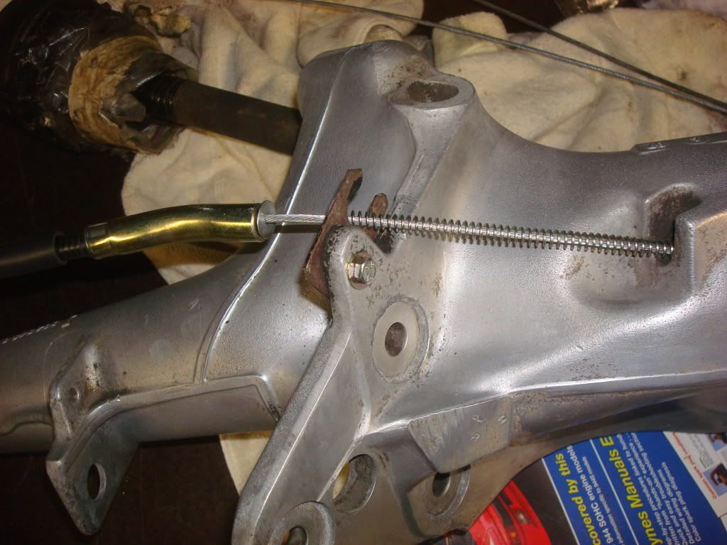

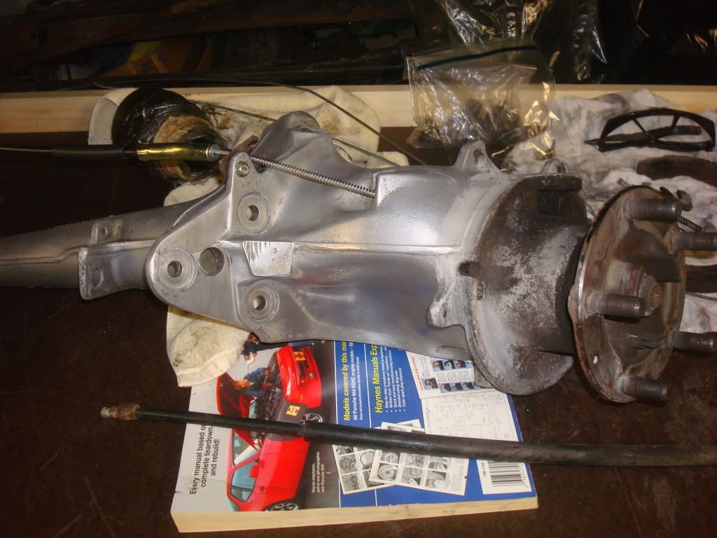

I have some pics as promised so here goes:
1) Picture of my 87+ arms
2) Swan and beetle end.. Your pic cleared things up..
3) This is the beetle cable and 944 arm, and where I am having an issue as far as how the beetle tube should stay firmly against the bracket
4) The 944 brake cable tube, has this lip that ensure a tight fit and no slippage, and what I feel I am missing for my set up.
It seems like I may need to call or email Lanner? Thoughts?

Xellex January 16th 2010 12:03
Well first of all, you should pull the cable through it's sleeve a little more. It seems to me it's too loose.
Second, I didn't quite understand what bracket you're talking about:
http://i260.photobucket.com/albums/i...u.jpg~original
If it's nr. 1, then there's no problem, because that only holds the cable in place, not to flap around too much. (or was it for the brake fluid line/hose?? )
If it's nr. 2, then I can understand, the bug cable sleeve will not fit, because it's a bit too thick. That can be solved easily, by filing it down (did I spell that correct? -- using a file :P ) until it's a tight fit. Lanner reccomends that on his website. Don't worry if it will be a little loose, because it's not going to go anywhere. The swans are gonna keep it there tightly, eaven if the parking brake is not in use.
I took one more picture, that I thought might help:
http://i260.photobucket.com/albums/i...9.jpg~original
Oh, and one more thing: By the looks of it, you don't need the small adapter tubes from Lanner, as your alu arms are the late model ones.
Bug@5speed(US) January 17th 2010 21:41
Xellex,
Thanks a million, you seem to have cleared up my misconfusion..
It is bracket 1) as you noted on the picture, which holds the 944 e-cable in place.
My only concern is that any rubbing that occurs, hopefully it will not scar the outer tubing sleeve. Regarding the loose cable, it was just for show and has not been fitted properly to the swan and the rest of the setup.
Secondly, I will reread, what you discussed about filing down the beetle tube.. it make sense..
Lastly, everyone has been very helpful.
Thank you all for the tips and insight.. as punishment, I when I get a little time I will take some pics and help post a little article.. just give me some time.
VR
flat January 21st 2010 21:53
I'm late on the conversation, but I guess it's all figured out. With the alum arms, the vw ebrake cable end goes directly into the aluminum arm. Depending on the tolerances of the end of the cable (different manufacturers) you may have to file it slightly in order to snug it into place. It may also be possible that the end is too loose in the arm, in that case you can build up the diameter with rubber tape or heat shrink. The 944 cable retention tab is no longer used. If you're handy, I'd recommend fabricating something to keep the ebrake cable out of harms way that would bolt to the stock cable retention location. The quick and dirty method would be a zip tie.
The spacer tubes are supplied for use with the steel arm setup (83-85 944).

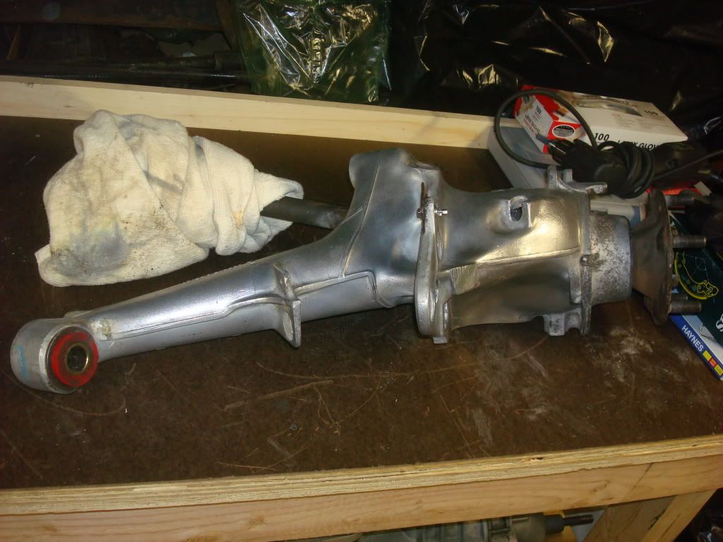

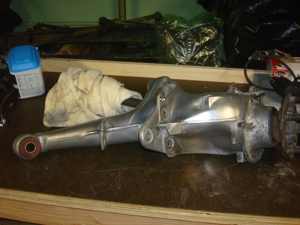

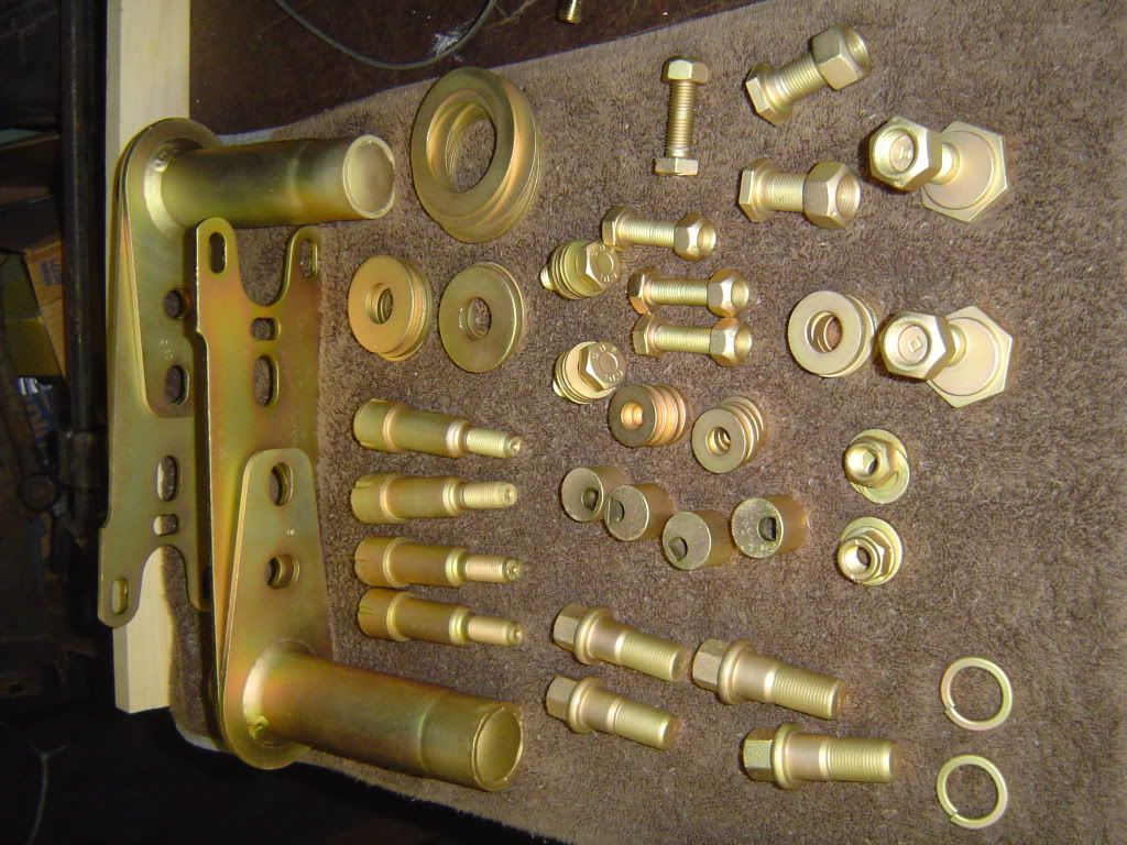

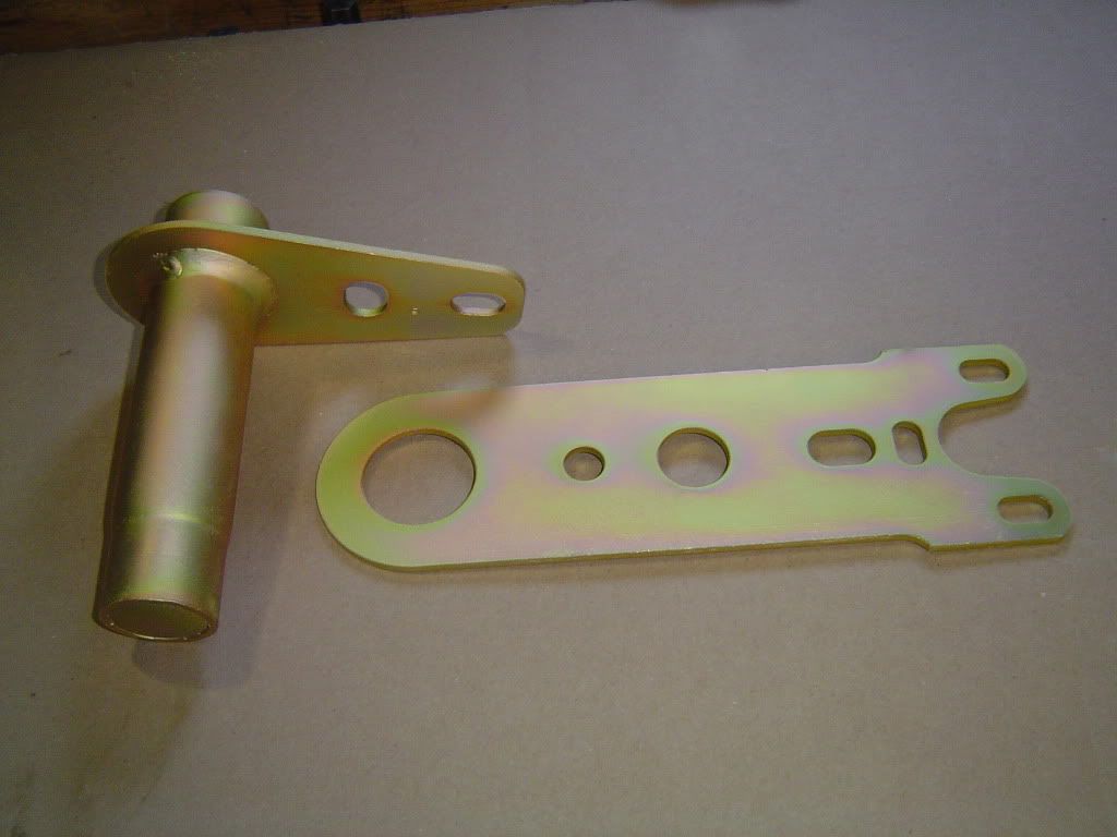

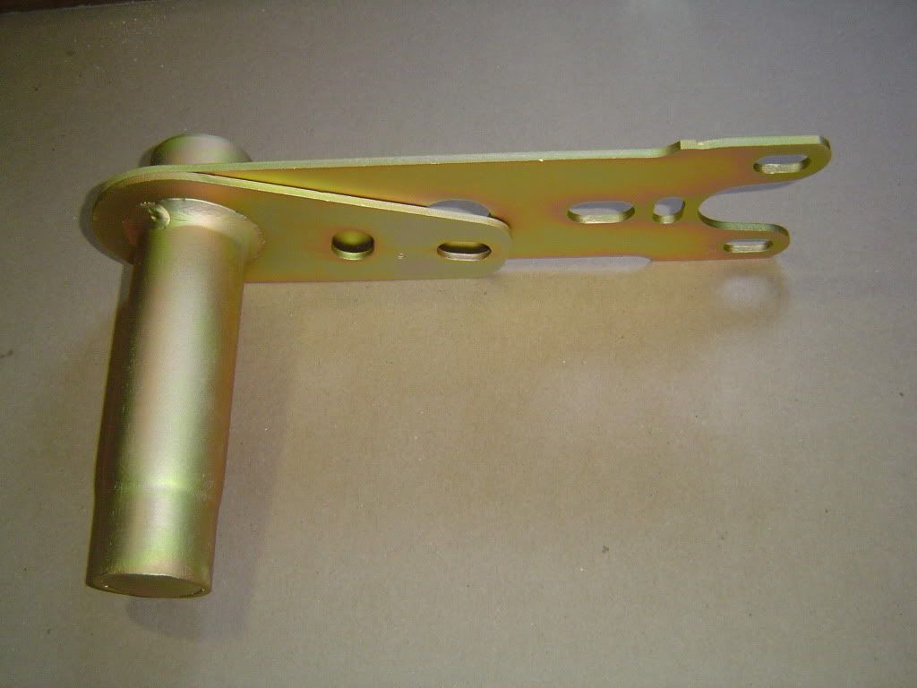

Got a little carried away.. found some polish, and saw the mothers mini power ball.. so with the cold weather and awaiting parts.. figured it could not hurt.. plus it was nice "me time" via some car therapy and was relatively free.. Enjoy
VR
ALex
Pic 1
Pic 2
evilC January 25th 2010 08:09
Alex,
Very pretty, and now you have created an excuse for not driving it "I have to spend all my time (and money) on polishing" :lmao:
