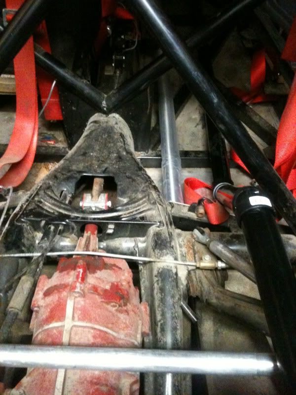

Took delivery of my new engine yesterday and have been busy.
http://i7.photobucket.com/albums/y25...rio/photo7.jpg
I had actually ordered a twin turbo motor but this one showed up.
I`m going to stay with the single turbo motor as it is soooooooooo much simpler than the tt motor. Test fit :twisted:
http://i7.photobucket.com/albums/y25...rio/photo6.jpg
Now I need to source a radiator, fuel cell, and ecu.
http://i7.photobucket.com/albums/y25...brio/photo.jpg
These 4 cam motor are wide!! There is going to need to be some trimming done to my removable rear valence.

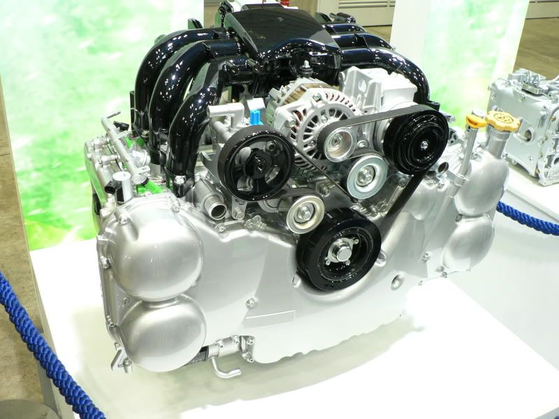

Hello, your porject looks very nice, keep up the good work. I have been looking a the late model 6 cylinder Subaru engine. I am thinkin about trying to get one for maybe a 914 setup. I bought a 2.7 911 in pieces, but I just don't like the high reve needed to produce the horse power I want. But on the other side, I would not have to worry about the radiator and it location issues.
If I recall correctly, one member stated the late model 6 cylinder was not that much longer than the 4 cylinder. I'll hold on and wait and see what I can get about this engine, this year. Couple that engine with a Audi 4 speed automatic and I believe that setup will be very hard to beat in a 914:D

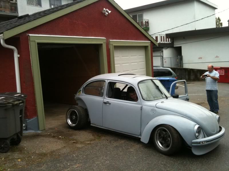

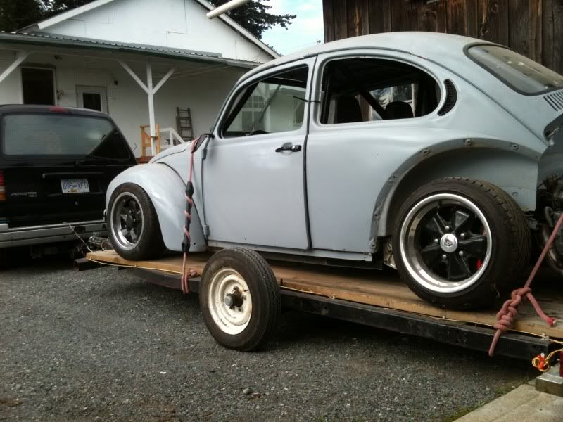

Moved my car from the "farm" in Abbotsford to Vancouver.
http://i7.photobucket.com/albums/y25...4.jpg~original
Never mind the trailer :shocked:

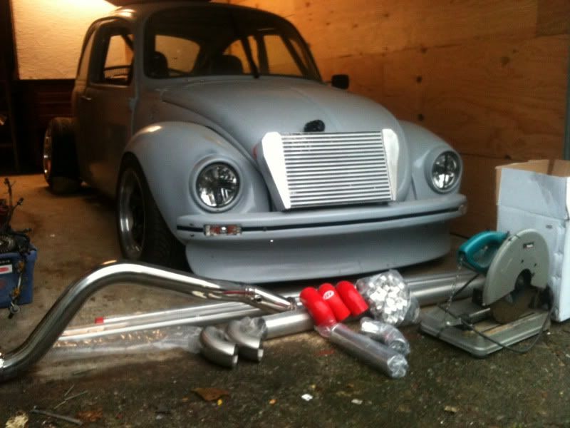

Ordered some parts.
http://i7.photobucket.com/albums/y25...3.jpg~original

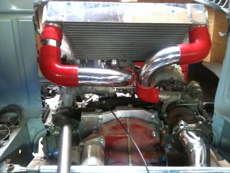

Started to install parts.

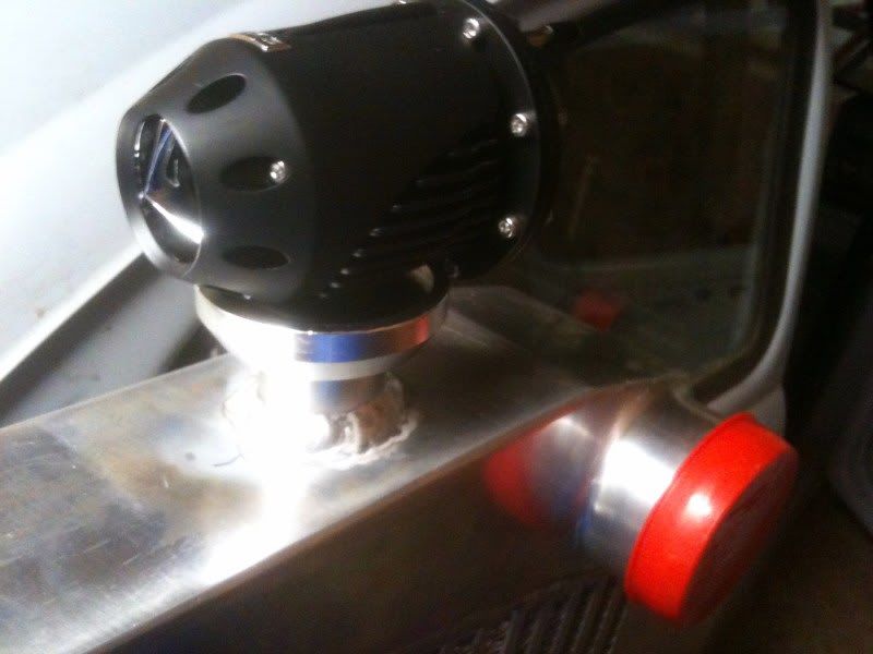

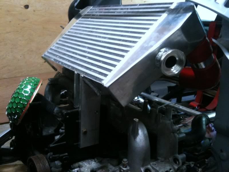

HKS BOV going to be integrated into intercooler.

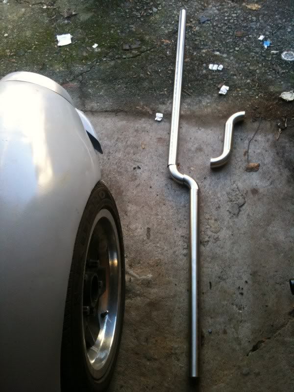

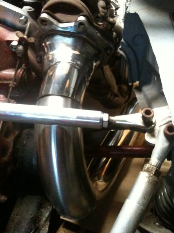

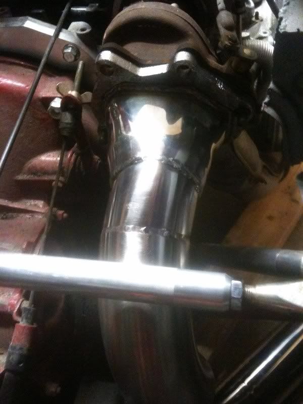

Exhaust fabrication. Ordered cheap wrx down pipe. Holes didnt line up on the turbo, had to "elongate" them. Chopped it up and added a 3" elbow.

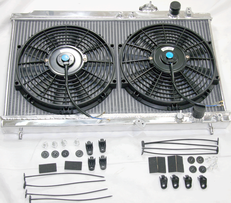

Was curious as to which radiator your going with.
I am wrestling between a custom and a scirocco
Thought?
VR
vw1303 November 17th 2010 17:40
http://i7.photobucket.com/albums/y25...1.jpg~original
http://i7.photobucket.com/albums/y25...1.gif~original

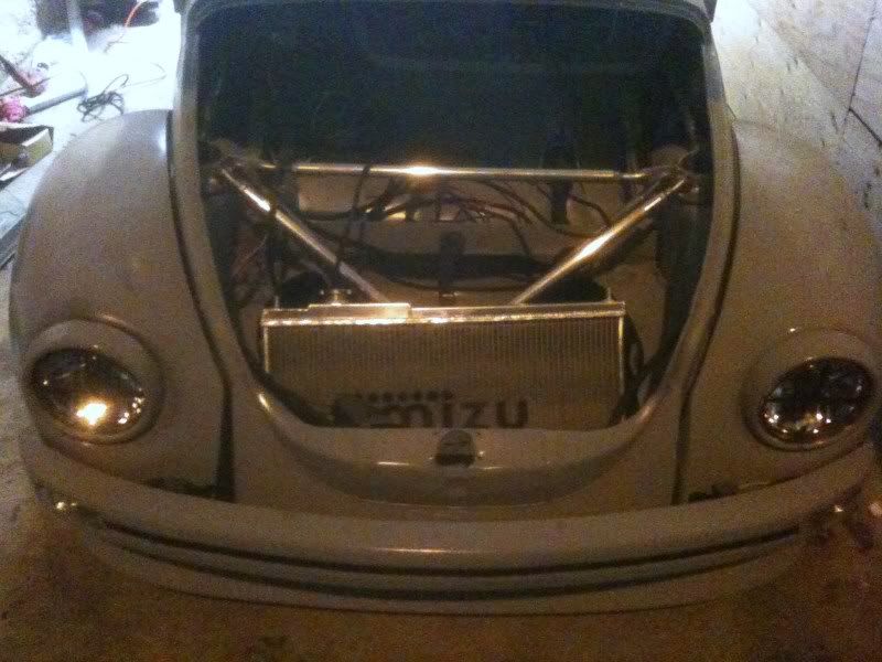

I'm using this one. Designed for a civic. But comes with two fans and should fit nicely. Dimensions are 26" wide by 17" high. And has the inlet and outlets on the same side which is a benefit for me as Im running both of my coolant tubes on the passenger side of the car.
Took delivery of my radiator. Felt weird putting it in:eek: But it fit perfectly.

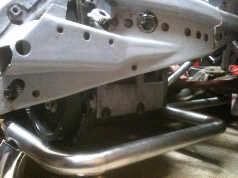

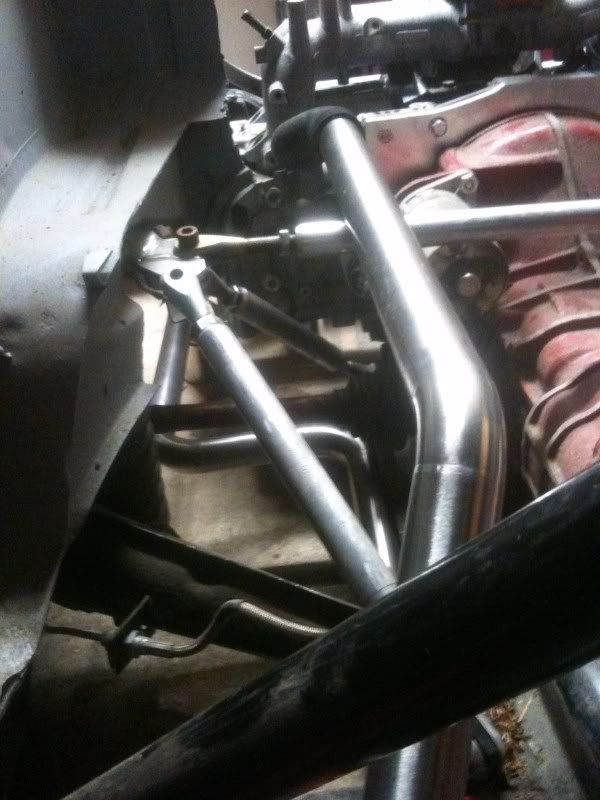

Coolant pipes now made of stainless.

More work on the downpipe.
My magic mushroom intake.:lmao:Decided to continue with the HKS theme.
http://i7.photobucket.com/albums/y25...6.jpg~original
http://i7.photobucket.com/albums/y25...8.jpg~original
Flanges welded onto intercooler for BOV.

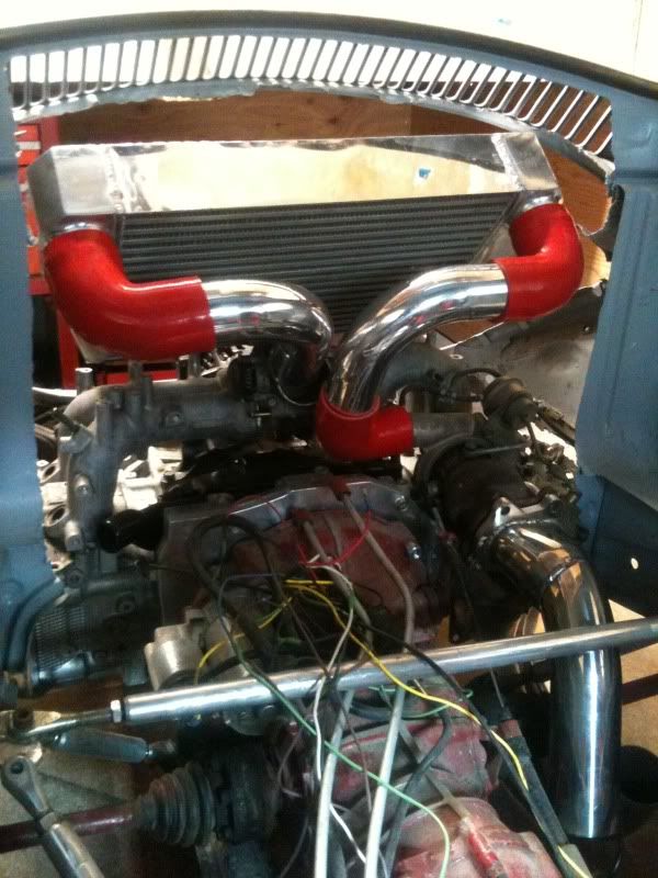

More coolant pipe fabrication.

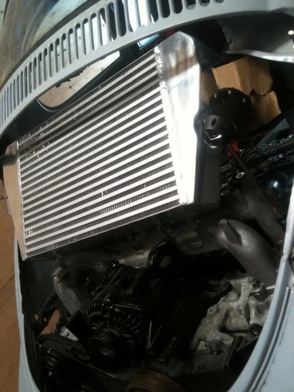

Revised my charge piping. Fits perfect now.:)
My mount for the intercooler. I drilled and tapped the alternator bracket for a couple of M8 bolts. Still need to work on supporting the other side as well.

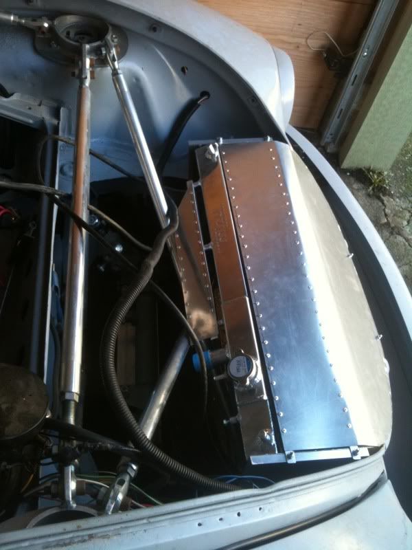

Finished my radiator mount and shroud.

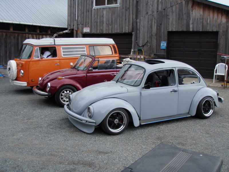

And old picture I dug up. My dad's cabrio and friends bus.
http://i7.photobucket.com/albums/y25...7.jpg~original

It doesn't look like you have a rad shroud after the radiator? I would highly suggest this as it is often overlooked. Shrouding and ensuring adequately flow AFTER the rad is almost more important than getting air to the rad. Temps under there will get VERY high. On my conversion I made the shroud out of steel and it is almost air tight, and it gets quite hot in there just from heat radiation. I'll be making one out of fibreglass this winter to help that.
Just my $0.02, keep it up!

Eatoniashoprat : What does your ducting look like after the rad fans?
