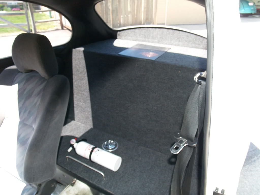

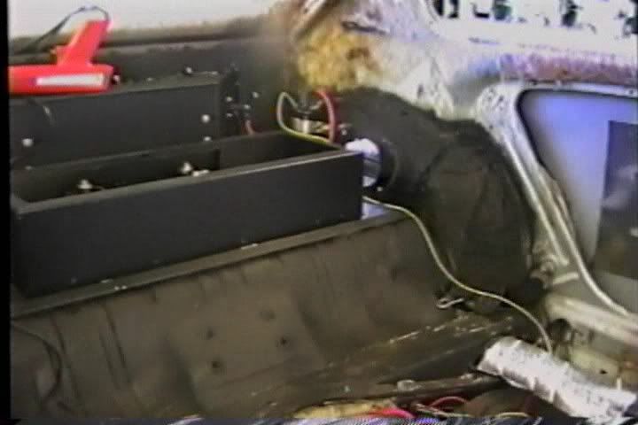

Oil Cooler Mount
I used the package tray. I made a box that houses the fan. It is open on the bottom and the fan takes cold air from the wheelwells and blows it past the cooler and down through a hole in the floor of the package tray. This is a terrable picture but it's all I have.
