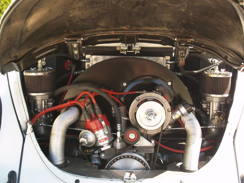

I recessed my firewall and made my own. Recessing the firewall gave me room and prevented crowding the airflow to the fan.
http://i51.photobucket.com/albums/f3...4.jpg~original
