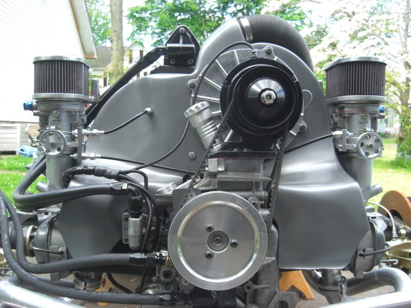

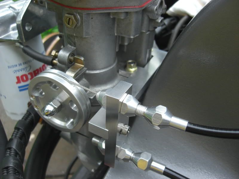

I've been working on a linkage setup for some time. I have a type 4 with an original OPP shroud and found the hex bar setup to clumsy and kinda ugly. I don't want to bore you with details and such, so here are some pictures of my solution.
http://i46.photobucket.com/albums/f1...9.jpg~original
http://i46.photobucket.com/albums/f1...6.jpg~original
Here's a clip of the intial startup and the linkage in action. I'm using a Megajolt/EDIS setup.
http://www.youtube.com/watch?v=XHiaY4YjHwU
enjoy
pete

Are you making any or was this a one off?
Is it a cable all the way to the pedal or is there some interface between the cables?

Pablo, I'm currently looking at getting parts made, will see how that goes.
As for the cable, yes it goes all the way to the pedal. I made a transition of sorts, that adapts the original accelerator tube to the new cable...works pretty good :) I also use 2 different type of cables. One type for the accelerator and another type between the carbs.
