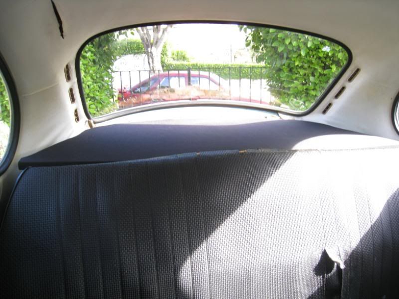

This is how i got the 2 years ago in manchester,
http://i498.photobucket.com/albums/r...8.jpg~original
http://i498.photobucket.com/albums/r...7.jpg~original
http://i498.photobucket.com/albums/r...6.jpg~original
http://i498.photobucket.com/albums/r...2.jpg~original

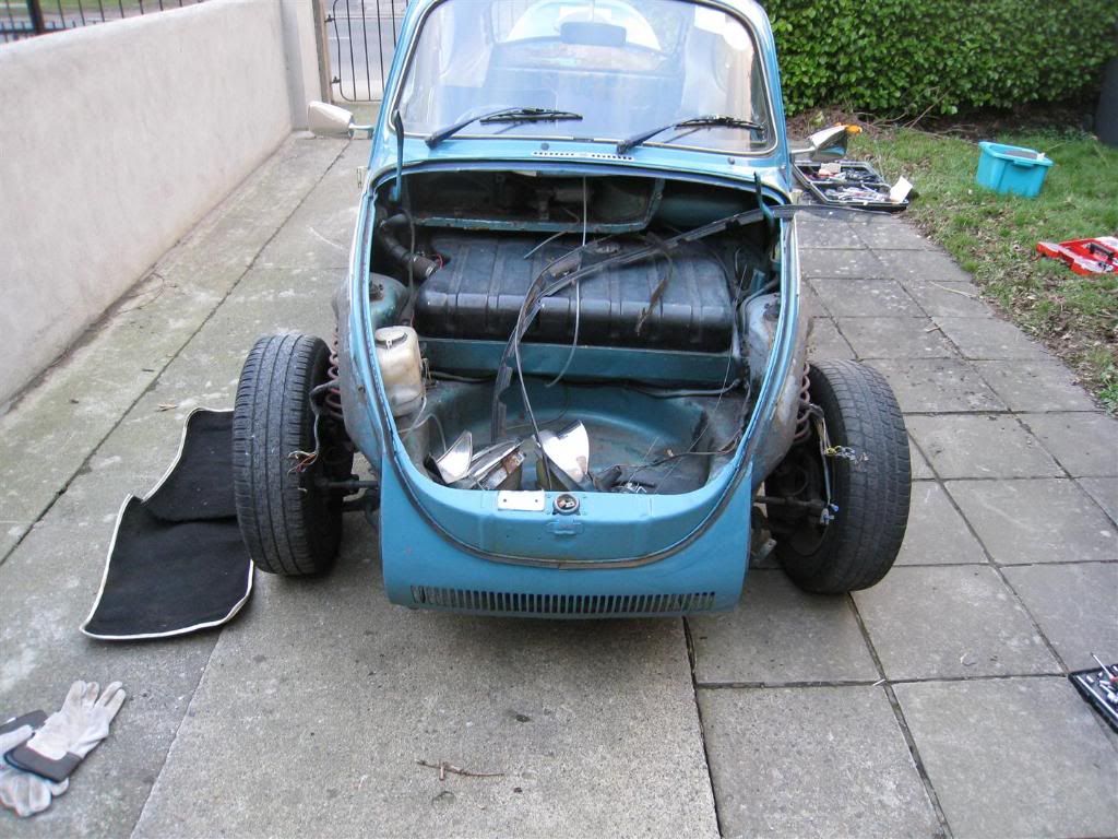

this is where i am at now , fenders off interior out glass out

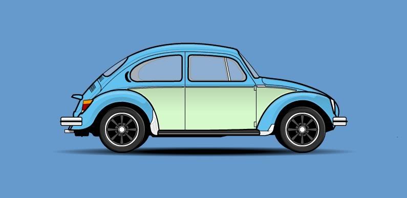

next up im looking at going from this
http://i498.photobucket.com/albums/r...e.jpg~original
to this
http://i498.photobucket.com/albums/r...0.jpg~original
