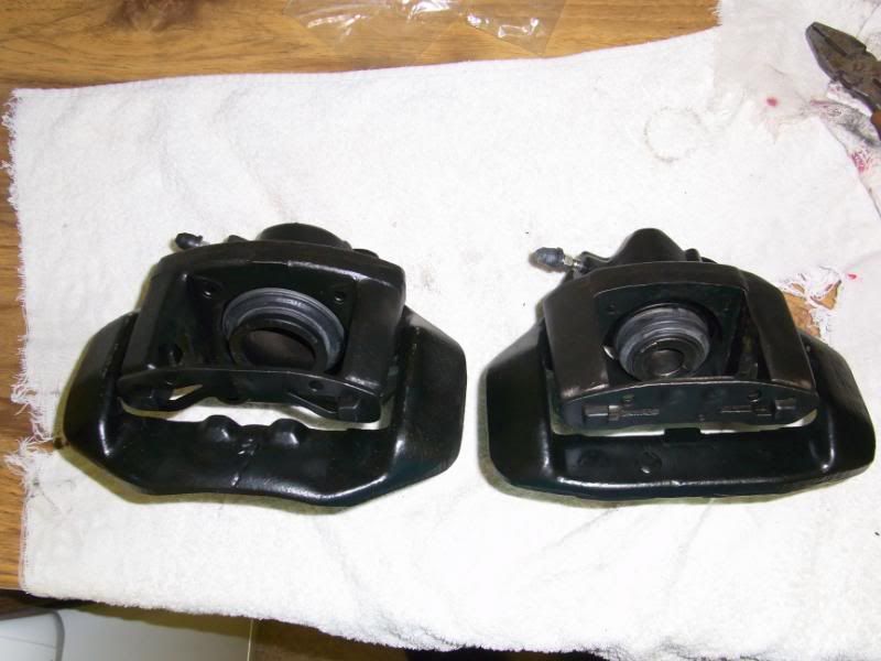

Taking you from this
http://i61.photobucket.com/albums/h6...9.jpg~original
To this
http://i61.photobucket.com/albums/h6...8.jpg~original
My cylinders were honed and the pistons cleaned and oiled. Bodies were stripped and painted in Smoothrite and the bleed and feed cleared out before starting the assembly. (thanks Dad!)

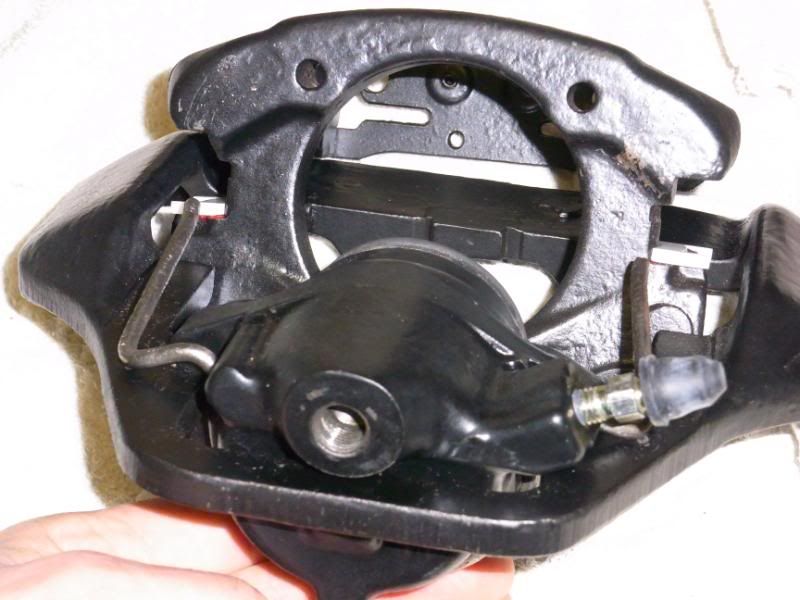

Learn here from me, its easier to assemble the pots and carriers together before putting the pistons in, but make sure that the second part of the calliper goes on last. Easy on the fronts because they are separate. On the rears assemble this bit last as shown below.

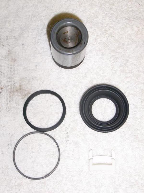

You'll need a caliper rebuild kit (rear kit shown), some brake fluid and optionally rubber grease

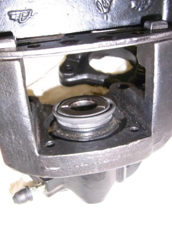

Fit the pots into the carriers, they are a friction fit. Best method is get them started and then knock the assembly on some old carpet on the floor with your weight on the pot to drive it home. Remember that the bleed nipple in every instance goes on the curved side (top) of the carrier.
A later picture but it shows how it is oriented (rear pictured).

Get your pistons and cylinders cleaned with some degreaser or the like and make sure that the seal groove is well cleaned too.
http://i61.photobucket.com/albums/h6...5.jpg~original
Fit the dust seal to the piston
http://i61.photobucket.com/albums/h6...7.jpg~original

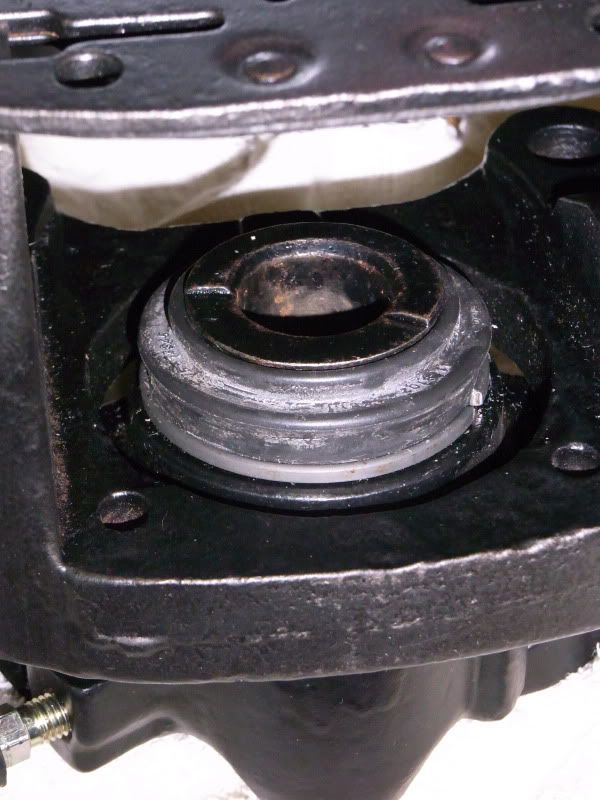

Then pull the dust seal over the body of the pot...
http://i61.photobucket.com/albums/h6...4.jpg~original

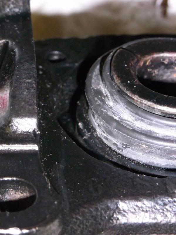

And fit the split ring to retain
That is job done for the fronts, the rears are slightly different, check the photo at the beginning of the thread. For these you have to install slides and assemble both parts together.

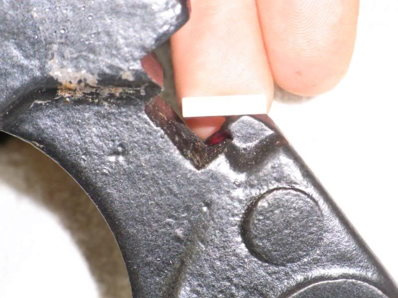

Pop some rubber grease onto the back of the slides to help them stay put, this part is tricky
http://i61.photobucket.com/albums/h6...6.jpg~original
Get the calliper upside down as shown, the springs need to line up, you'll see where if you're doing them

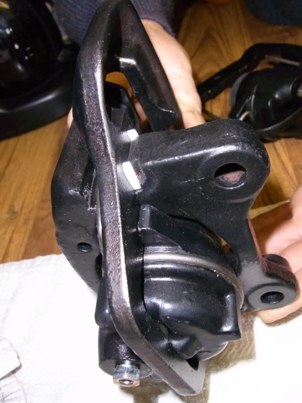

Taxing at best, but you need to push down on the other part of the calliper while pushing it over the slides and keeping them in place. You'll end up with them looking like this
http://i61.photobucket.com/albums/h6...3.jpg~original
Job done.

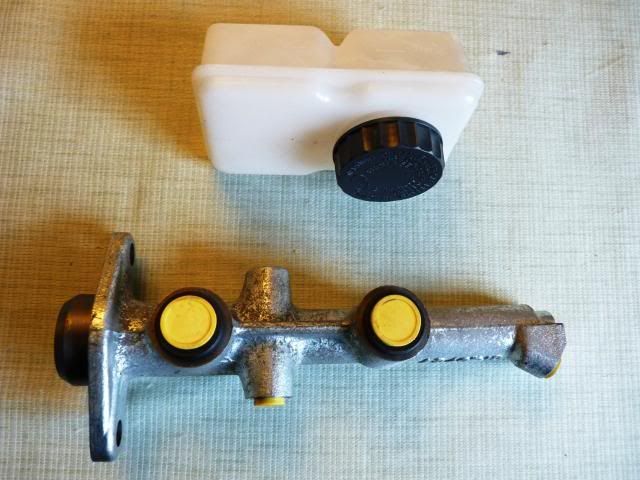

As an aside from this, I've found the perfect MC to be using with single pot calipers too.
It's a Volvo 240 stepped cylinder with 22.22mm and 15.87mm outlets which should give some nice balance. Thanks to EvilC for advice and mutual rambling about brakes and the like.
http://i61.photobucket.com/albums/h6...0.jpg~original
No need for a balance box, new pedals or expensive modifications, maybe relocation of holes to mount and a 4 way (M10x1) brake union too.
http://www.nfauto.co.uk/images/july2...4.jpg~original
Result for all those wanting brake upgrades on the cheap
