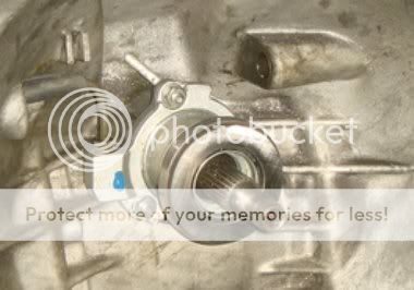

I'm work in the same solution to type 1 trans. The problem with the stage 2 or 3 clutch more stronger and blow the hydraulic throwout bearings. :shocked:
if you have stage one try opel vectra 16V.
i'm work to develop one with external truck cylinder to stage 2 ore more,
My room have one collection... :D
Luis

Pablo October 20th 2010 02:32
Hello Luis,
That's one to look for, thanks. I will have the stage 1 clutch.
Any chance you can post that picture of it fitted that is on your laptop?
Paul

al_kaholik October 20th 2010 13:36
hmmm... Presumably we have the same TOB here Luis?...
Pic from SteveC on Aussie Veedubbers
http://www.clubvw.org.au/images/G50_hc.1.jpg~original
http://www.clubvw.org.au/images/G50_hc.jpg~original

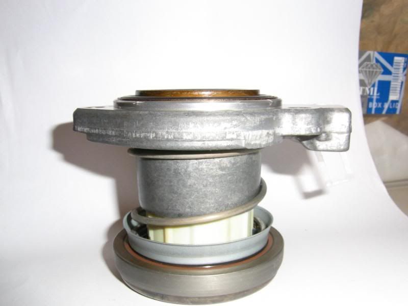

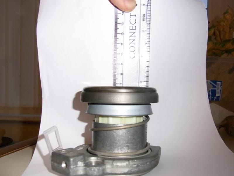

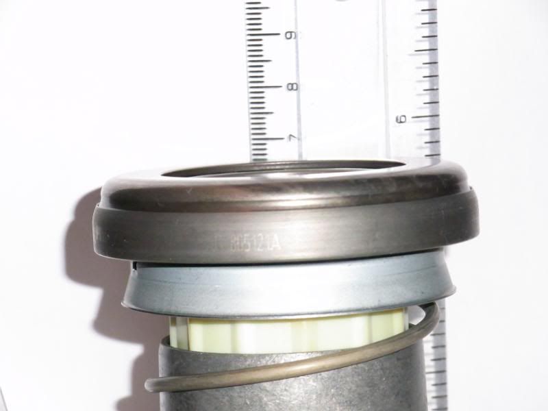

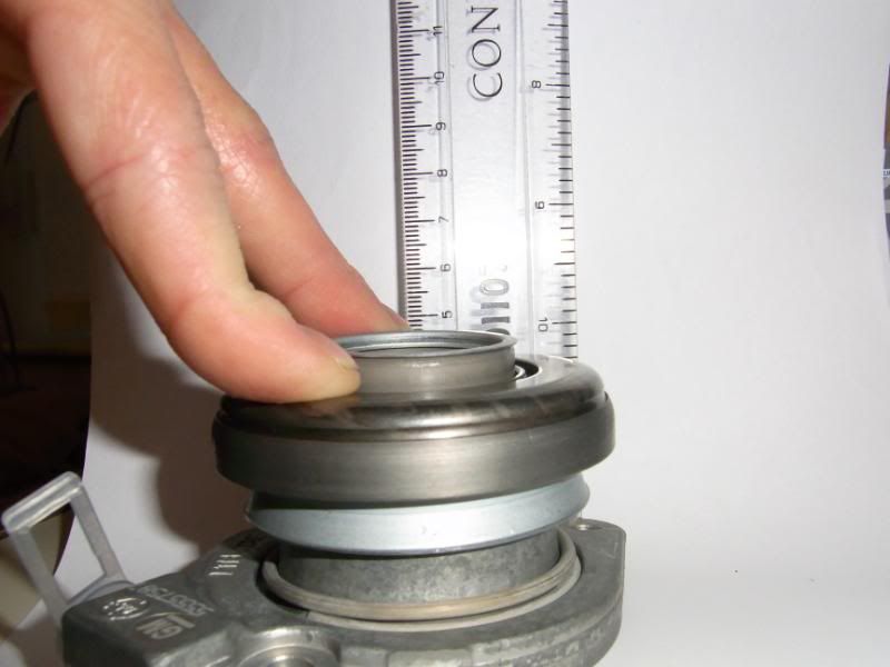

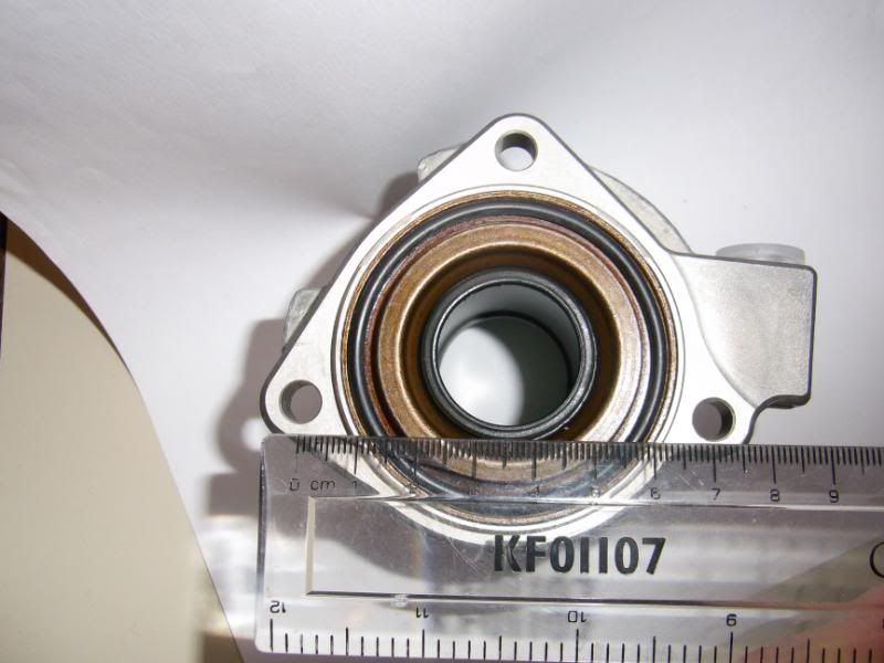

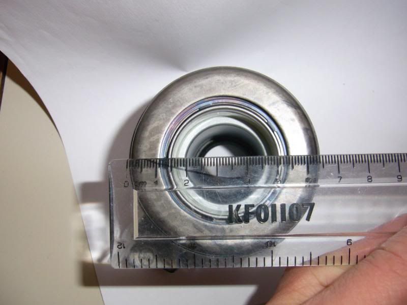

And pics of what I've just had delivered. Best pics of the dimensions that I can get as I don't have the micrometer down with me. Note that this one doesn't have a sleeve around it, because its a cheap most likely, but if you are willing to pay the money you can get them with the bellows.

Pablo October 20th 2010 15:25
Nice pix Al, do you know what thats off?
Do the mounting holes match the VW sleeve holes?
I guess you will tell more once you have had a look at a gearbox
Pablo October 20th 2010 15:31
After studying you pix a little closer I see GM on there, whats the number stamped on it?
al_kaholik October 20th 2010 15:48
Its a GM 55557587 from Saabs with the 1.9 TiD plus assorted other GMs
It matches up with a 16mm master cylinder which opens plenty of options for different mounting types.
As for bolt patterns and the bearing face, I'm nowhere near either so can't look right now. If anyone has a release bearing handy and the sleeve from the gearbox that'd be great. Otherwise I'll have to get the old man to have a look tomorrow :)
Presumably it'll bolt up if Luis' is the same but its whether it'll mate up to the clutch face
