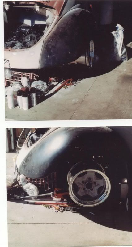

After all that was finished, the next step was to order the wheels. I was torn between Cal and Germanlook at the time, and I ordered a set of Centerline wheels in a Chevy bolt pattern and had my rotors accordingly drilled. Tracking down a machinist and many problems from Centerline caused 2-3 months to idle by with no wheels.
Here are my Centerline wheels:
15x8 in back and 15x7 up front, these guys have a nice stepped lip. They remind me a bit of phone dials, but are also very different. Anyway, with 225's in back, the meaty tire looks deliciously fast. Not to mention that the wheels weigh about 14lbs a piece, they should be pretty nice on the track.
http://farm2.static.flickr.com/1202/...a2f772e023.jpg
http://farm2.static.flickr.com/1113/...87a84d9a50.jpg
Hi, your project looks very nice. Will the 8 inch tires fit within the rear fenders? Creative Car Craft sell three inch fiber glass fenders, that would set your rear centerline off real nice
On my project, which I just can't seem to do anything with. I am using 10 cookies cutters with the three inch fiber glass fenders. It also give it a cool look. Those tires will throw debree on your fender and do damage to your paint job.
Bugged October 24th 2010 00:16
Yeah, I will get wider fenders for the back... probably the creative car craft ones. In the front I may get some fender work done. Just to stretch em out a lil bit. I have some odd offsets going on the wheels, and have added considerable track in the rear and the front. I know there are adverse effects of doing this but no turning back now. It should be really stable accelerating. But I see plenty of bugs with a lot of track added, especially the ones sporting the flared kafer cup fenders.

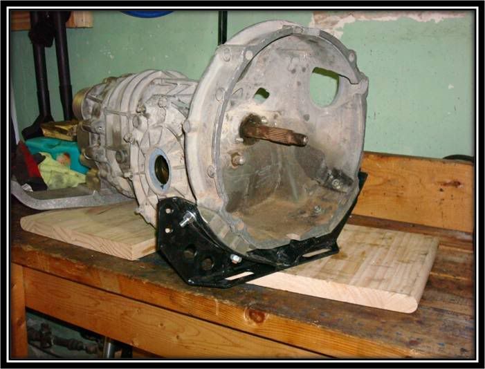

Hey, another question here for the future. when mating the transmission mounts and the 911 trans, can I grind out a groove in the transmission mounts so the bolt bumps on the bell housing have clearance? Or do I have to grind down the bumps themselves... Sorry if the description is vague.
Basically can you grind on a transmission mount? How about a urethane one?
Bug@5speed(US) November 1st 2010 22:07
Bugged,
Cheap plug, but here is one approach.. http://www.germanlook.net/forums/sho...6894#post76894
The thread does have some good info to help you plan your approach..
VR
Bugged November 2nd 2010 01:54
Alex,
I have been through that thread several times now. I actually already have your rear mount, although according to that thread it appears I have the 914 style mount whilst I have a 71 901/911 transmission.
Bugged November 2nd 2010 02:09
Slide 40 Bug@5-Speed Rear Gearbox Support (Cont)
The last order of business is to attach everything to the bell housing with the manufactured supplied bolts/nuts or grade-8 or better hardware[/QUOTE]
here it looks like you may have grinded down the trans mounts...?:confused:
Or is this before you grinded down the bellhousing?
