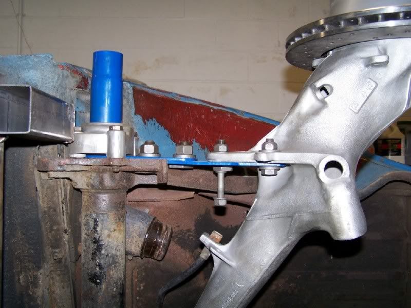

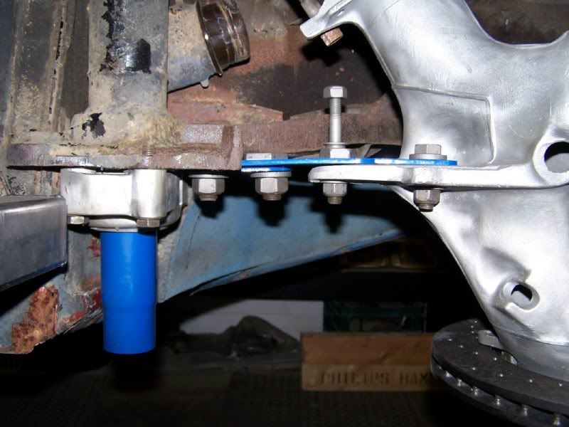

wrenchnride247 January 18th 2011 23:49
I set one side with both shims/washers on the OUTSIDE, and the other with both on INSIDE (frame horn side). Looking at the pix you can see the springplate flexing bad on the side with them on the outside. The other is not flexing as much.

Steve C February 2nd 2011 00:01
4 Attachment(s)
Thanks for everyones thoughts.
I have been thinking about ways to overcome this issue.
I fitted alloy arms for a number of reasons, I've moved my motor forward 100 mm, using alloy arms I have to use longer axles, this cuts down the CV angle.
Marco on Shoptalk has come up with some adjustable inner pivot bushes to overcome excessive camber on lowered cars, I think I could use this idea but instead of gaining camber I could use them to move the pivot point for more toe in.
The other idea was to take a bit of the alloy arm on the inside pivot and shorten the urethane bush as well, this would turn the pivots inwards giving more toe in.
Its hard to photograph the problem, you can get an idea hopefully. I have attached 2 of Marcos photos from Shoptalk
