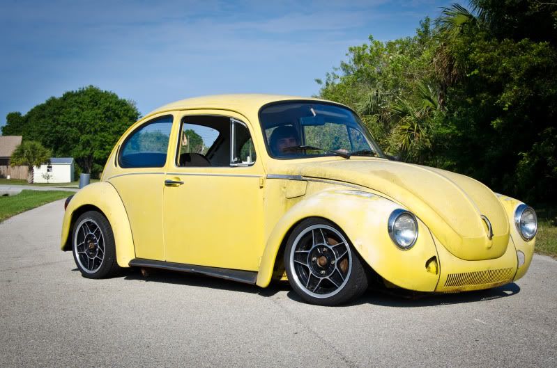

gsusmaniac June 26th 2013 20:24

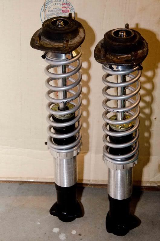

So I completely forgot that I made this. I was doing so much research in the process of building the suspension for this car.
Yes we made the trailing arms and custom coils for the front. The arms turned out great. I did what dd-ardvark recommended and used a jig to make sure I did lose any of the alignments of the trailing arms.
I will say that I love how it worked out. I got all the drop I needed with no camber change. I love it. But if I were to make another set, I would got for a 3" drop instead of 4"
Here is how it came out for those that want to know.
ERIK
http://i47.photobucket.com/albums/f1...4.jpg~original
Front Coils-
http://i47.photobucket.com/albums/f1...5.jpg~original

It was a learning experience for sure... can't wait to build some for my car!
Humble June 26th 2013 23:39
Great work on the suspension, have you had it on a proper alignment rack to get numbers? Also, nice set of wheels you got there, just got a set myself :thumbup:
petevw June 27th 2013 01:33
Which coilovers/sleeves did you use to slip over those stock struts?
