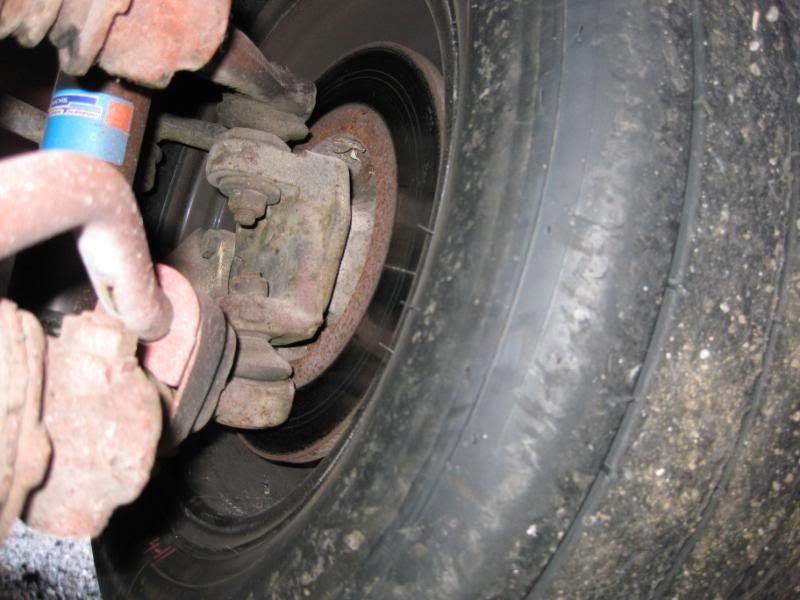

Here's a 'Ghia on 13's:

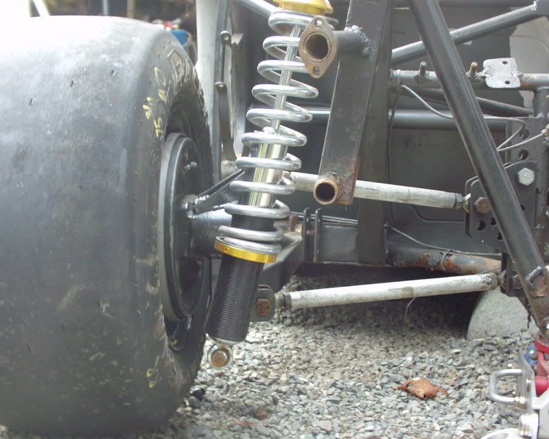

My old 'mini super' or 'pro-four' Type III rear drums and 13x10's:
