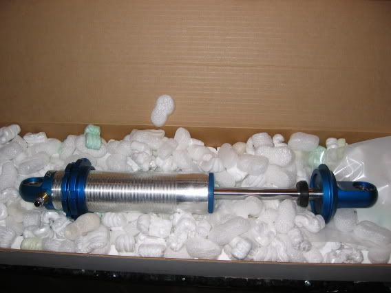

What lenght coilovers to put rear? I'd like to put fox coilovers to the rear, because i will have also mendeola front suspension. Rear is handled by 944 aluarms, kerscher 18mm swaybar etc.
Mendeola is offering fox coilovers that are 11.5"-15" collapsed/extended. Fox has almost similar coilovers at their webpage, 11.3"-16.4".
http://www.foxracingshox.com/product...374&ref=filter
What is stock IRS shock length, for reference point? I plan to lower the rear maximum 30-50mm, it is enough for me.

Measure it when you have the whole lot assembled. the droop is contained by the ledge on the torsion bar casting and the compression will be controlled by the bump stop. Alternatively, ask Spax for the rear damper specs for their PSX or RSX kit for the 1303 re the open/closed length

Not sure it will help but here are stock vw 1302/3 SACHS rear damper lengths :
collapsed : 11"
extended : 16,1"

Ok, i have to measure as EvilC said. Looks like 944 aluarms may need shorter shock, maybe.
Wally April 6th 2012 07:04
I had measured before, but lost the info somehow... Shortening the bump stops is mandatory if you want any wheel travel when lowered.
Fully inbound they are very short because of that I remember.

Maybe its not needed long racers edge bolts like paragon products offers? Shorter might work with 944 aluarms. I noticed that QA1 promastar has less room at the bottom, thin part of the bottom at fox 2.0 is longer.
http://utvguide.net/images/Fox-20-Pi...1.jpg~original
http://i63.photobucket.com/albums/h1...1.jpg~original
Above bolt can handle 600kg load, i tested it with solidworks and using 12.9 material.
