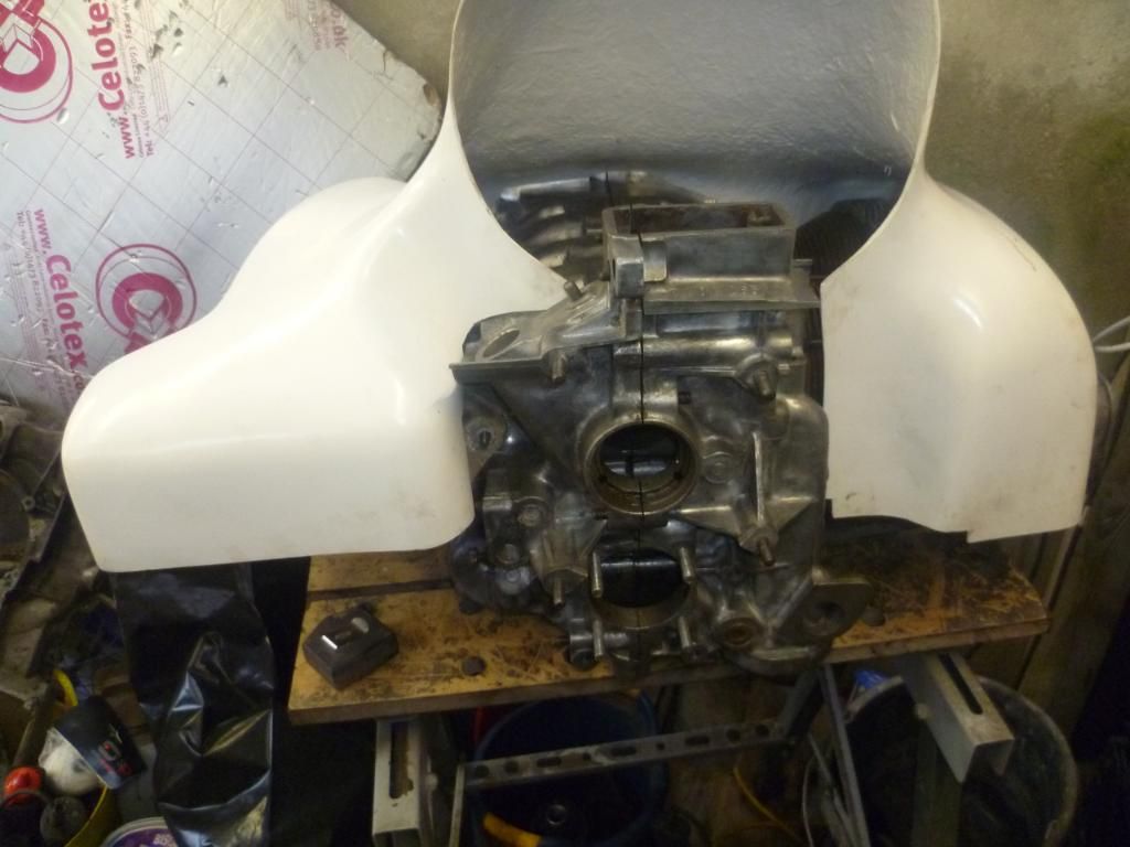

what make is this, it covers the stock oil cooler, and what's the cooling like.
http://i601.photobucket.com/albums/t...8.jpg~original
http://i601.photobucket.com/albums/t...9.jpg~original
Joel February 28th 2012 21:25
Cooling on that wouldn't be terribly effective, there is no internal vanes to direct the airflow around and air doesn't like making 180degree turns on it's own so very little air flow would go through the oil cooler.
