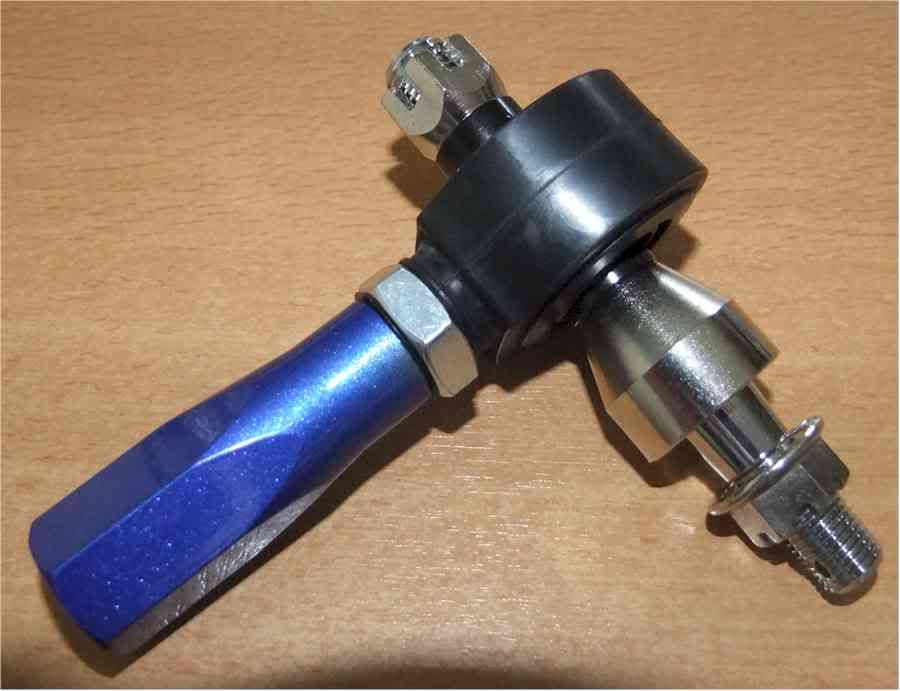

My son has a Nissan R31 drift car, its very low. He bought some tie rod ends to correct bump steer, the concept maybe interesting VW guys.
They are adjustable at the steering knuckle for height to correct bump steer.
