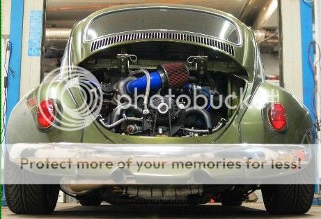

Hi sandeep,
Welcome back!
i have 3,88 ring and pinion and 0,83 4 gear with 245 40 17 and 300 more hp.
Normally i go to 220 and stop. http://i712.photobucket.com/albums/w...ps130db71c.jpg
When it running at 230km/h something get serious...
Another big problem is the front T1 suspension, when i put my 944T brakes 320mm to really work it misaligned.
CB drop more camber and caster (205 45 17)
I wondered their your 245 on the front!
Luis
