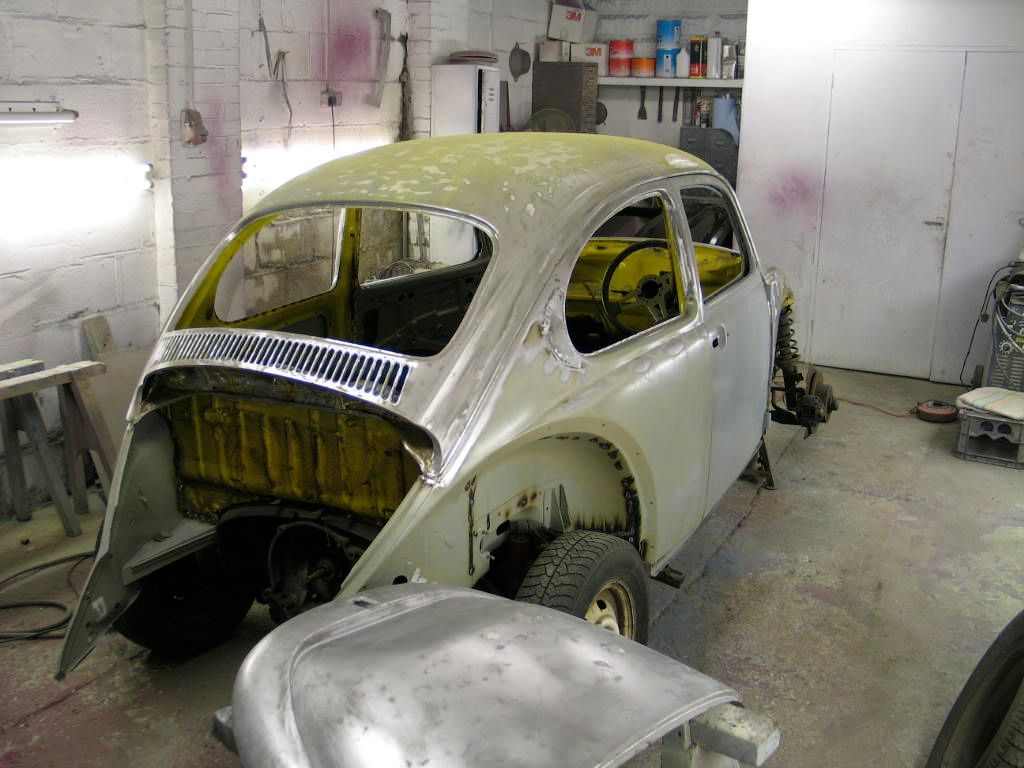

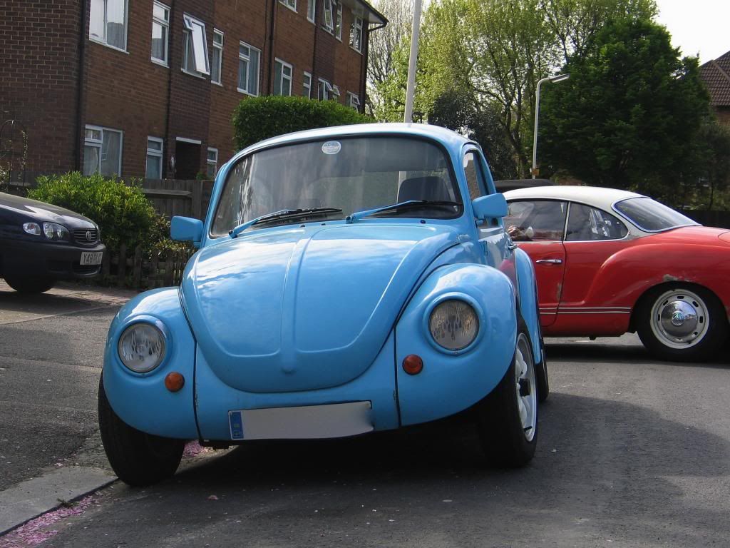

Anyway here is a pic of my car the day I first saw it prior to buying it.[IMG]http://i1185.photobucket.com/albums/...9.jpg~original~original[/IMG]
A pretty straight never badly crunched 1303

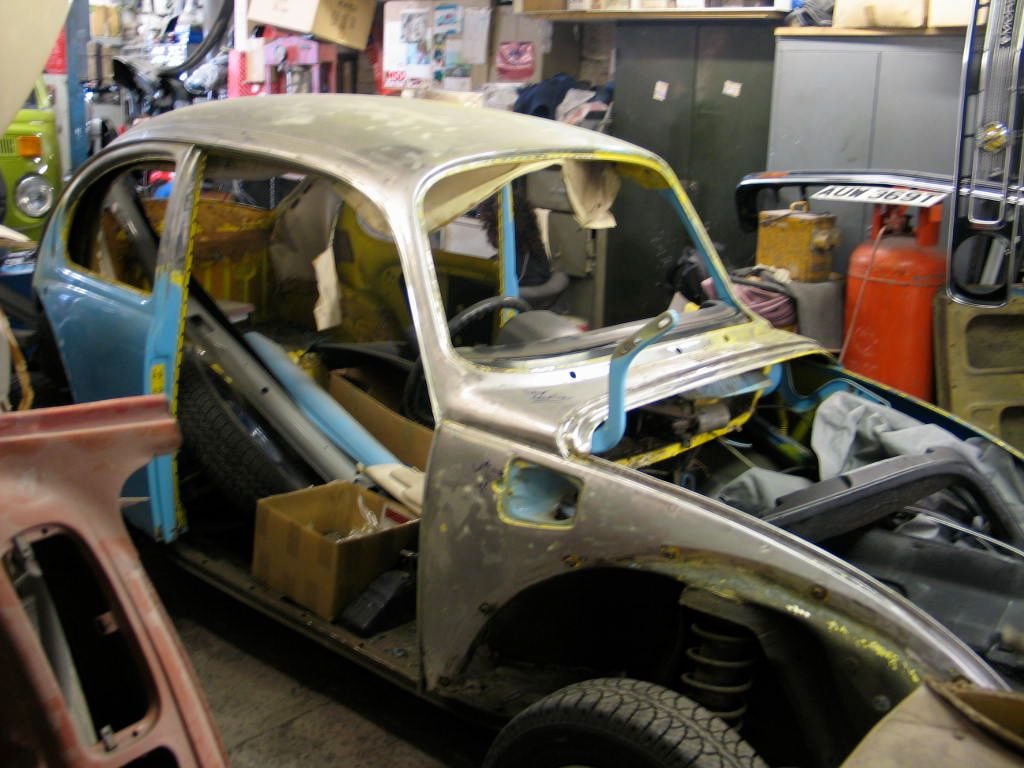

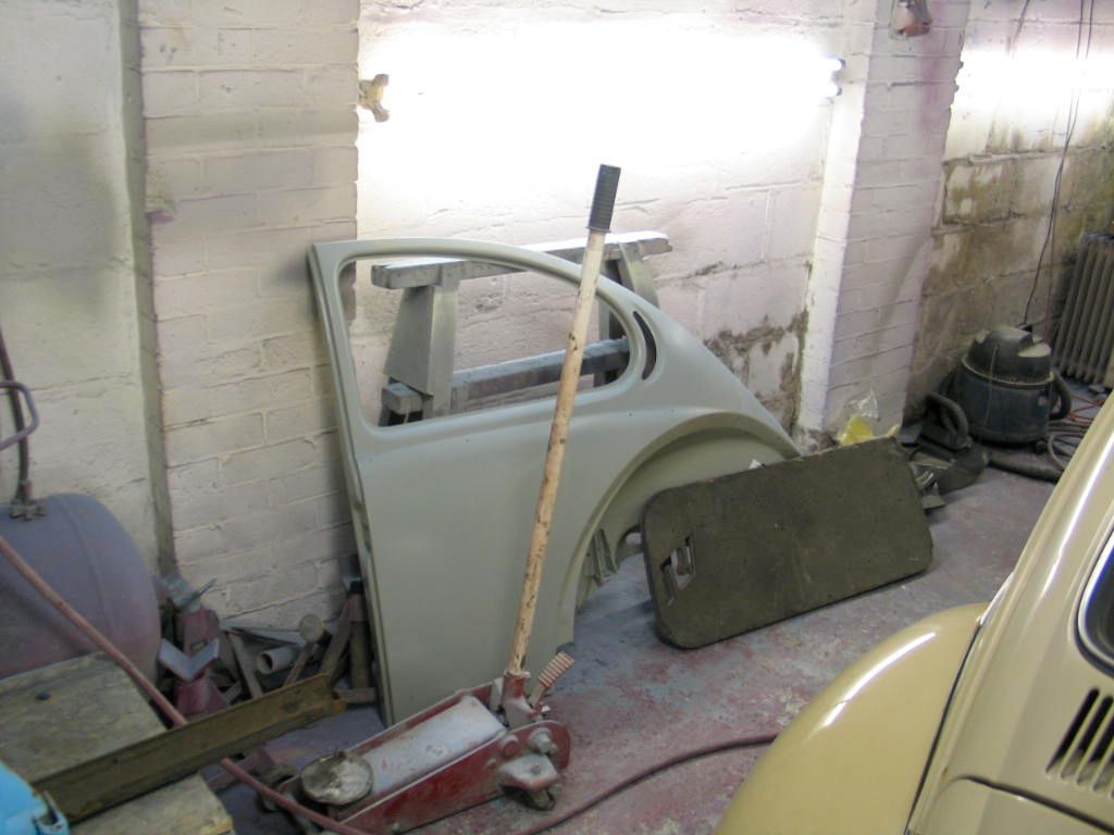

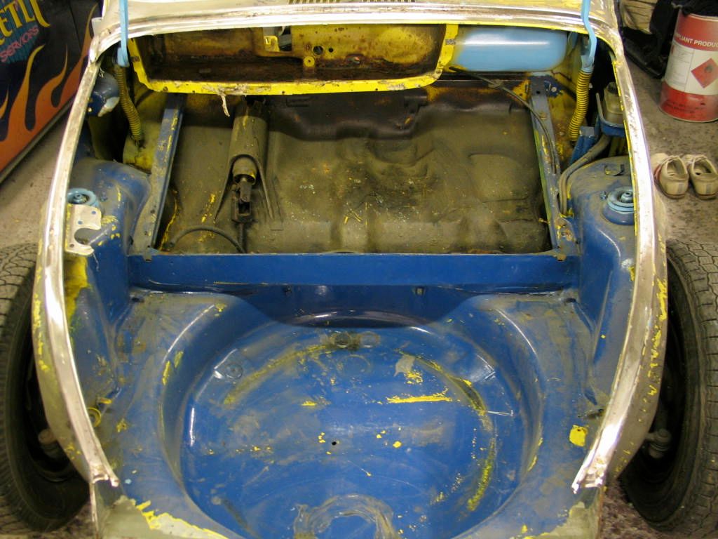

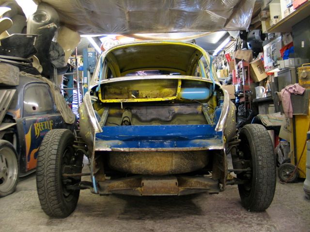

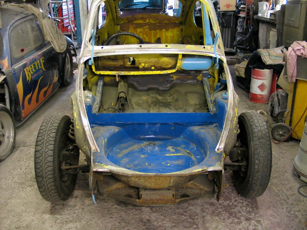

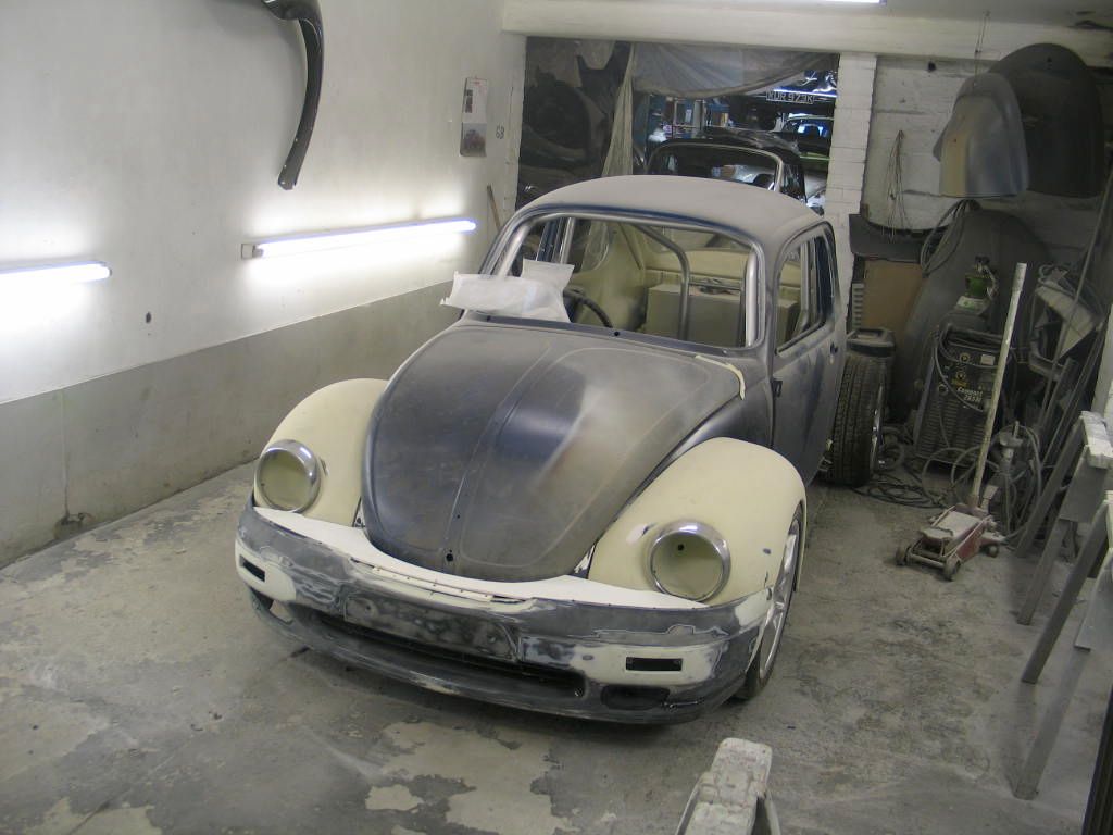

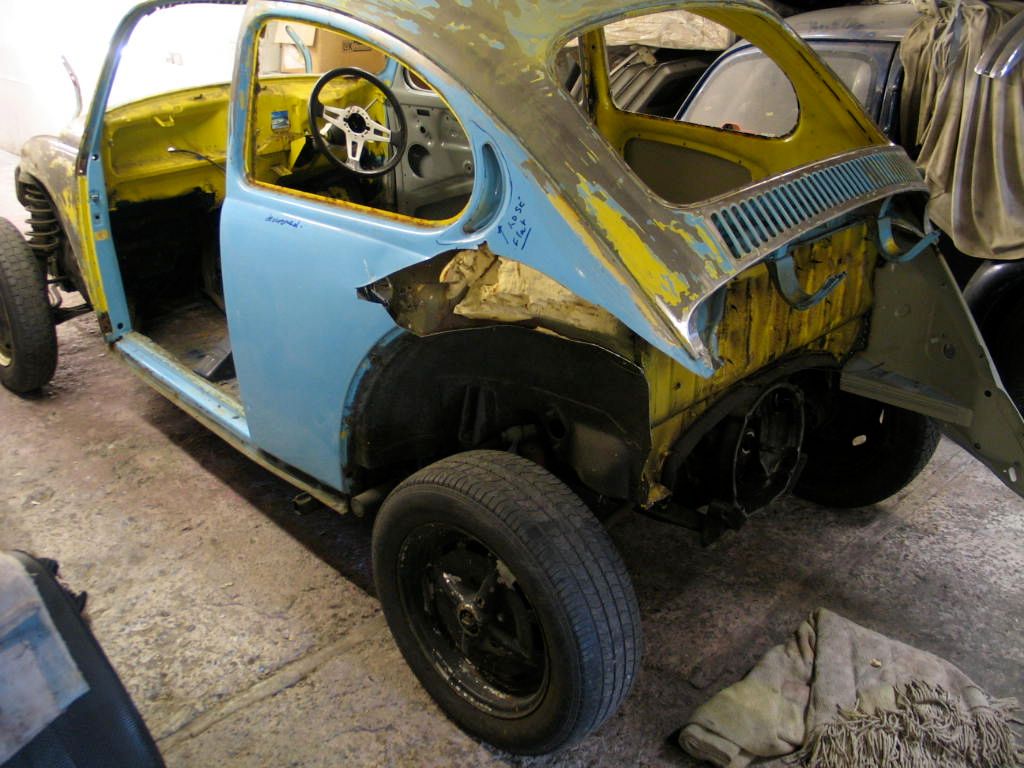

the stripdown at Terrys Beetle Services in Ealing London [IMG]http://i1185.photobucket.com/albums/...f.jpg~original~original[/IMG]

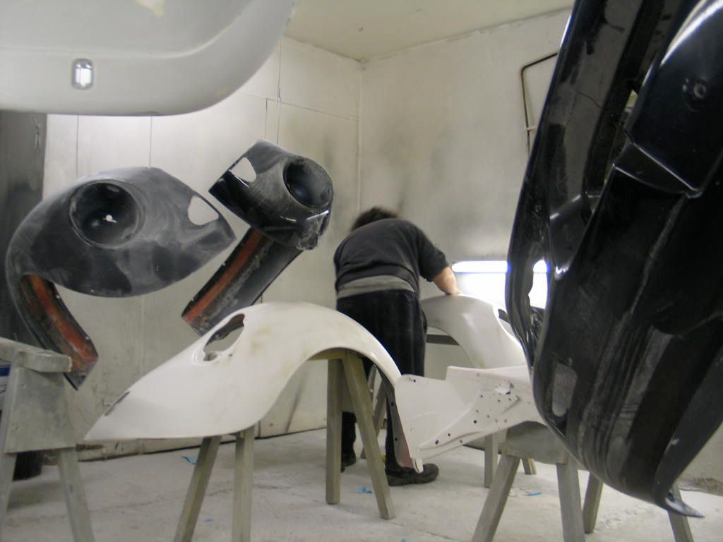

Luke at Terrys has done all the bodywork and paint.
The car hiding on the right is a well known car here in the UK called Moody I think it's currently up for sale.

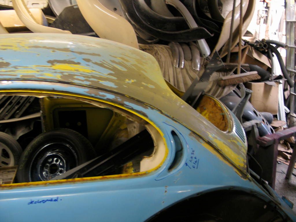

[IMG]http://i1185.photobucket.com/albums/...6.jpg~original~original[/IMG]
[IMG]http://i1185.photobucket.com/albums/...4.jpg~original~original[/IMG][IMG]http://i1185.photobucket.com/albums/...1.jpg~original~original[/IMG]
http://i1185.photobucket.com/albums/...8.jpg~original~original[/IMG]
[IMG]http://i1185.photobucket.com/albums/...e.jpg~original[/IMG[IMG]http://i1185.photobucket.com/albums/...0.jpg~original~original[/IMG]
These pics where taken in 2006

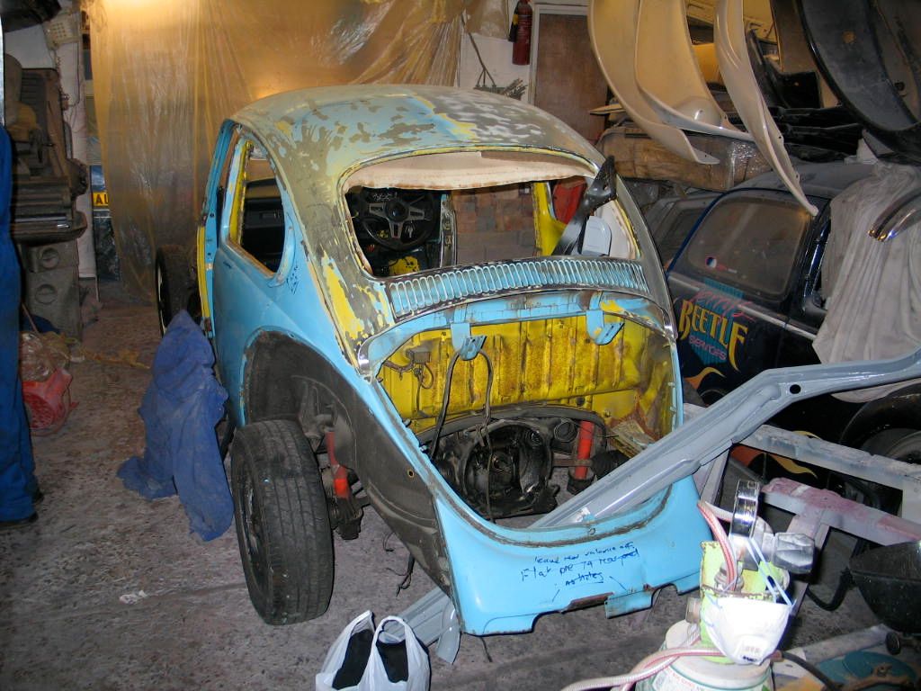

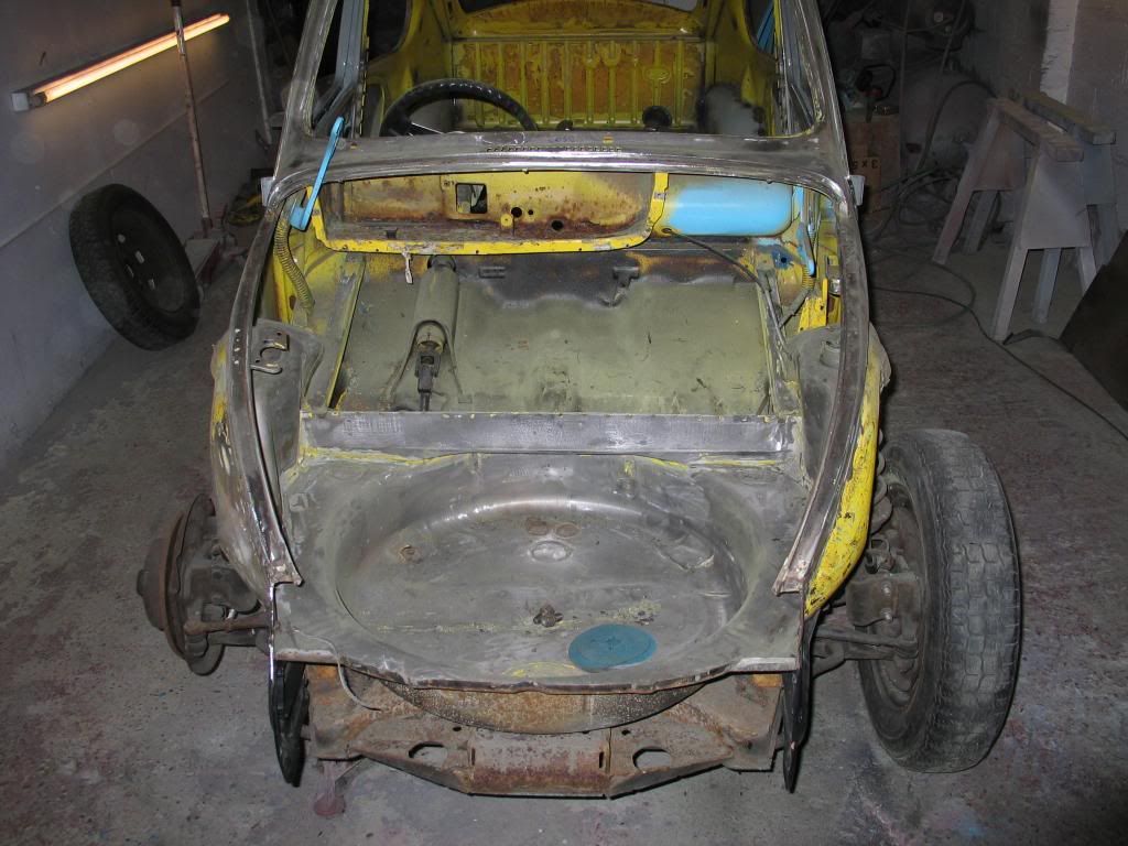

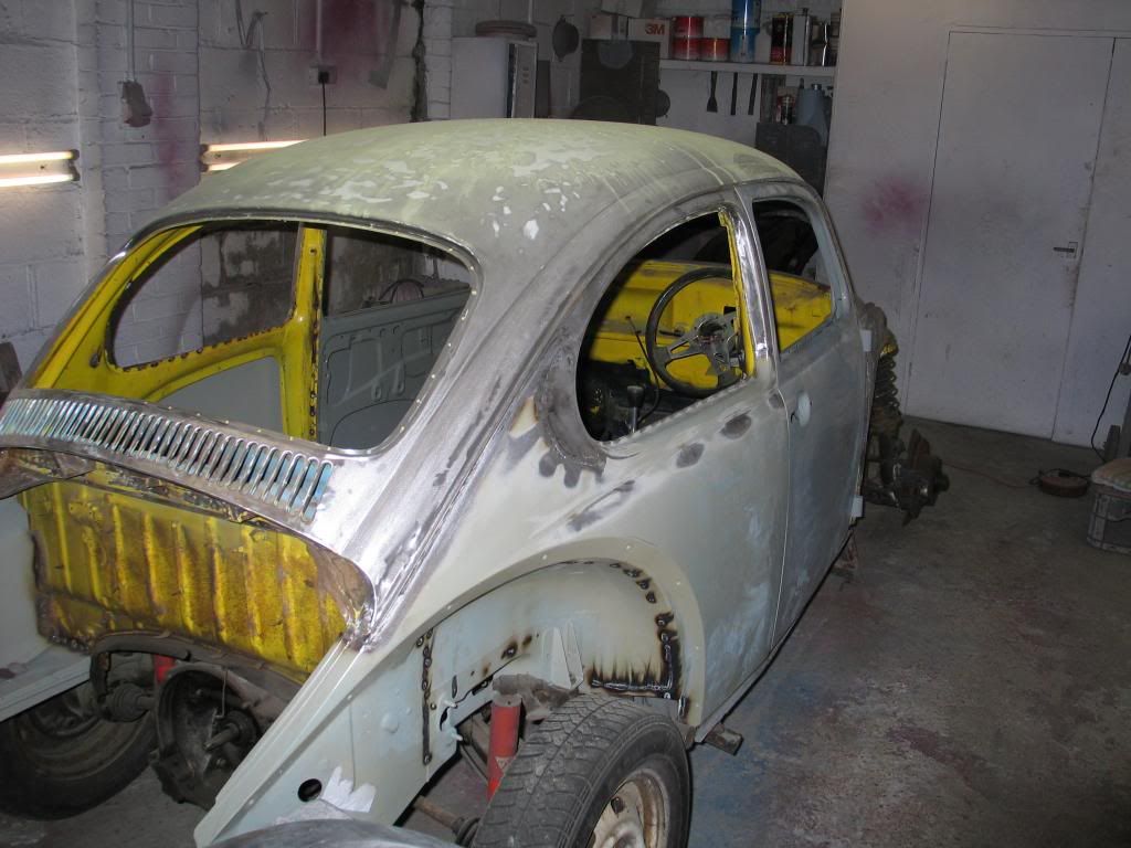

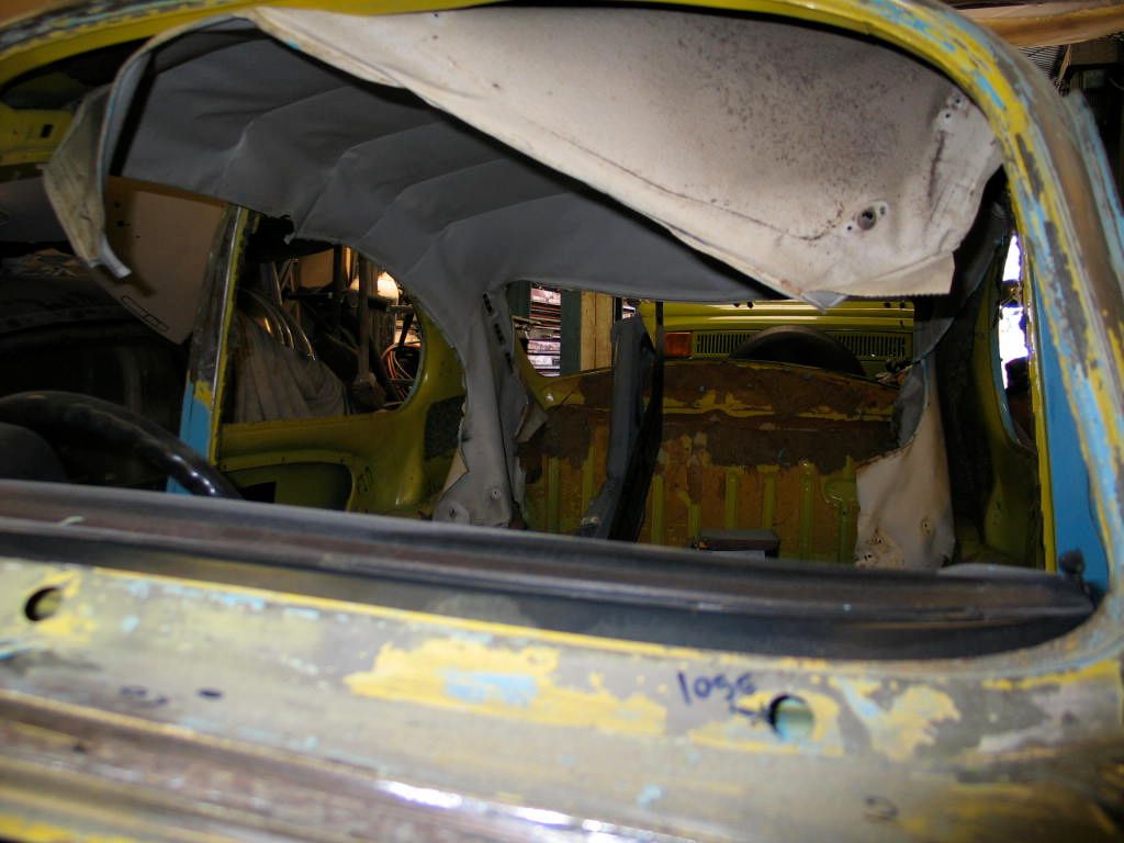

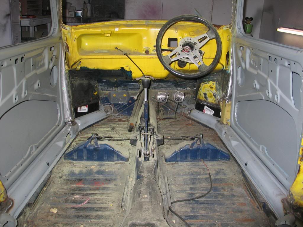

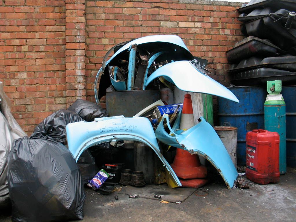

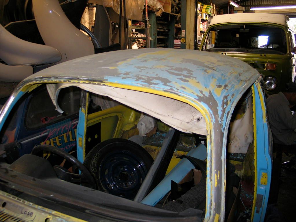

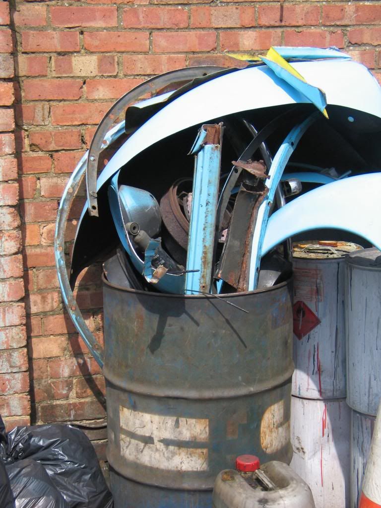

metal removal time[IMG]~original[/IMG]
[IMG] front removed
[IMG]http://i1185.photobucket.com/albums/...d.jpg~original~original[/IMG][IMG]http://i1185.photobucket.com/albums/...0.jpg~original~original[/IMG][IMG]http://i1185.photobucket.com/albums/...c.jpg~original~original[/IMG]
[IMG]http://i1185.photobucket.com/albums/...d.jpg~original[/IMGhttp://i1185.photobucket.com/albums/...2.jpg~original

NO_H2O March 22nd 2013 07:30
That is a large pile of scrap you took off it. Can't wait to see it go back together.

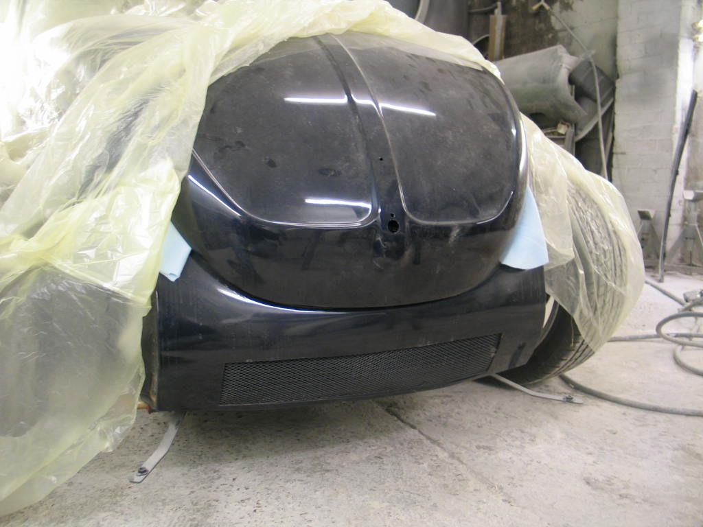

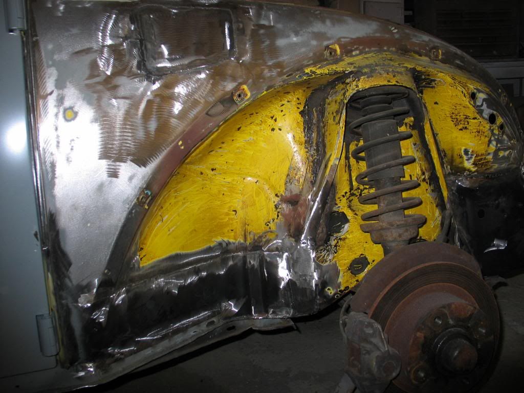

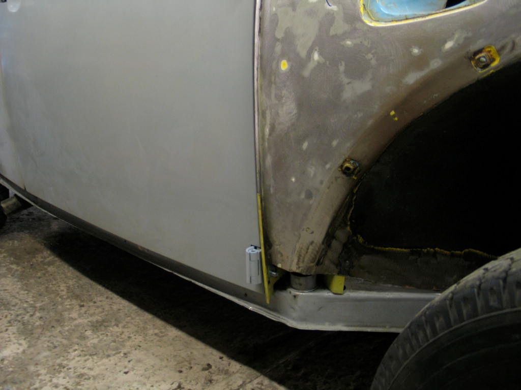

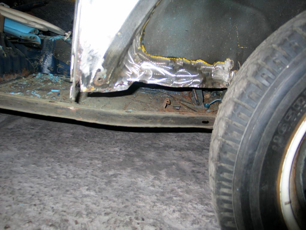

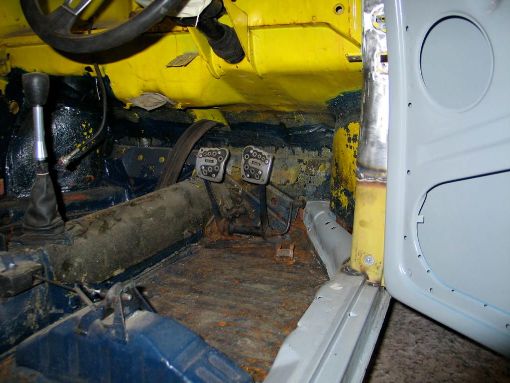

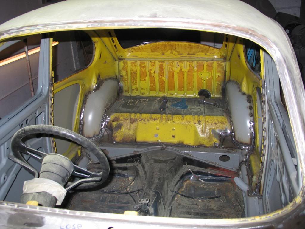

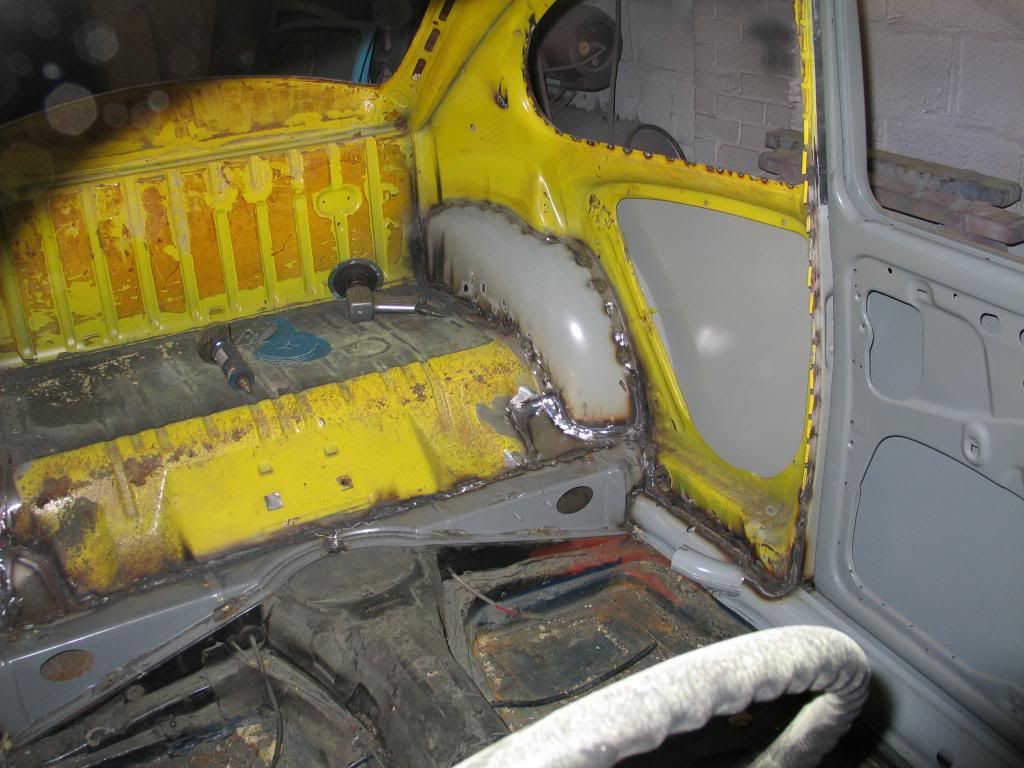

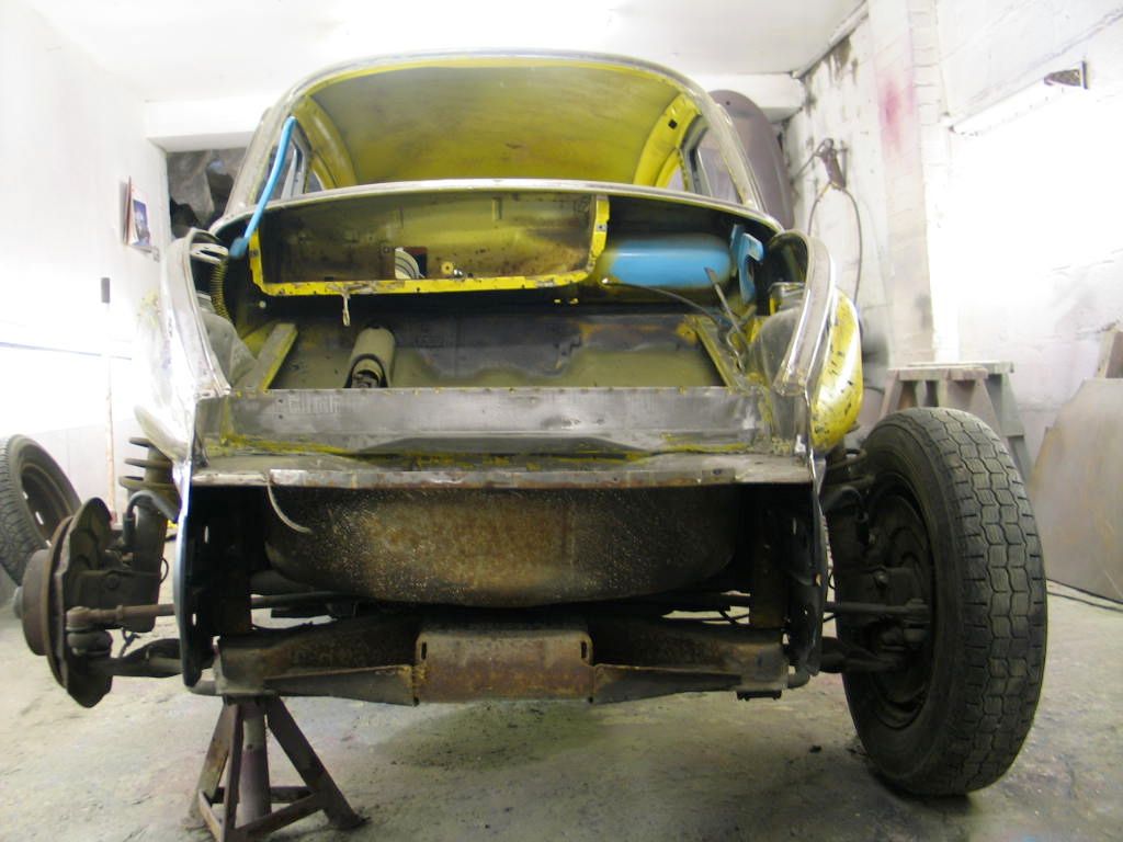

new door,heater channel and bottom post, i cant remember who makes these bottom posts but they are a very well made panel [IMG]http://i1185.photobucket.com/albums/...8.jpg~original~original[/IMG][IMG]http://i1185.photobucket.com/albums/...9.jpg~original~original[/IMG]more replacement panels gone in.I have paid someone to do all of this as unfortunately I dont' have the skills or expertise to do it myself.I feel a bit guilty having a kind of cheque book resto carried out but its taken years to get to where the car is now I would never of been able to carry out work like this without lots of experience so decided it was best left to someone who new why he was doing ( horses for courses and all that )[IMG]http://i1185.photobucket.com/albums/...d.jpg~original~original[/IMG][IMG]http://i1185.photobucket.com/albums/...6.jpg~original~original[/IMG][IMG]http://i1185.photobucket.com/albums/...0.jpg~original~original[/IMG]

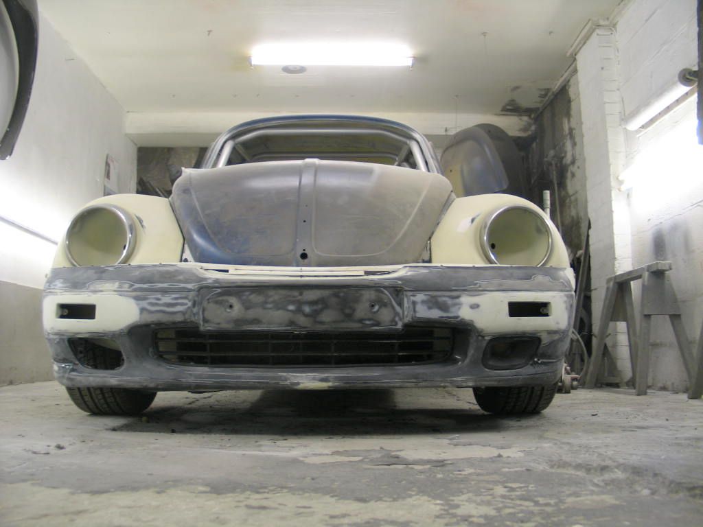

few more pics of the replacement panels[IMG]http://i1185.photobucket.com/albums/...f.jpg~original~original[/IMG]

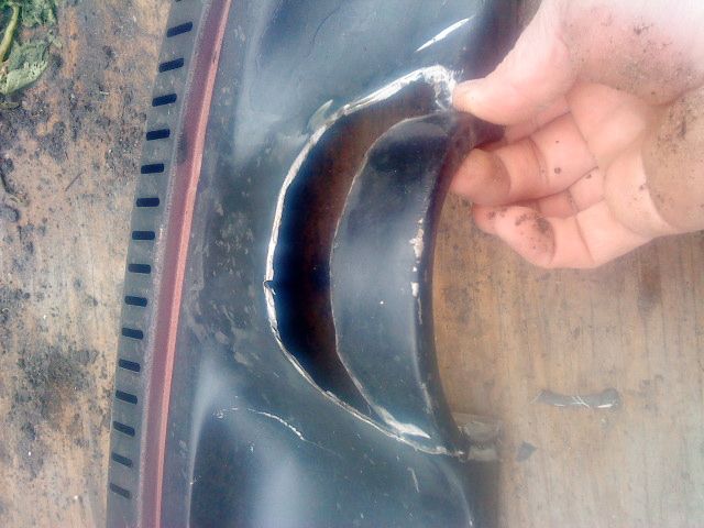

moon vents welded up I wanted to have this done to prevent moisture getting into the rear quarters as they seem to rot badly here and to give the car a cleaner look.I am hoping on creating some kind of ducting/vents under the floor pan to introduce some more air into the engine bay for extra coolinghttp://i1185.photobucket.com/albums/...5.jpg~original
[IMG]http://i1185.photobucket.com/albums/...9.jpg~original~original[/IMG]more paint removal and trim holes down the side of the car welded uphttp://i1185.photobucket.com/albums/...4.jpg~original

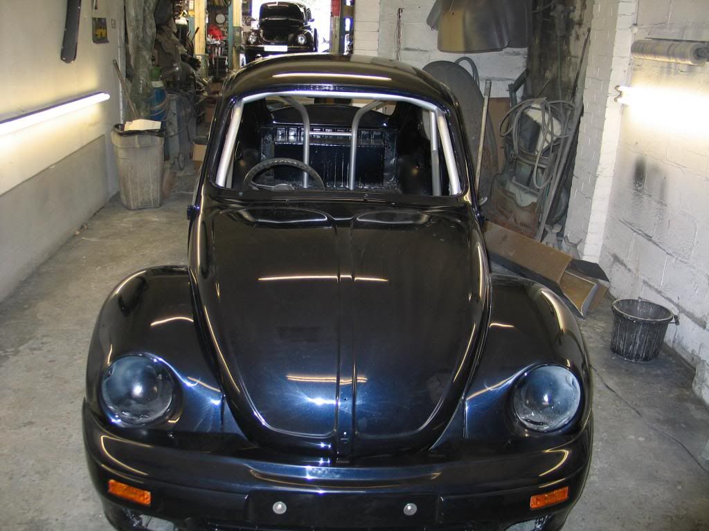

few more pics[IMG]http://i1185.photobucket.com/albums/...b.jpg~original~original[/IMG]
[IMG][IMG]http://i1185.photobucket.com/albums/...a.jpg~original~original[/IMG]

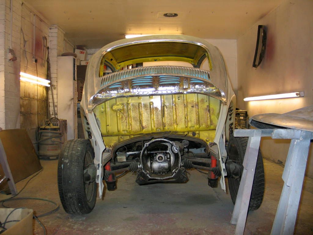

Prior to this pic the floor pan and shell where separated and the pan was painted in POR 15 before a final coat of a rubber type spray on protection.Then the first coat of paint was cooked onto the bodywork.

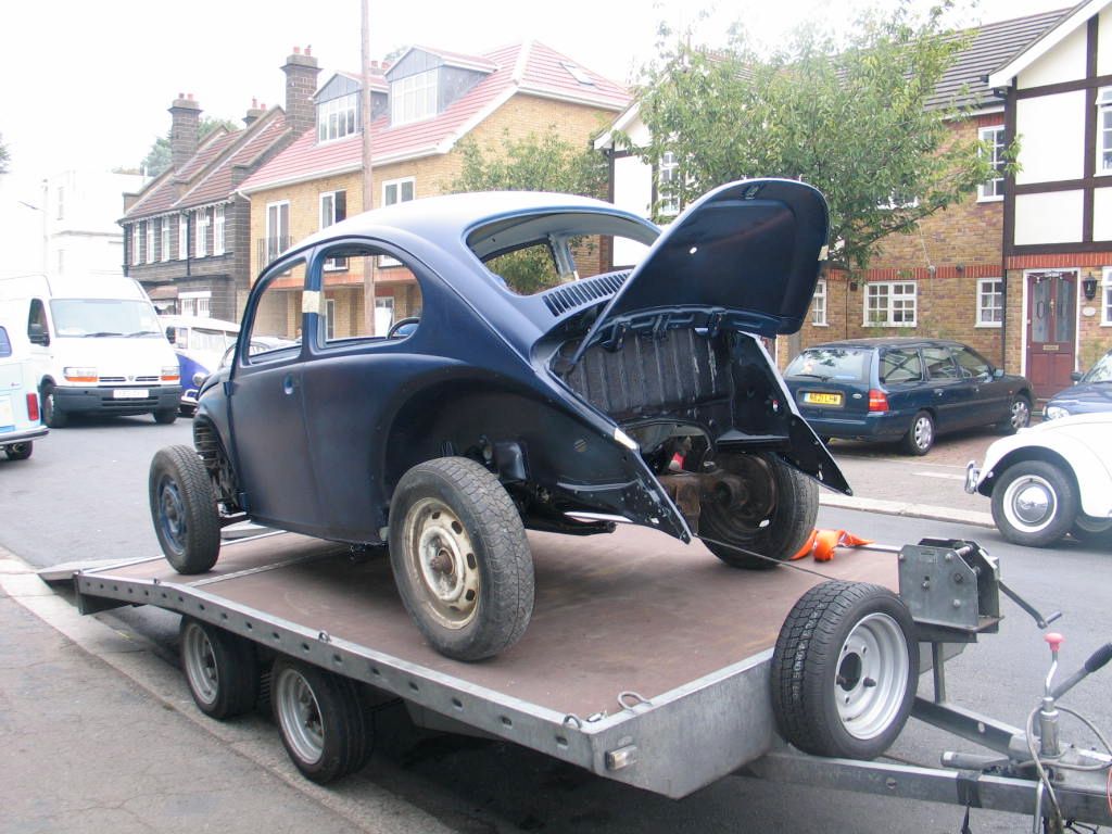

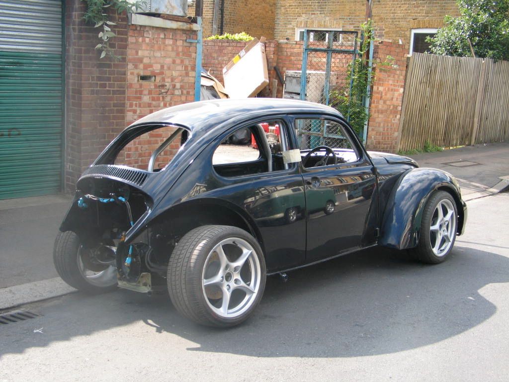

After this pic of the car on the trailer the car was taken to a so called Subaru Engine conversion specialist.I didn't have the skills or knowledge to do the installation myself.Unfourtunately they didn't have the skills or knowledge either :angry::angry::angry: this has been a nightmare and the less said about this the better.But lets just say I was not prepared to let them get away with it so I have come down on them like :bricks:
This has now resulted in the engine,gearbox,ecu and all the other **** they fitted being removed.

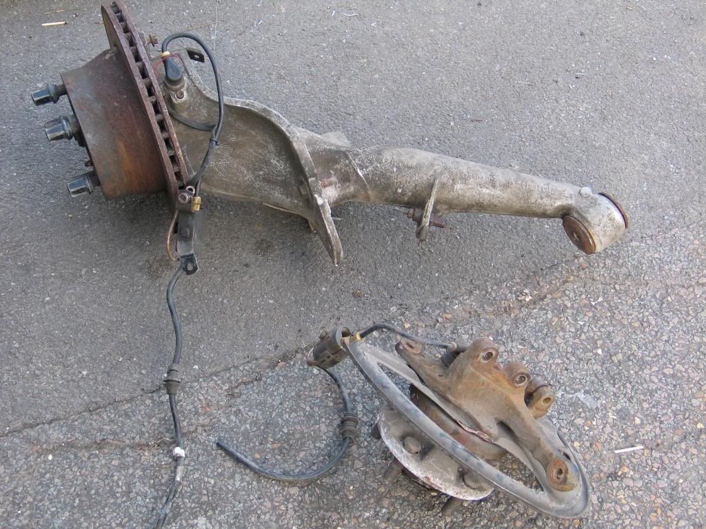

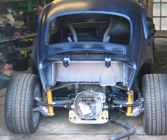

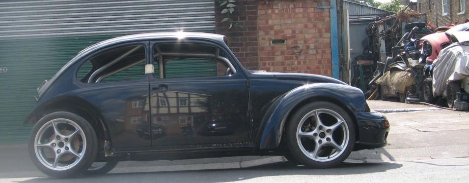

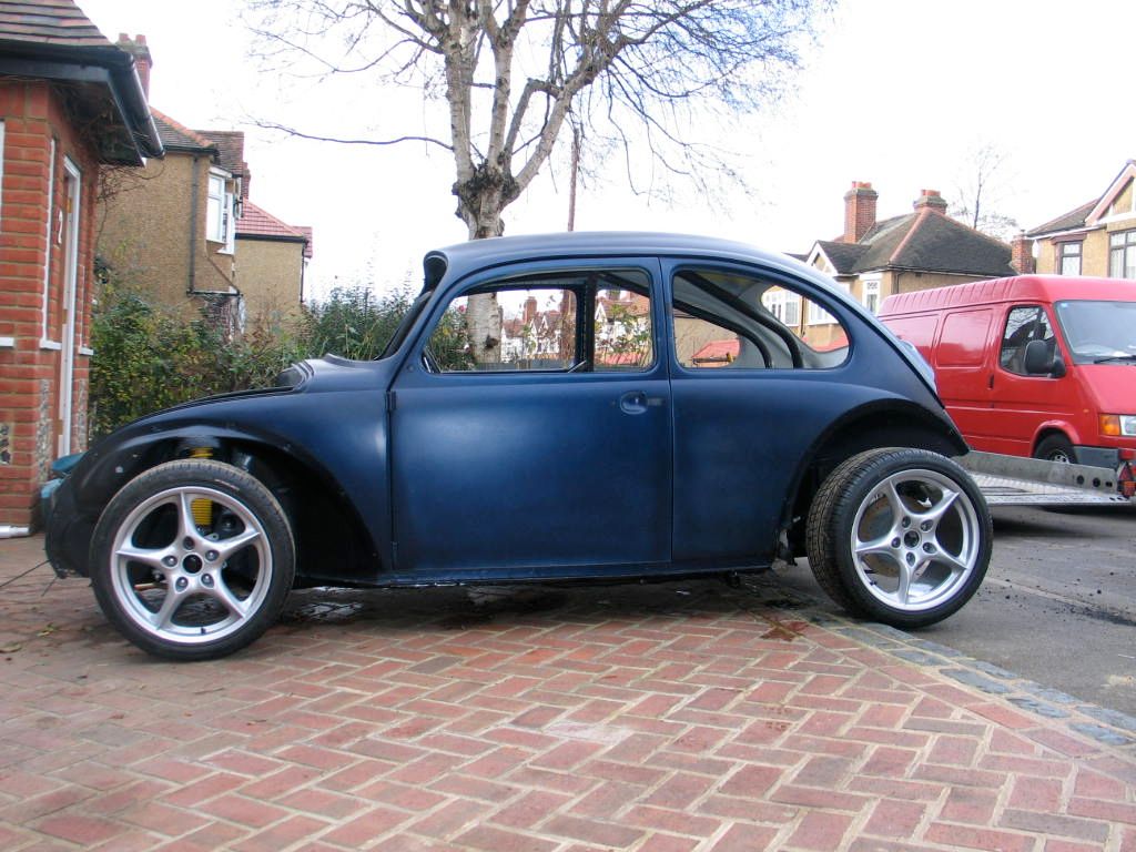

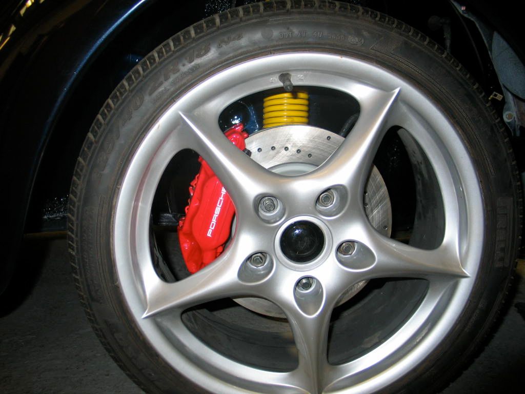

Paul and his team at type two detectives http://www.type2detectives.comas fitted the Porsche 944 s2 hubs,rear ali arms,four pot calipers, vented disks as well as the Kerscher front and rear anti roll bars and Kerscher front struts.Again these guys where great, Paul who owns the place is an honest bloke and I would highly recommend them.Paul told me that one of his guys was having a tough time with the car and really getting pissed off with it at one point but He sorted it so hats off to him so a massive TA V MUCH FELLA. these parts where cleaned and etailed prior to fitting

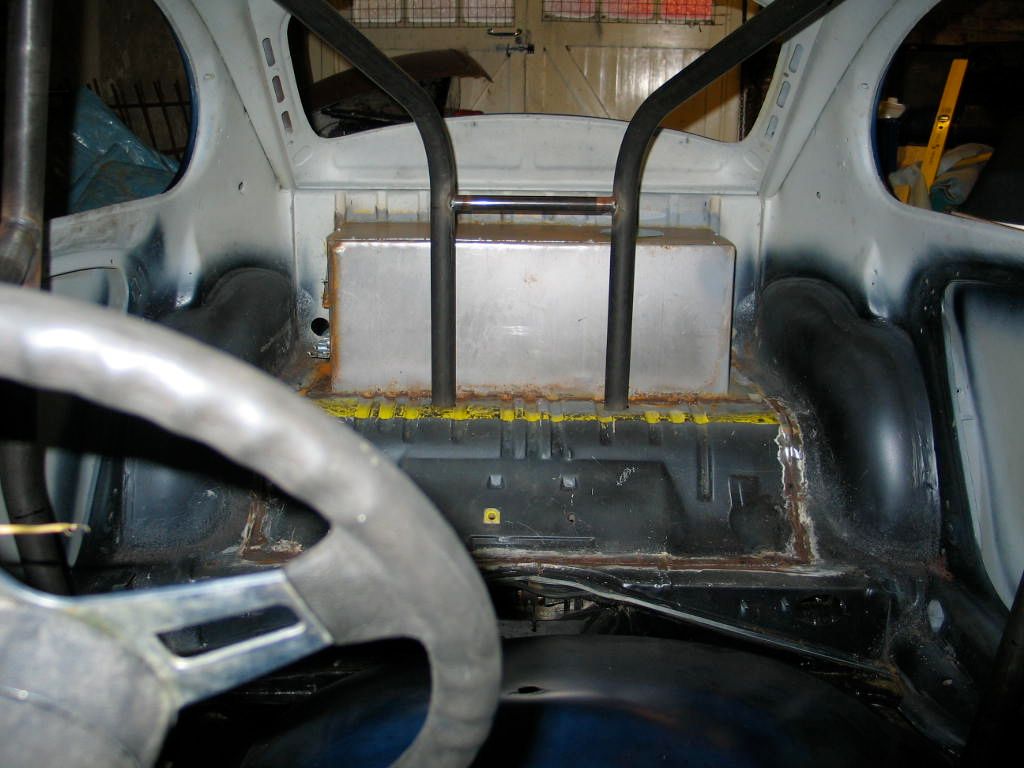

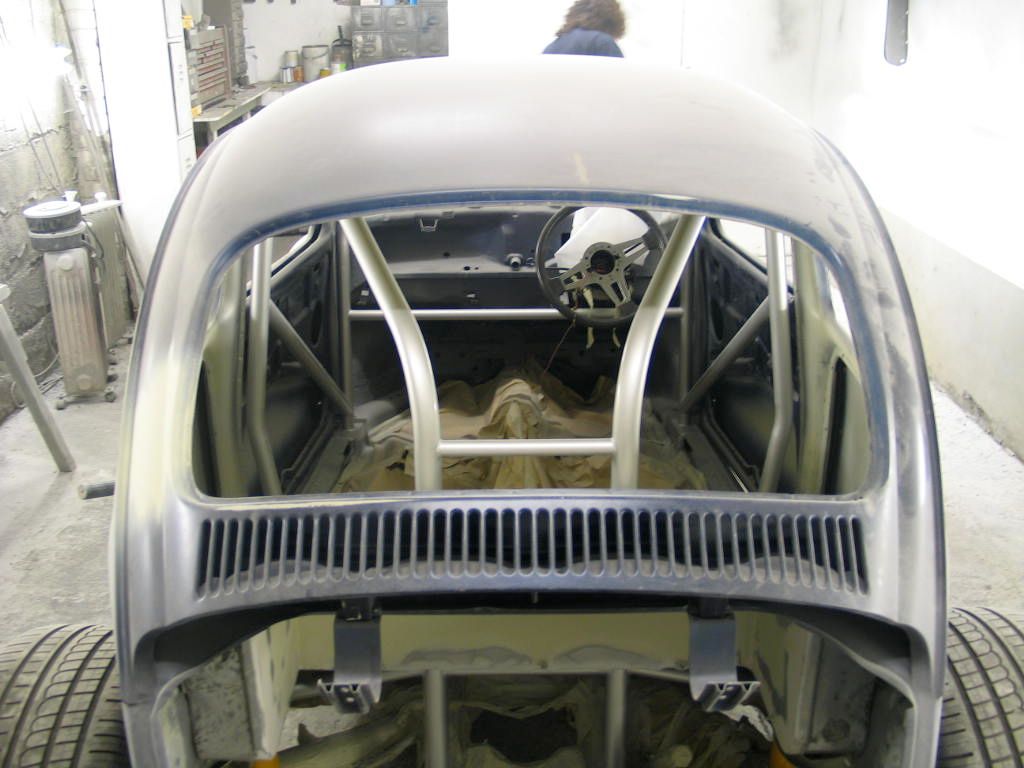

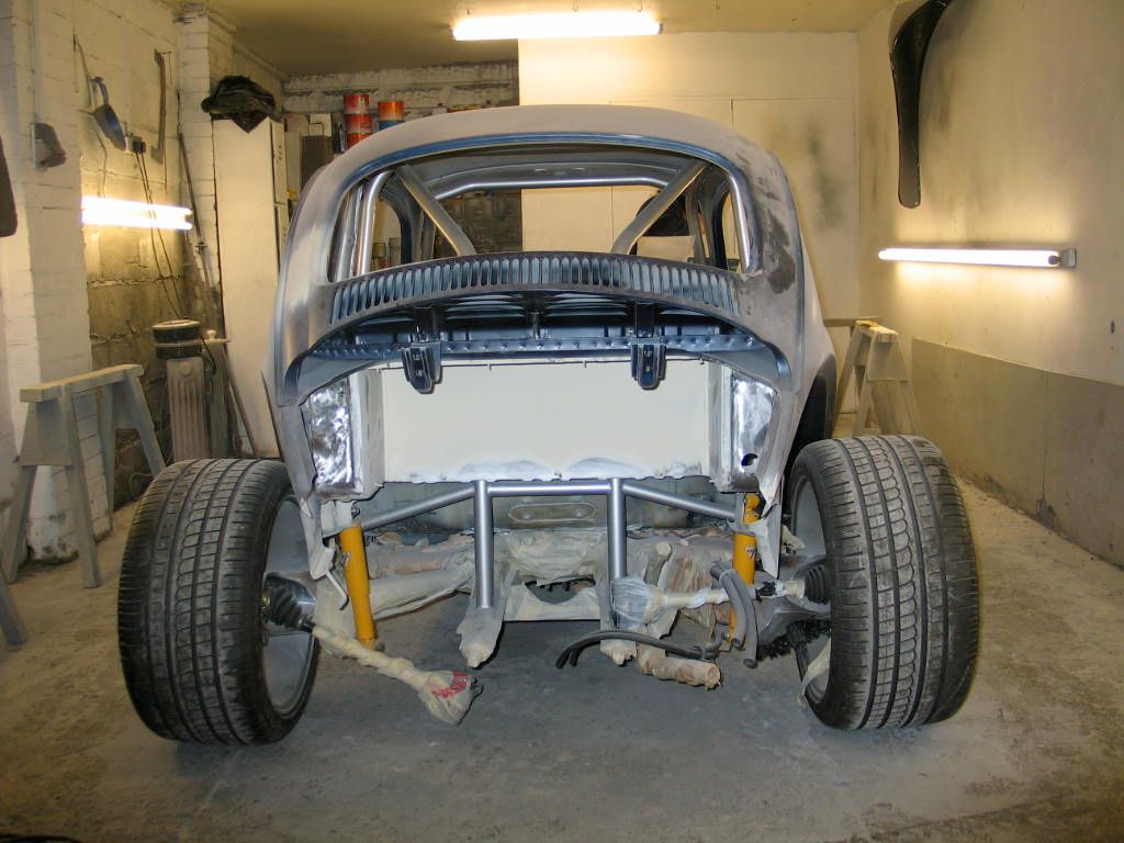

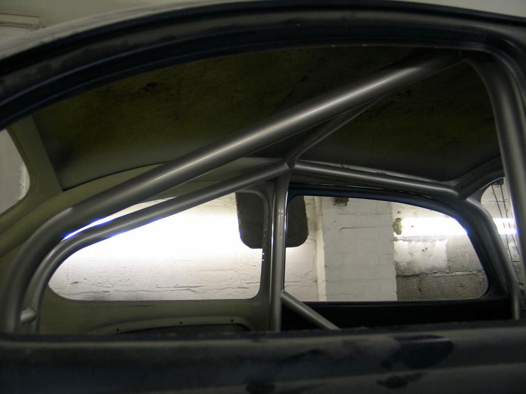

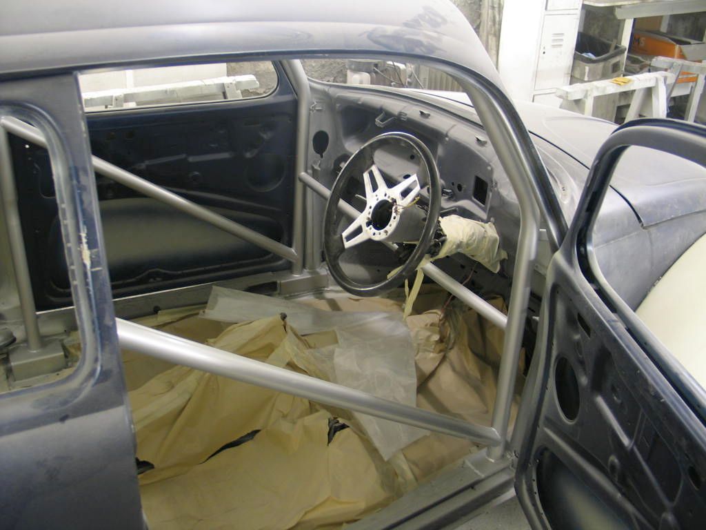

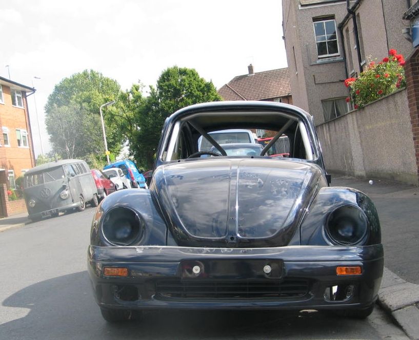

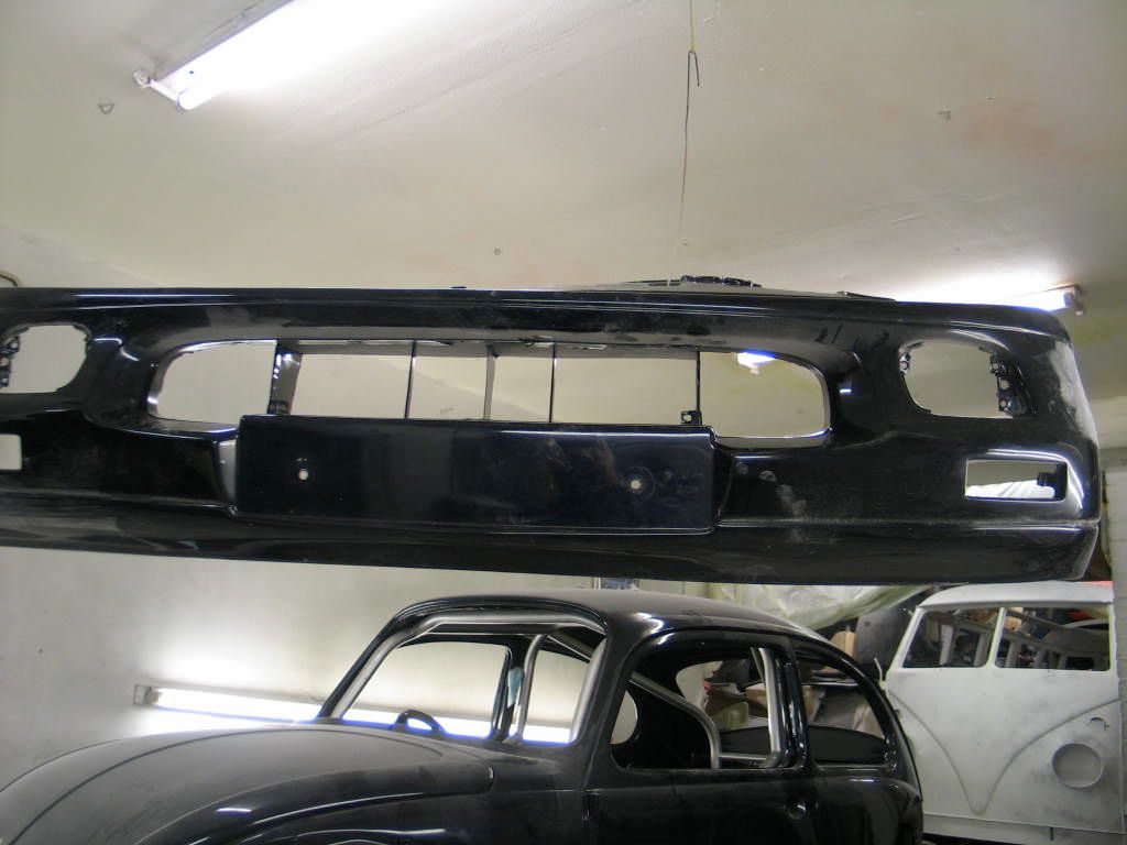

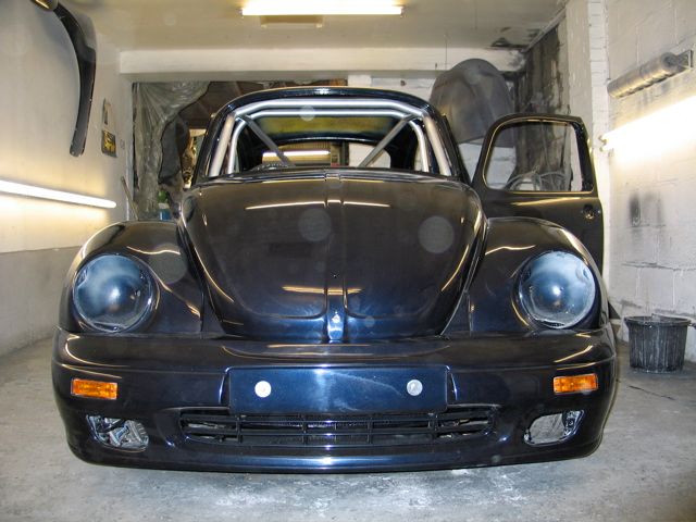

Roll cage fitted,this was done by Jim Smith of Cotsweld:notworthy: Jim has done an amazing job of the cage his welding is outstanding.http://www.cotsweld.co.uk If you are thinking of having a cage built here in the UK Jim's ya man.:cup1: Unfourtunately the pics I had of the car at Cotsweld seemed to have been lost :( so I only have some of the pics of the cage prior to paint.[IMG]http://i1185.photobucket.com/albums/...d.jpg~original~original[/IMG][IMG]http://i1185.photobucket.com/albums/...1.jpg~original~original[/IMG][IMG]http://i1185.photobucket.com/albums/...a.jpg~original~original[/IMG]
The cage was built this shape in the rear as I wanted to retain the rear seat.Not sure whats happening now though.
The ali arms where also polished.I have now got LAP rear coilovers http://www.laperformance.co.uk/blog/ ,thanks for all your inspiration Lee

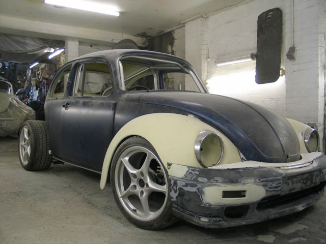

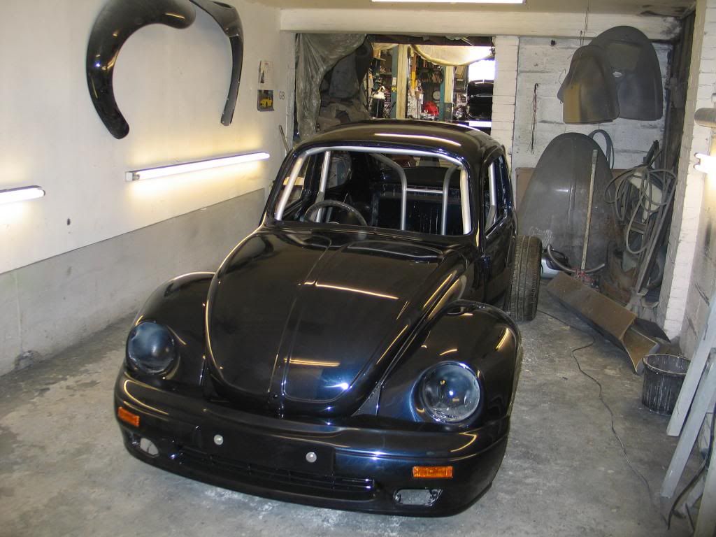

I managed find the wheels and tyres on ebay, these are called Carrera Classics.I wanted these for various reasons.1.I think they suit the ergonomic shape of the beetle 2.they're are reasonably unseen on GL cars I have only seen one other car and 3. they are easy to clean,I can clean the insides without having to remove them.Tyres are Pirelli P Zero's.[IMG]http://i1185.photobucket.com/albums/...6.jpg~original~original[/IMG][IMG]http://i1185.photobucket.com/albums/...c.jpg~original~original[/IMG] thanks for looking
