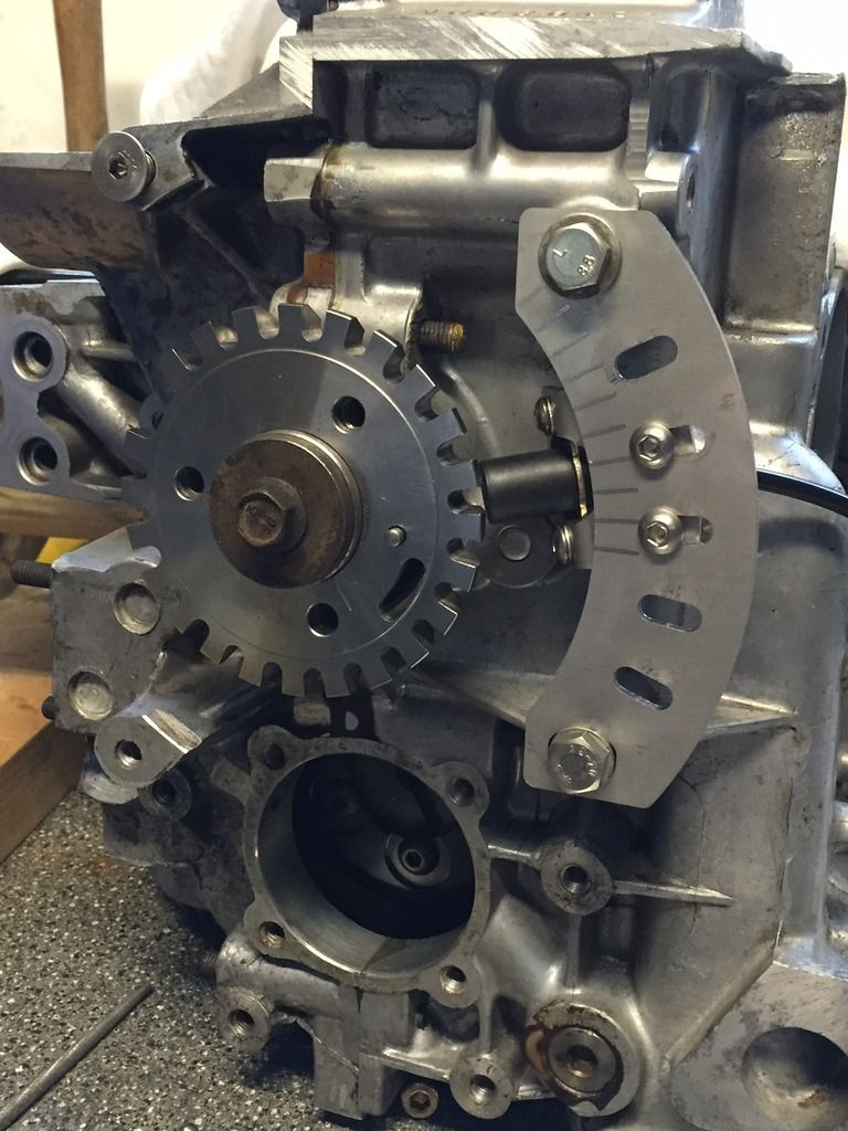

I came across this nice new carnk trigger system from VWSpeedshop (uk):
