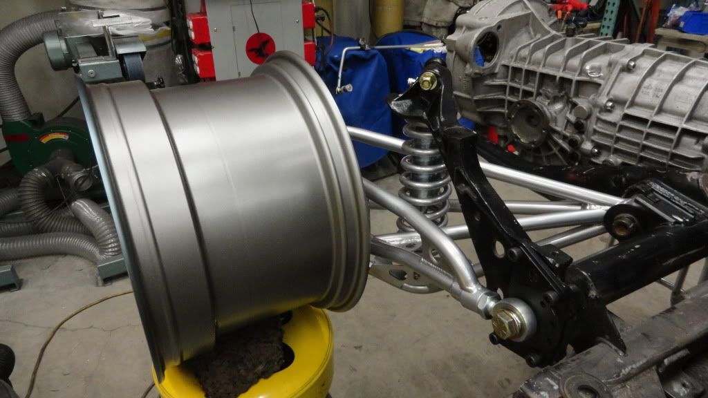

SuperRSi June 22nd 2013 15:44
Mendeola Suspension on a tube frame. The goal is to run Pikes Peak at least once and then street drive it. I will have two separate bolt in cages, one Pikes, one Street.

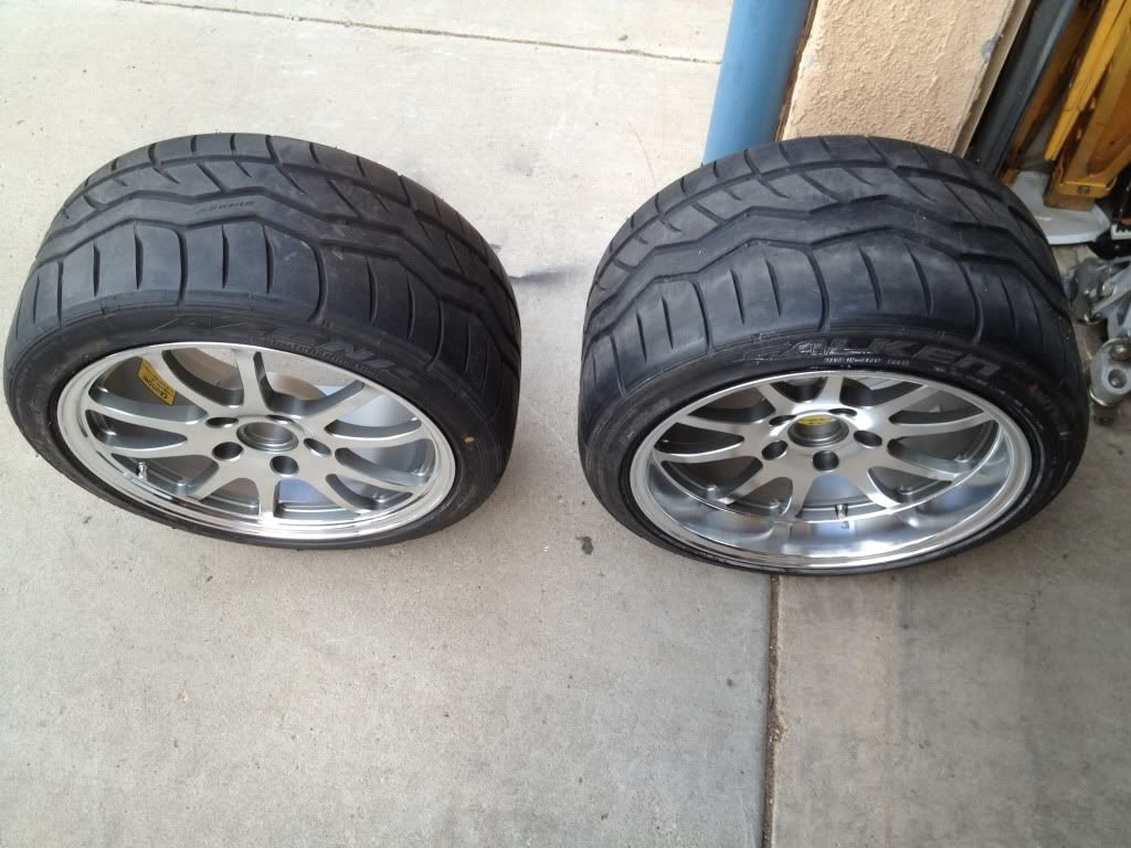

SuperRSi June 22nd 2013 15:46
275/18 front, 315/18 rear

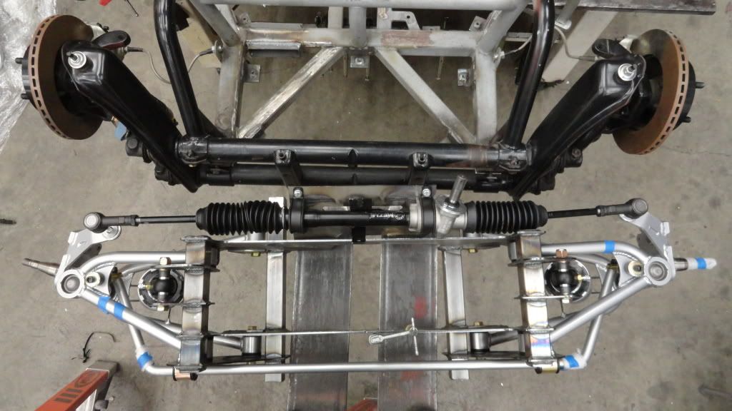

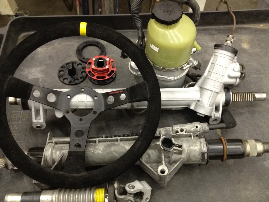

SuperRSi June 22nd 2013 15:49
Front Suspension comparison. Will switch rack to Porsche GT3RSR rack and electric power steering courtesy of Flying Lizard Motorsport

Volkdent the engine is a low mileage 2004 STi with a Tigwerks build on exhaust headers, water to air intercooler, billet TGV deletes, 900 DW injectors, Boomba racing big throttle body and a Blouch 20g-xtr turbo, HydraMist and Hydra 2.7, . All exhaust and turbo hot section are Swain Tech White Lightning coated. TurboSmart Racing BOV and Wastegate. Coast Fabrication muffler with Tigwerks wastegate muffler both for street use. Exhaust tips in honor of the great 908/3. Will go with a built longblock after a shake out period. Should be fine at this HP level for now considering low weight. Falkens for street and track rain, also have some NT-01's for dry, Pikes will be Hoosiers.

70Turbobug June 25th 2013 10:54
Damn Randy, you're getting serious! That is an awesome project! BTW what steering rack are you using? Do you have it in your bug also? Any pics of it? Right now I'm looking at a VW Polo/Golf 1-2 steering rack.
Mark
SuperRSi July 1st 2013 20:43
That is the 996 RSR steering rack right hand drive from Flying Lizards. It is an experienced part...
