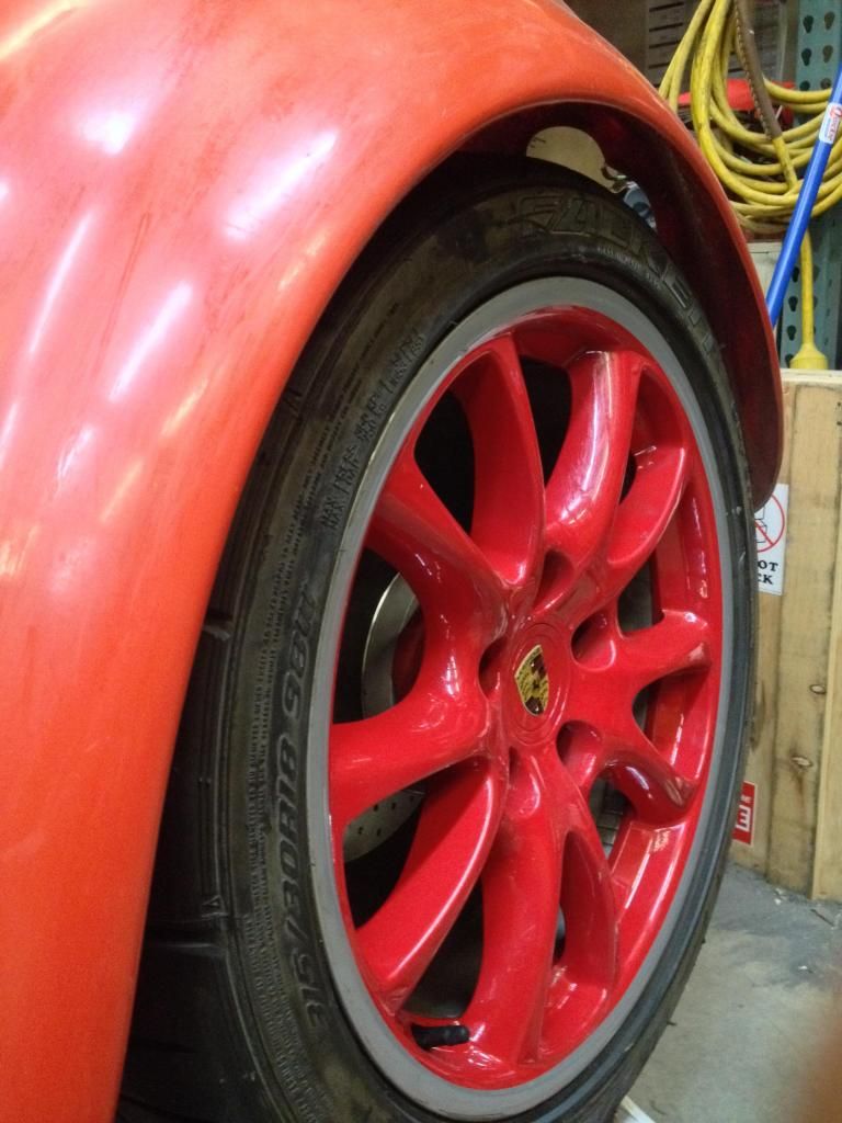

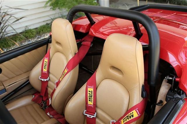

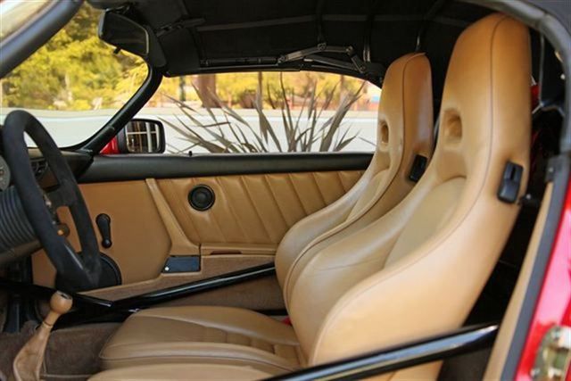

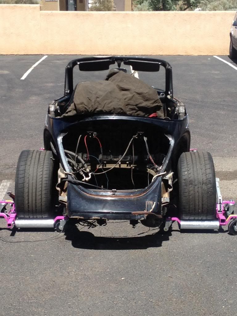

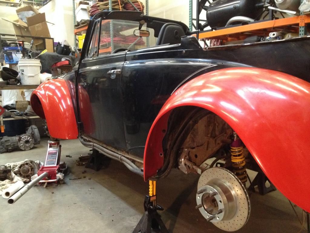

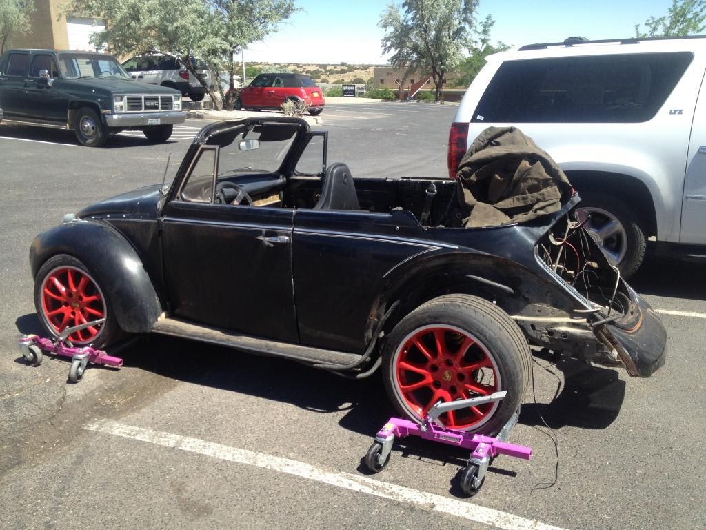

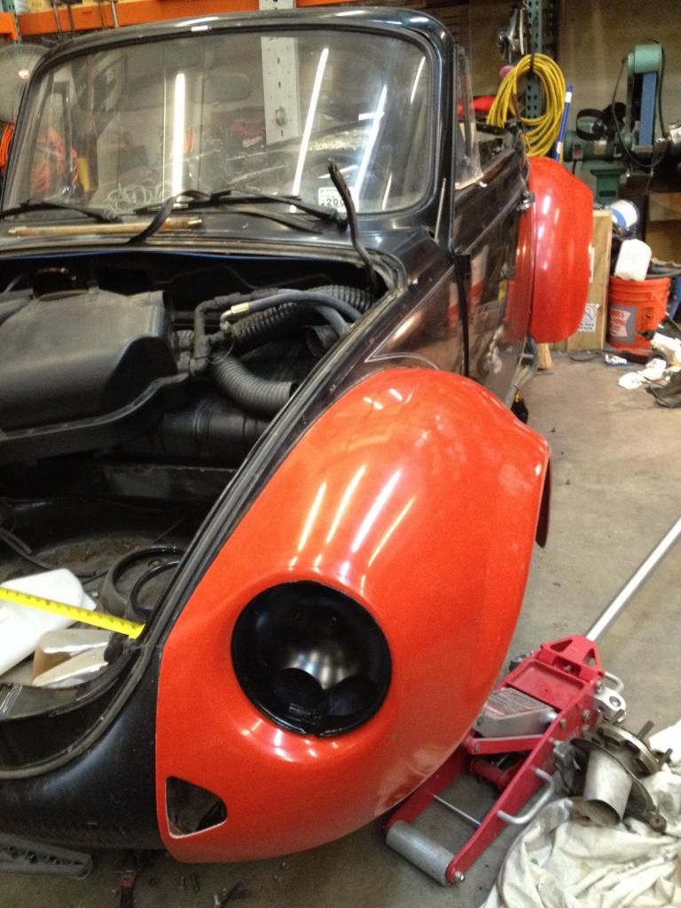

Well while waiting for parts for my Meyers Manx STi Pikes Peak car, I lost my storage building and had to pull out my 79 that had been resting for almost 10 years. So out came all the parts I have been collecting and I am getting her ready for new paint. Ordered Kerscher Kaefer cup flared fenders that arrive on United Airlines tonight and will be building a new rear apron. What a delight Kerscher is, one email, one Paypal and one week later fenders. It has KW-V2 coil-overs with MBT uniballs. Porsche GT3 seats, wheels, e-brake handle etc. My Mini-GT3...

SportyBug June 22nd 2013 18:47
Looks great and in far too few pieces for having been in storage.
Any chance you are in NM? Everything about that second picture looks familiar
SuperRSi June 22nd 2013 19:43
Yes in Santa Fe
And there are boxes and boxes of pieces in the shop upstairs.

I have a built Beetle 4 speed that will have a 2.3L Type IV attached about 180hp. The motor is being freshened at the moment. This will be a DD and street play car, maybe a little autocross. I will use Cayman S red brake calipers now that the Pikes car is getting yellow calipers. A leather/alcantera covered 911 style dash is now in the works using VDO 911 gauges and 904 combo gauge rebuilt about 10 years ago by North Hollywood Speedo. Audi TT A/C vents with full A/C. Webasto gasoline heater for winter. CAE shifter in aluminum.
In talks with Remmele now about providing the front bumper spoiler, CF hood and CF central air filter. Hoping that works.

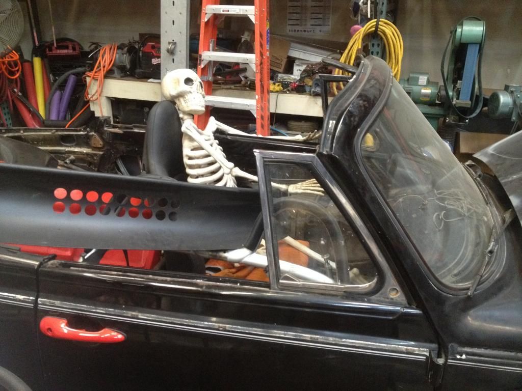

Any plans to stiffen the chassis?

SuperRSi June 23rd 2013 17:50
I plan to add DOM to the rear shock towers and torsion bar a la Remmele, and do the roll bar similar to the Canepa Twin Turbo Speedster that I think might be the best looking street convert 911 ever!

volkdent June 28th 2013 15:46
That's going to look really subtle and the safety of the roll cage and side bars will be great. If it is all tied together it should significantly improve stiffness as well.

SuperRSi July 1st 2013 20:41
Hey Mark, I am tying in the roll bar back X to the towers and adding the lower bars in the rear like a 5 bar.
70Turbobug July 2nd 2013 00:37
That will work well also. I wasn't sure if you wanted a roll bar since it is convertable.
