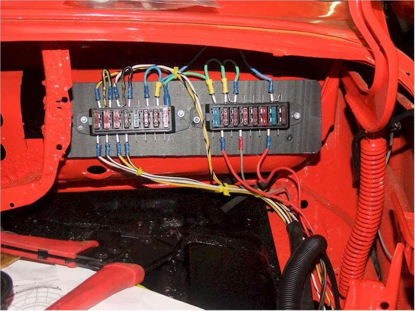

I agree the 1303 dash is a pain. I've made mine a little easier to deal with, I moved the fuse box into the trunk and made all the panels across panels across dash easily removable. I fitted M5 nutserts to the dash and held the panels in with M5 screws.
Cooling with any water cooled motor can be taken care of by fitting the radiator in the front and using an air con front apron.
My fuse box http://i1184.photobucket.com/albums/...e.jpg~original

Wiring can be a bit difficult on a 1303 with stuff behind the dash. A flat screen Beetle has most of the wiring laid out before you in the trunk, that's what I tried to achieve when I moved my fuse box into the trunk
