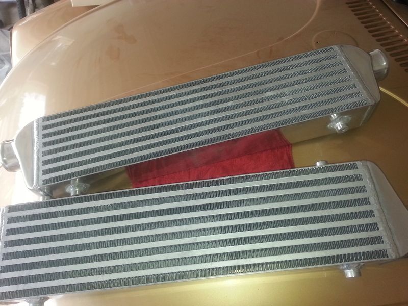

In the every day use, what problems would the EZ-30 cause in corners. Also would wet conditions pose a problem. O check this out, I was trying to clear some of the clutter in my garage today. I had brought down a shelf from my storage unit, it really helped sort things out where I can once again put my mind on it :o. I knew that I had two intercooler, but where? I stumbled on them without even knowing.
http://i86.photobucket.com/albums/k9...u.jpg~original
http://i86.photobucket.com/albums/k9....jpeg~original
Man that brought a smile on:D
