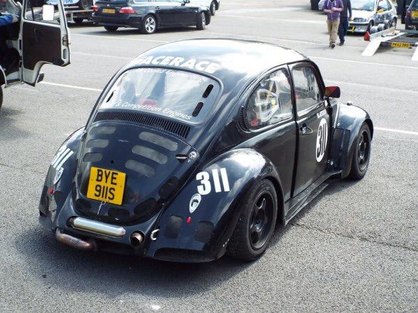

Here's mine, lots of time and work to make, they tie into the pan along its length, and into the rear diffuser, flat floor area is thereby increased considerably, airflow underside is cleaned right up, increasing its speed and so lowering its pressure, I got caught out on slicks recently in heavy rain, apart from wheel spin etc with Aqua plaining, corner speed and grip was way beyond previous levels, so far so good, mk two version in the mould...s254.photobucket.com/user/spannermanager/media/image.jpg8.jpg.html]http://i254.photobucket.com/albums/h...8.jpg~original[/URL]
graham January 21st 2016 12:21
Sort of hi jack but Wow I think thats the first time I've seen your car Spanners :cool::cool: looks like you've been busy......
owdlvr January 21st 2016 19:09
Hmmm...the whole underside of Spannerman's car is suddenly of high interest. There is some seriously awesome stuff going on there!
