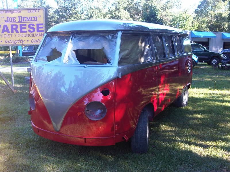

I'd buff the paint and it'd look OK for about a week, then would fade again and finally got tired of the goofy fender flares a PO put on there and put my bus in jail--the paintbooth for 1 1/2 years which was 1 year and 3 months longer than that crackhead promised me it would take to repaint the bus.
http://i52.photobucket.com/albums/g3...8.jpg~original
It turned out pretty good though.
http://i52.photobucket.com/albums/g3...5.jpg~original

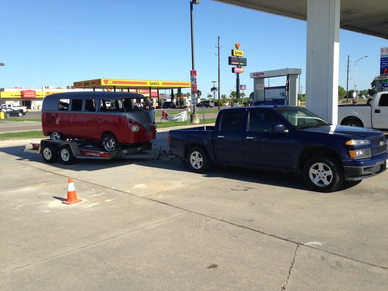

Towed her over from storage here earlier this year and I've been busy doing welding on her here and there plugging up holes from all the years. :)

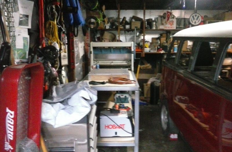

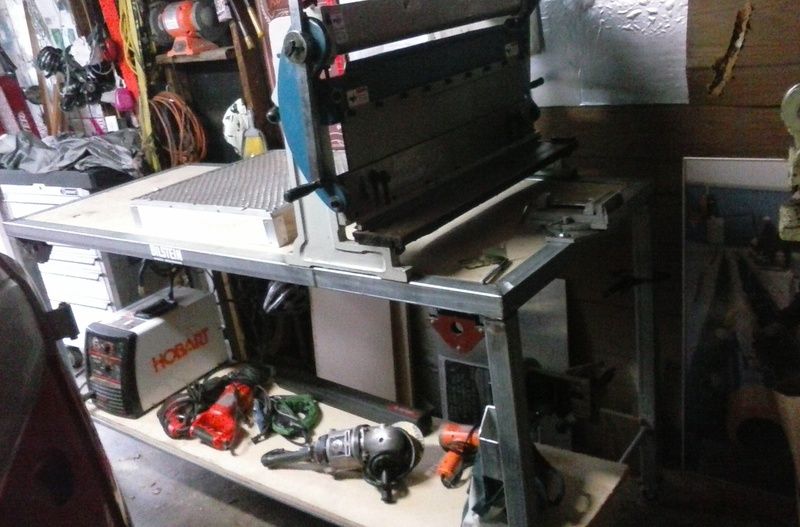

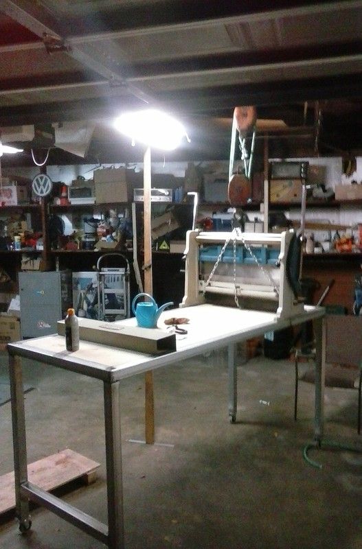

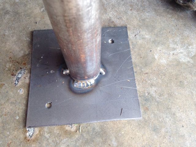

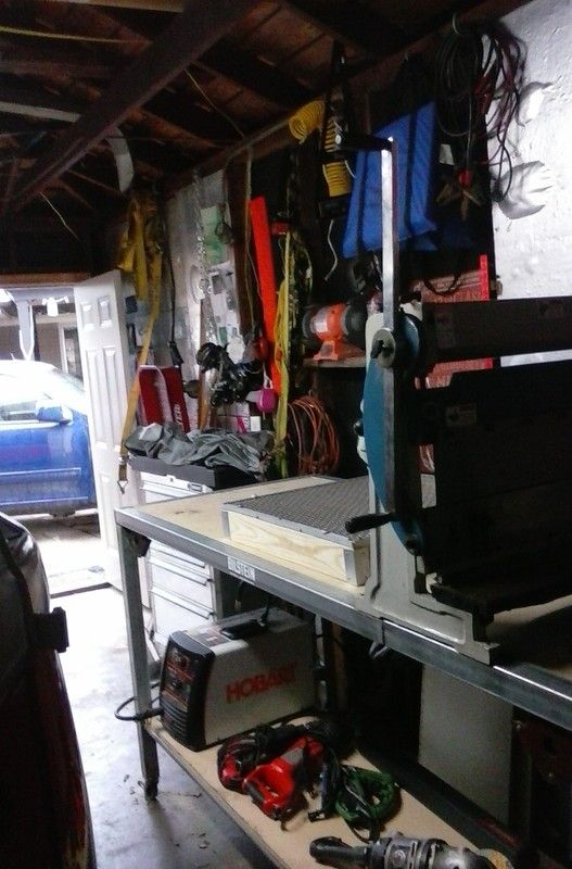

I welded a work table for myself and my father-in-law helped me get the 3 in 1 machine on top of it over the weekend. We used a couple of pulley blocks I bought from a nautical supply place in Galveston. Man, it's so much easier to do stuff with a workspace now. Sorry for the crappy pics.
http://i52.photobucket.com/albums/g3...j.jpg~original
http://i52.photobucket.com/albums/g3...t.jpg~original
http://i52.photobucket.com/albums/g3...u.jpg~original
http://i52.photobucket.com/albums/g3...c.jpg~original

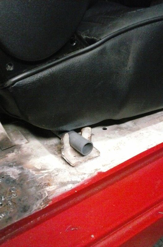

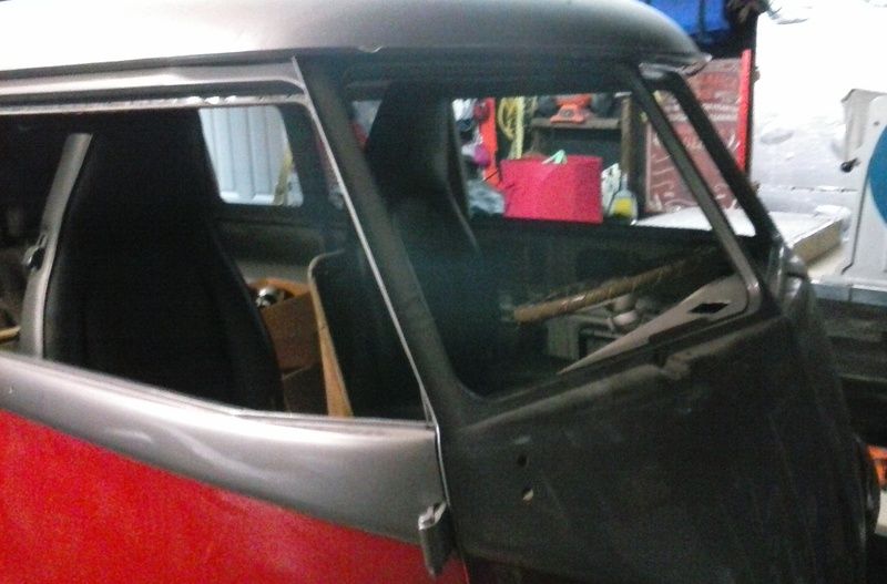

I've been lightening and fitting some 944 seats a friend of mine gave me a while ago. Again, I've learned a few things over the years and hacking, cutting, and drilling more holes than is necessary (actually on the bus) is like nails on chalkboard to me. I used the stock mounting points to fit the seats.
http://i52.photobucket.com/albums/g3...e.jpg~original
http://i52.photobucket.com/albums/g3...d.jpg~original

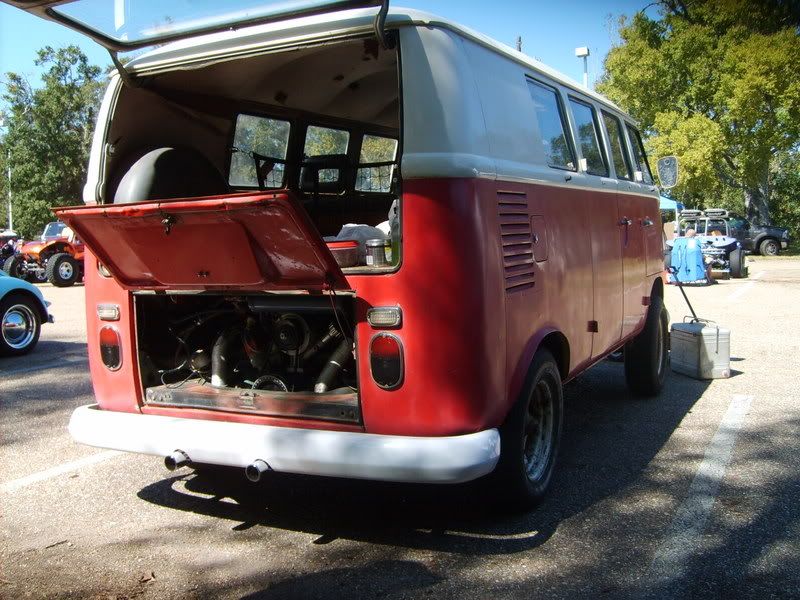

My old GL bug I at the autocross in New Orleans a few years ago next to my buddy's S4. I sold that bug before we moved to Ecuador.

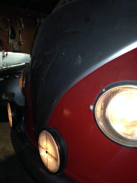

Last summer I spent some time putting the front bumper back on the bus, mounting and wiring up with a relay the fog lamps on the bus.
http://i52.photobucket.com/albums/g3...x.jpg~original

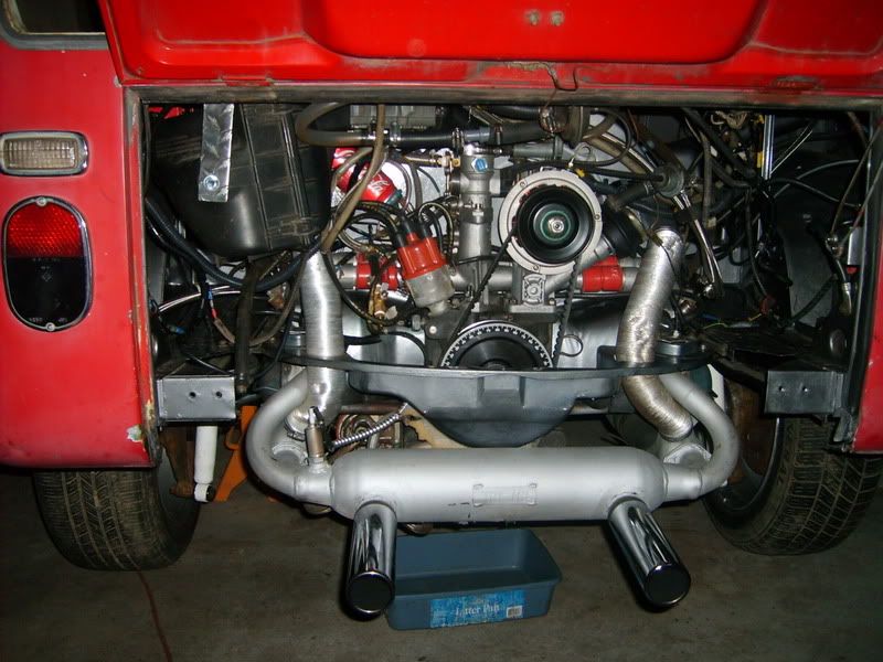

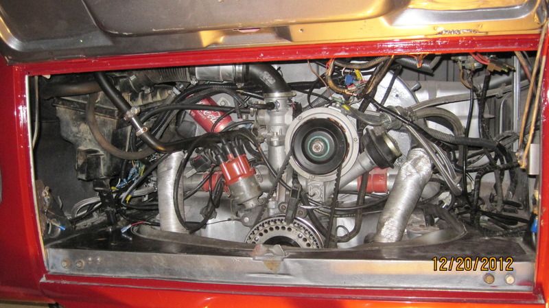

The MS installed. It was running like poop. I spent a couple of weeks of evenings just trying to figure out why the EDIS wasn't working then wound up going back to the 009 just so it would run. It then ran, but barely. The tune was so far out I couldn't tell if I was making it better or worse.
I know people have had a lot of success with these, but MS has been by far the biggest headache system I've ever dealt with over the years and I've dealt with at least a dozen FI different systems. You get what you pay for though. Cheap ECU and scattered information in all directions.

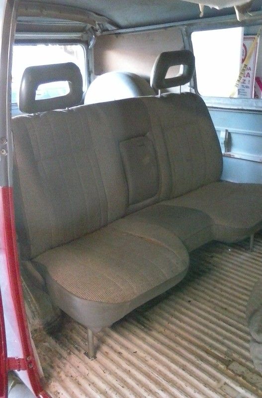

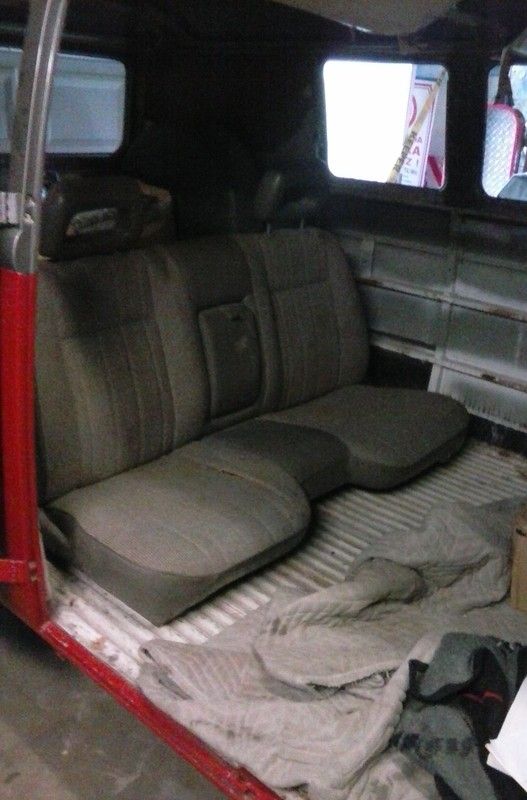

Not too much to report, but I've been steadily working at getting the rear bench seat mounted. It's out of a pickup truck and has been trampled on by various dogs and kids (shop helpers sometimes) over the years. It's just a little dirty now, but all three seats will be recovered in grey leather at some point.
I popped the sliding track off the bottom of the bench seat as there's no need for it to slide and I'm fabbing up a different frame and straight posts on the underside to tie into the two rearmost stock mounting holes on the floor.
Sorry for the crappy pics:
http://i52.photobucket.com/albums/g3...g.jpg~original
http://i52.photobucket.com/albums/g3...k.jpg~original
Jadewombat January 10th 2016 18:50
That's better. Up and off the floor and at a good height to look out the side windows and not block the rear view.
http://i52.photobucket.com/albums/g3...b.jpg~original

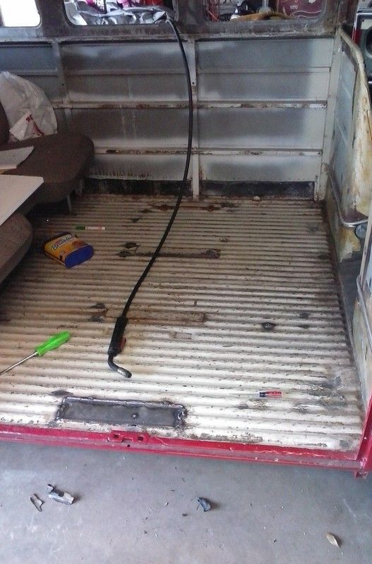

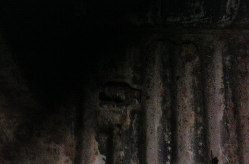

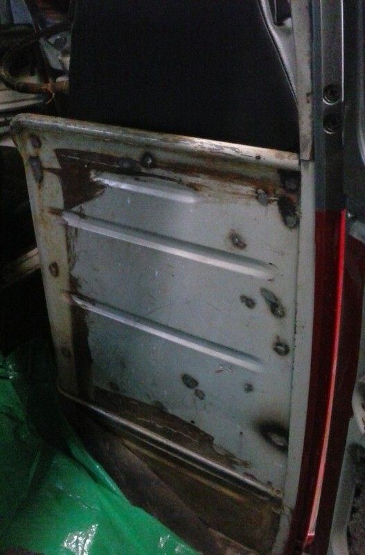

I've been welding the middle area and all the holes. Some PO did some pretty good drilling back there. A lot of the holes were plugged with caulk about 3/8" big. Some pretty good rot waiting under the passenger side middle row seat mount as you can see here also.
http://i52.photobucket.com/albums/g3...r.jpg~original

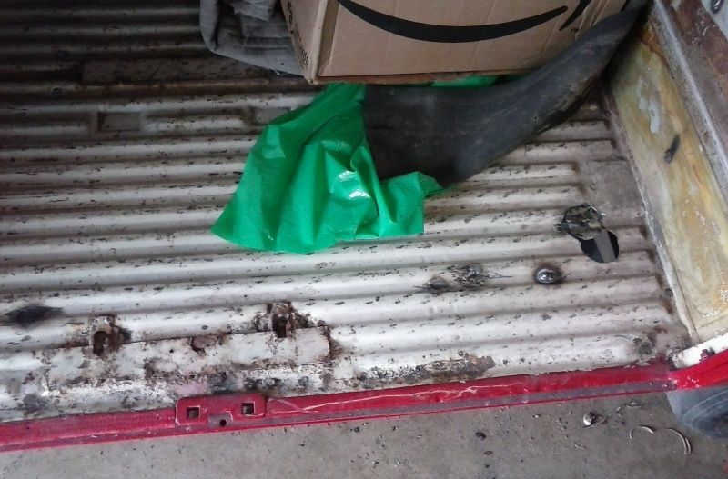

Jadewombat January 23rd 2016 22:24
Shifting towards the drivers' side...more holes. I'm pretty sure the bus didn't leave Hannover 50 years ago that way.
http://i52.photobucket.com/albums/g3...z.jpg~original

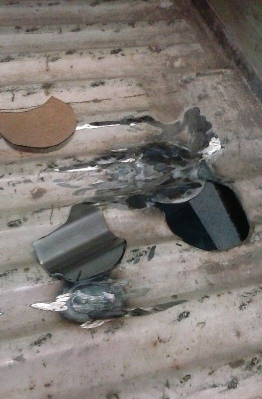

So somewhere in the history of my bus near the passenger side in the mid-section someone used a giant hole saw, decided that wasn't where they were going to put Daisy's sink or flower stand or whatever it was, then cut a new hole all the way through right next to it. Probably took about 2 minutes to gouge that hole and the half moon piece of 16ga. metal you see here took me a little over an hour to fab. up. At least I have the metal working tools at this point in my life to do this kind of stuff.

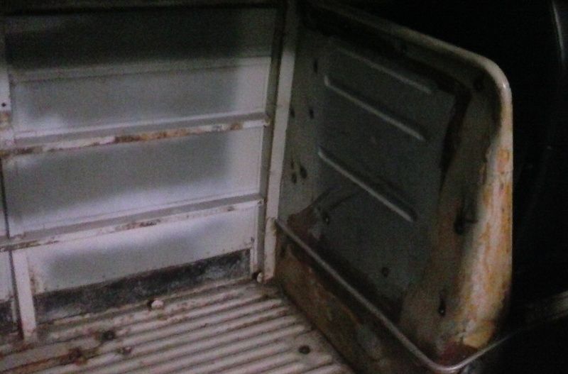

Jadewombat February 15th 2016 21:36

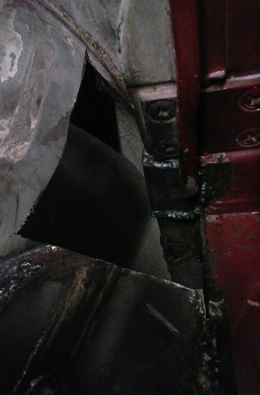

More stuff up front in the cab area. Water dripped down the inside of the door and ate away the lower pillar and floor here.
http://i52.photobucket.com/albums/g3...i.jpg~original
