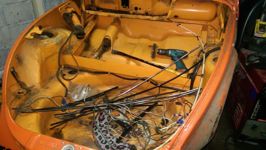

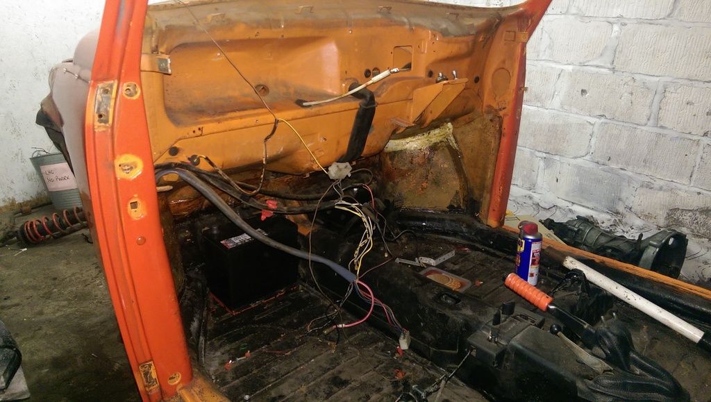

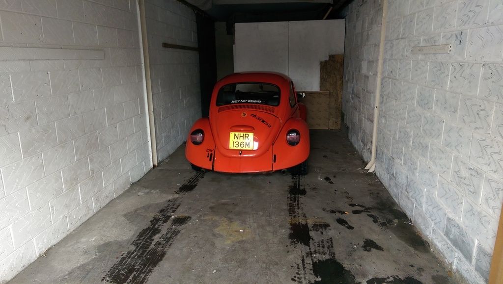

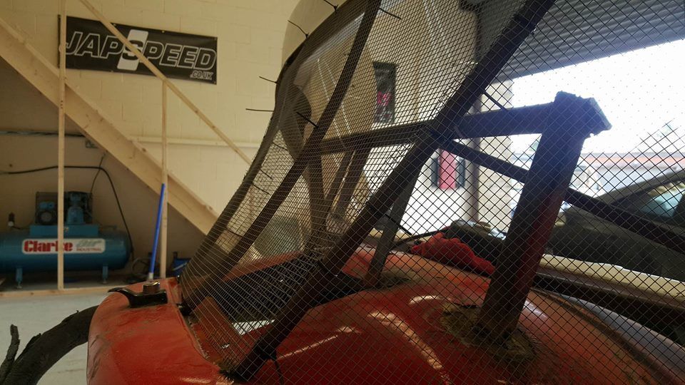

Hey guys

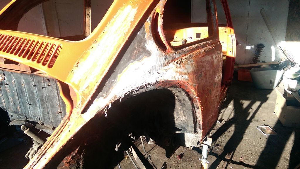

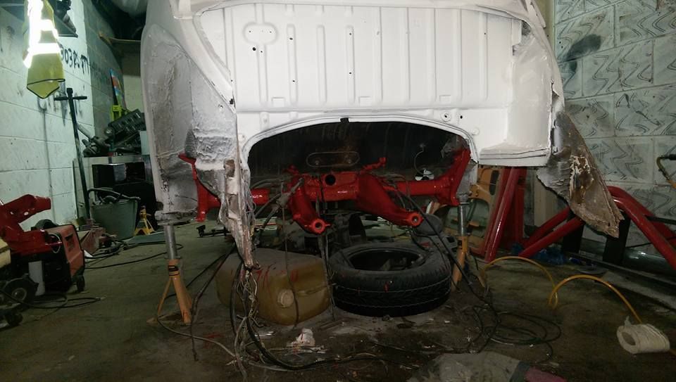

So this is going to be my first full car build, I have done bits and bobs but never undergone a full car.
This is not going to be as mad or as wild as some of the builds on here but I am putting everything I can into her while on a HUGE learning curve!
The plan is to have a nice comfortable street car that I can take to the track whenever I like, I have a few things to work out yet like heating etc (thinking of eberspacher).
I am trying to create a look that is very functional and am trying to add as little 'rice' parts as possible and I am only adding parts that should serve a purpose"

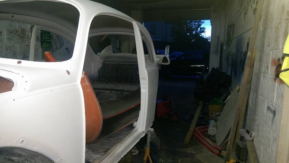

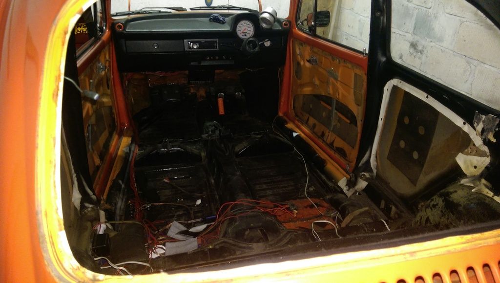

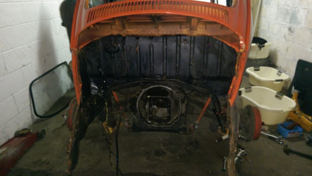

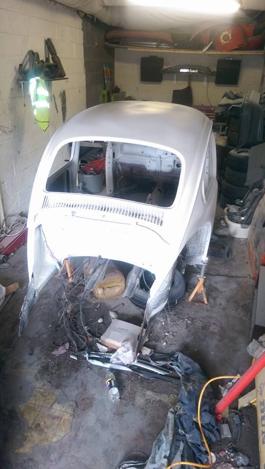

I have many plans which will be changing as I go along but without further a due I shall put up my pictures in order of what I have done.
I have been on this now for about 6 months Prior to me posting these so a lot of pics in the first and will update as I go.

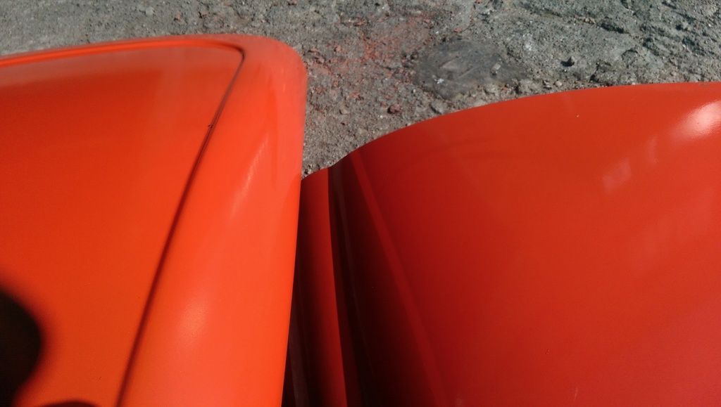

Just a quick test of colours
http://i200.photobucket.com/albums/a...b.jpg~original
Left is new right is old

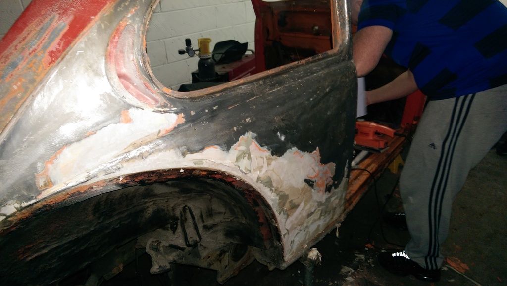

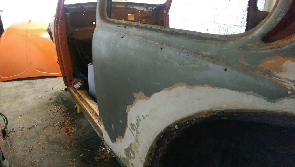

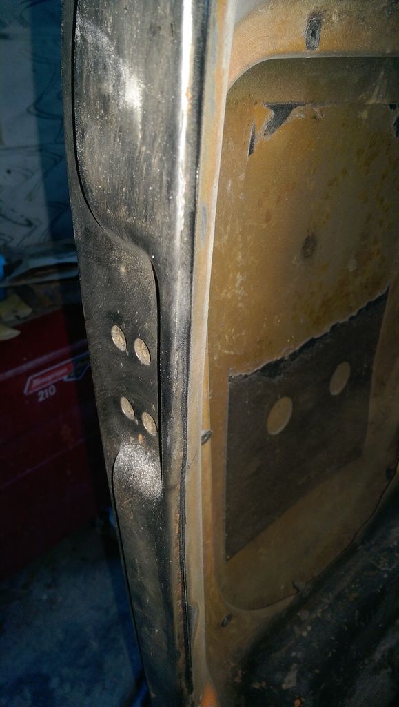

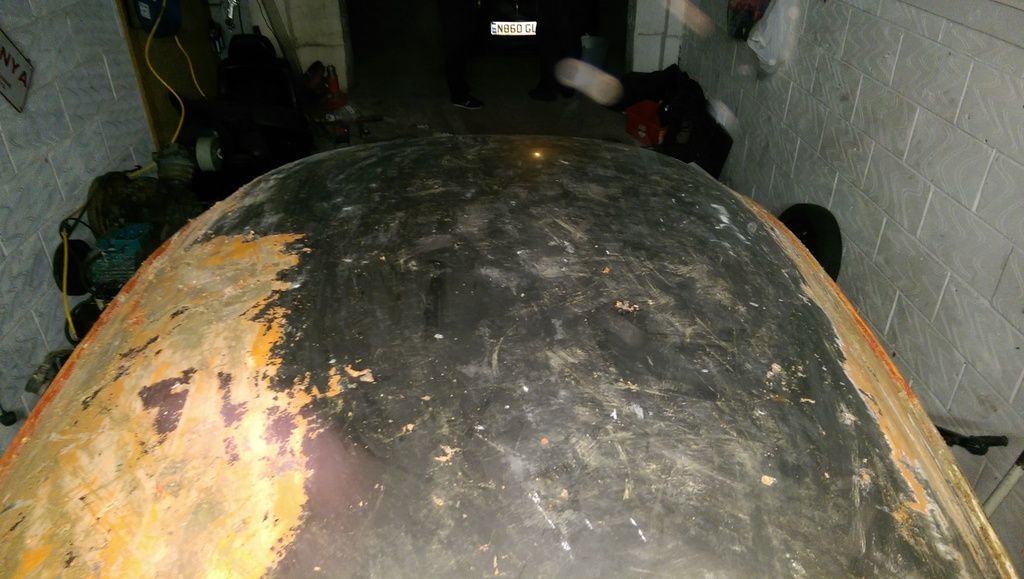

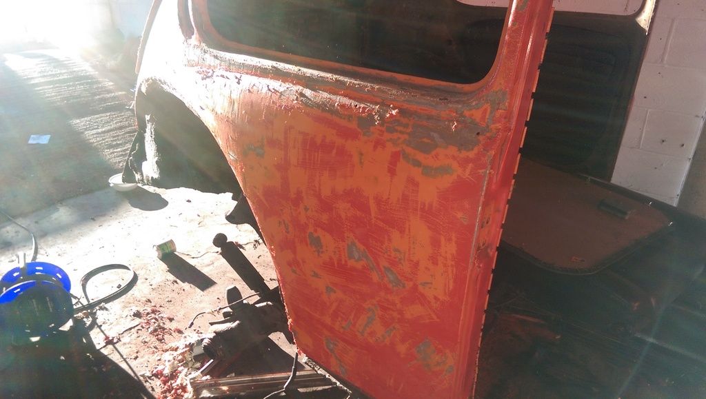

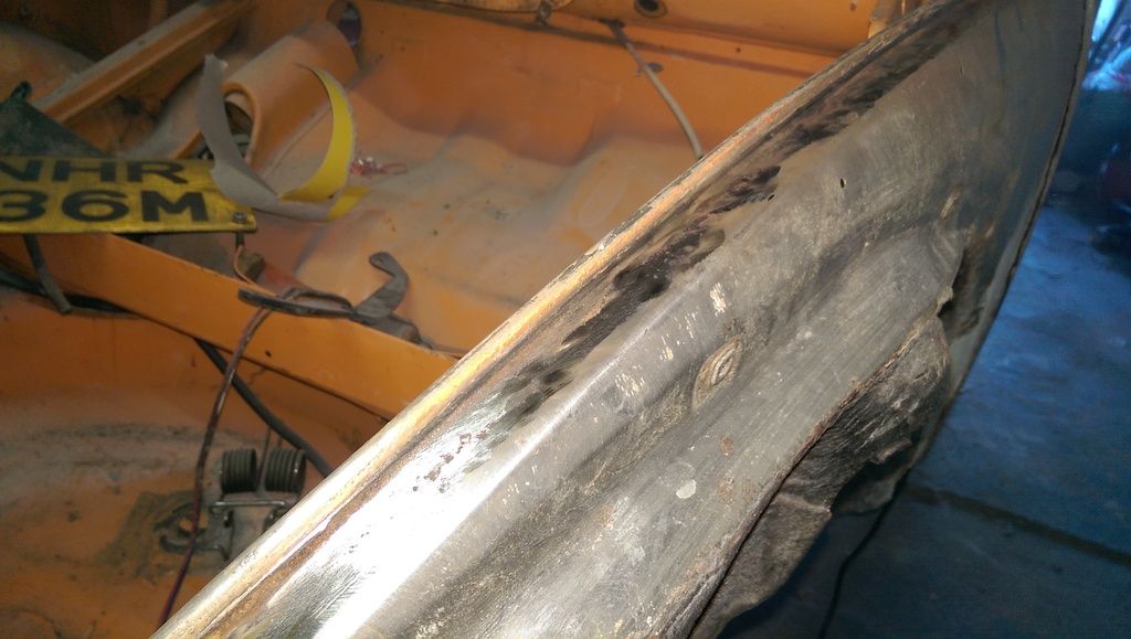

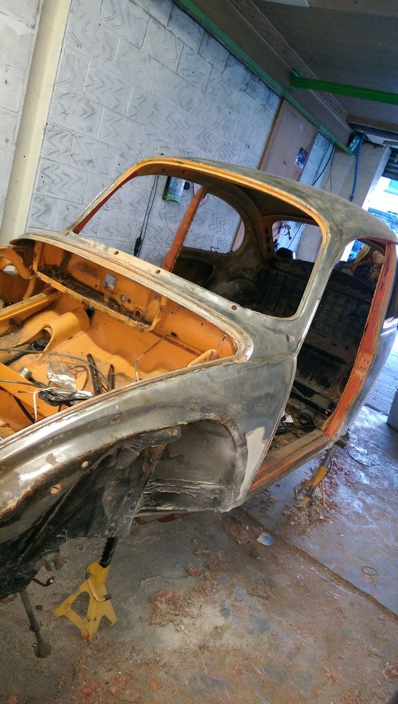

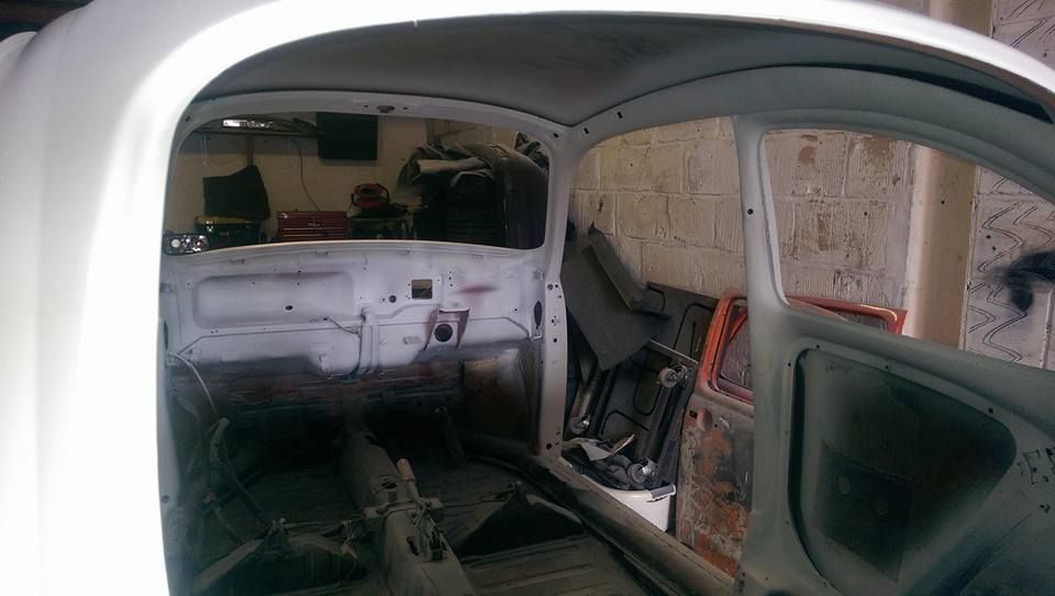

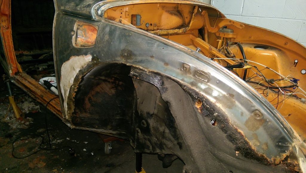

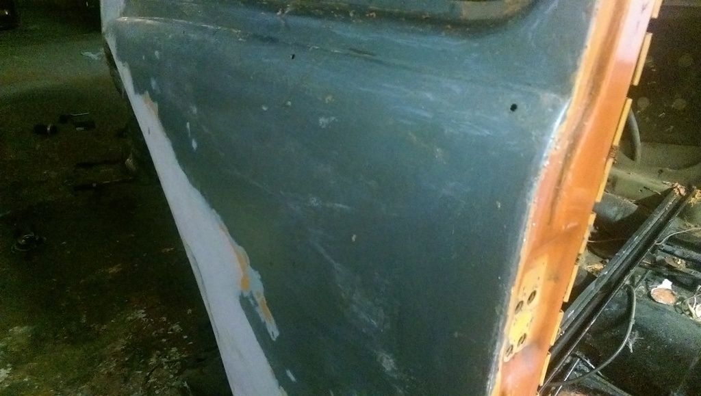

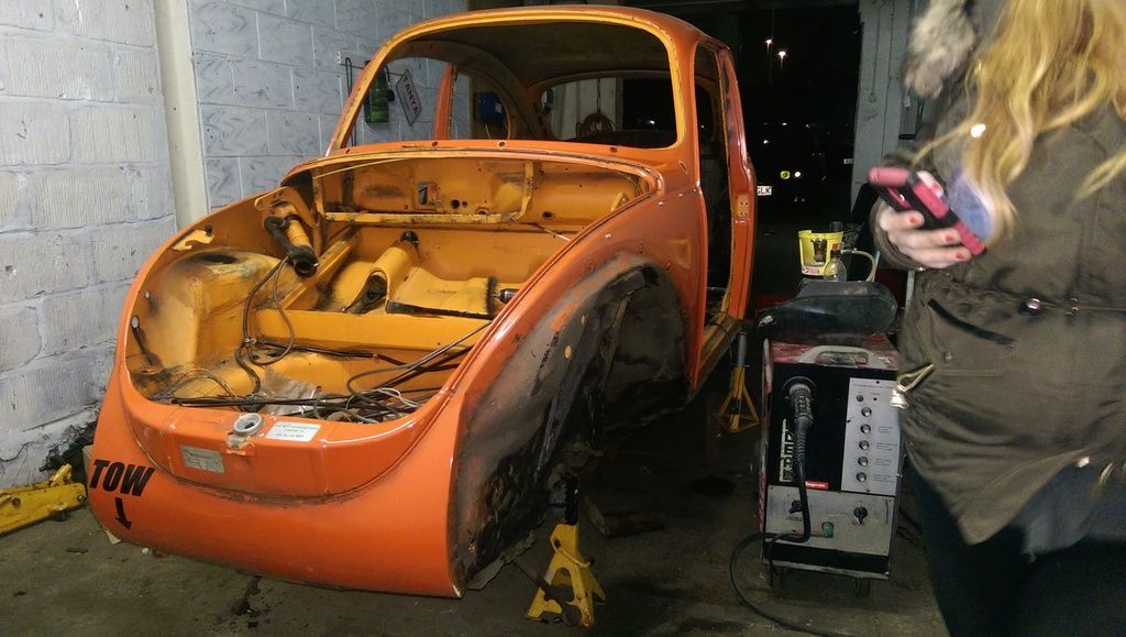

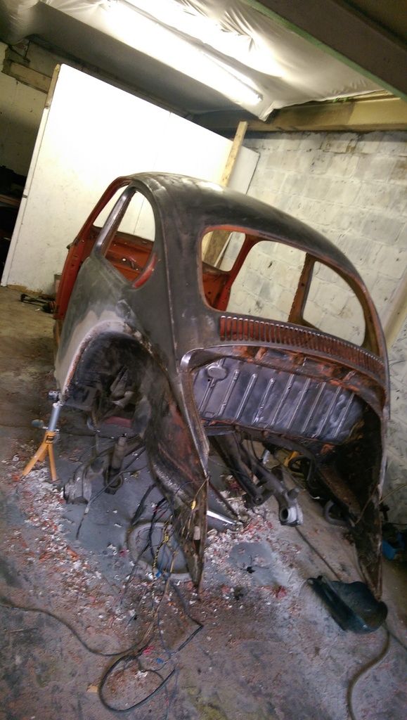

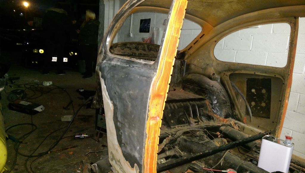

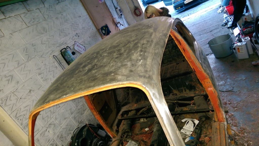

Paint stripping all by hand
http://i200.photobucket.com/albums/a...g.jpg~original
http://i200.photobucket.com/albums/a...d.jpg~original
http://i200.photobucket.com/albums/a...c.jpg~original
http://i200.photobucket.com/albums/a...5.jpg~original
http://i200.photobucket.com/albums/a...l.jpg~original
http://i200.photobucket.com/albums/a...h.jpg~original
http://i200.photobucket.com/albums/a...1.jpg~original

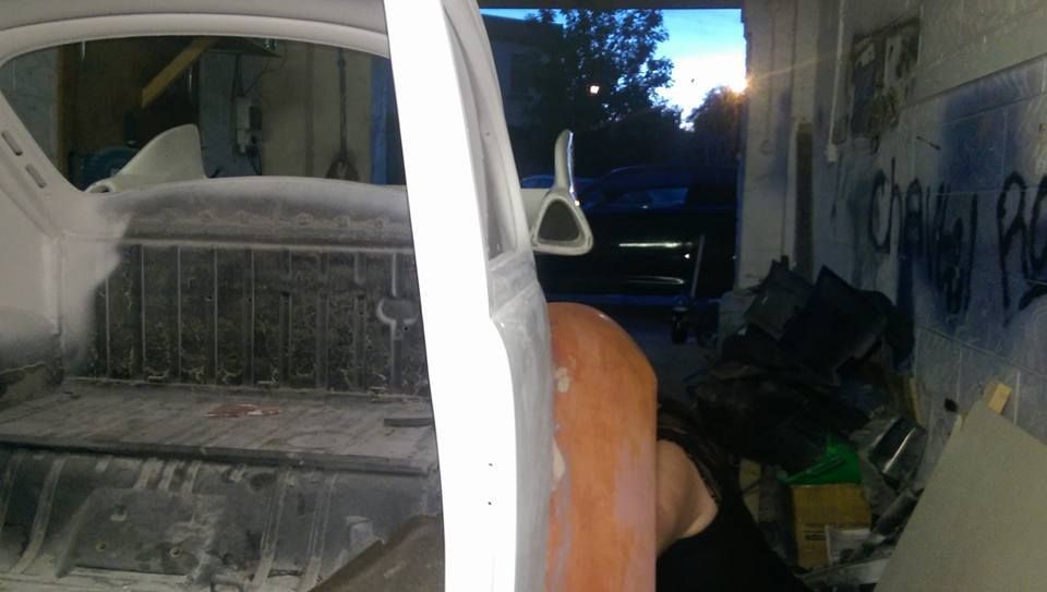

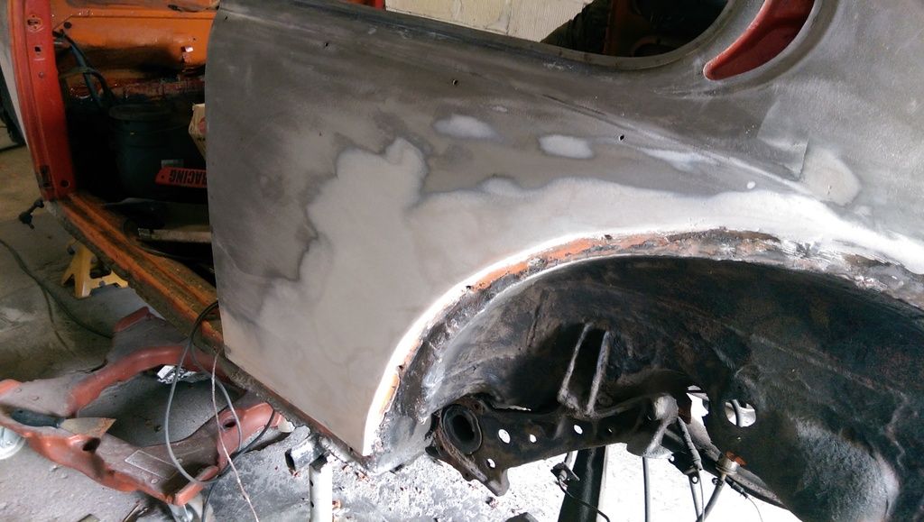

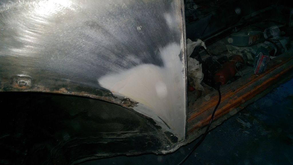

Filler an smoothing
http://i200.photobucket.com/albums/a...n.jpg~original
http://i200.photobucket.com/albums/a...7.jpg~original
http://i200.photobucket.com/albums/a...r.jpg~original
http://i200.photobucket.com/albums/a...s.jpg~original
http://i200.photobucket.com/albums/a...a.jpg~original

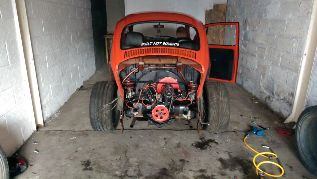

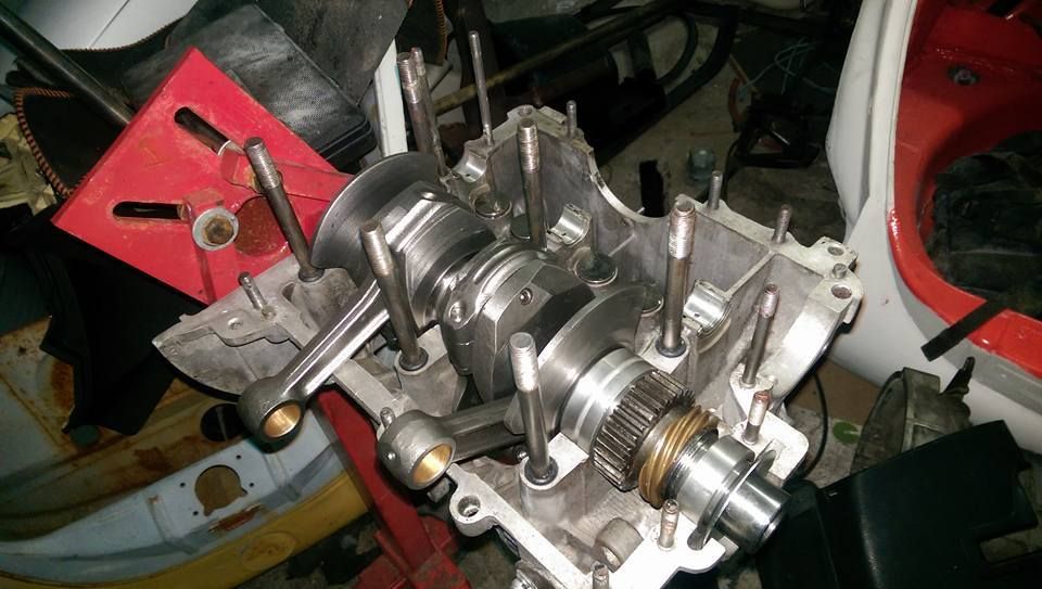

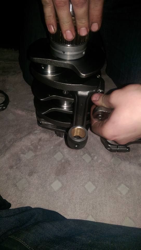

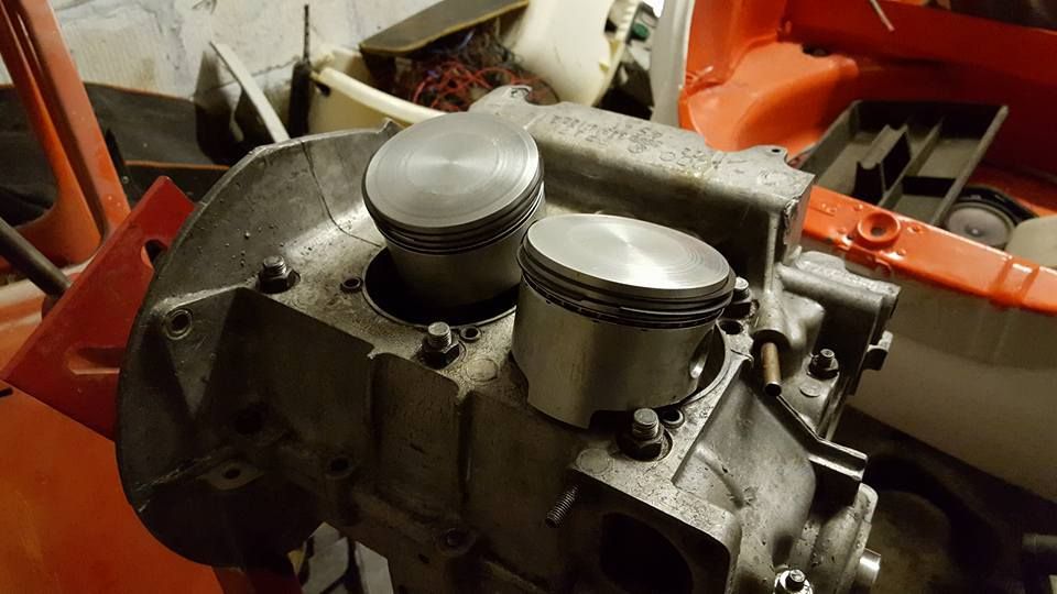

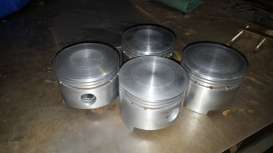

eNGINE START 2110CC with 120 cam custom pistons and ported -44 heads
http://i200.photobucket.com/albums/a...f.jpg~original
Custom pistons dome topped
http://i200.photobucket.com/albums/a...e.jpg~original

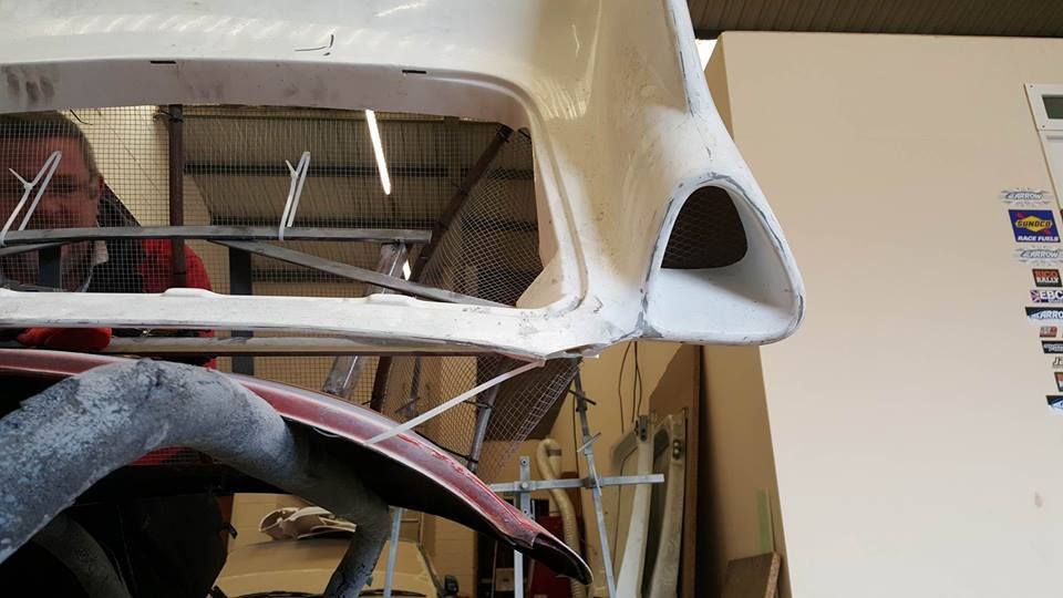

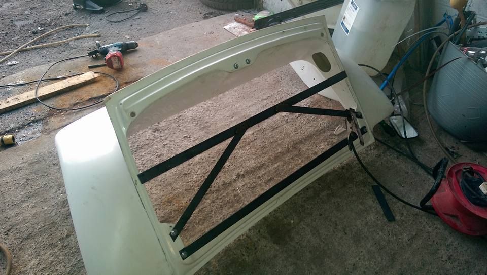

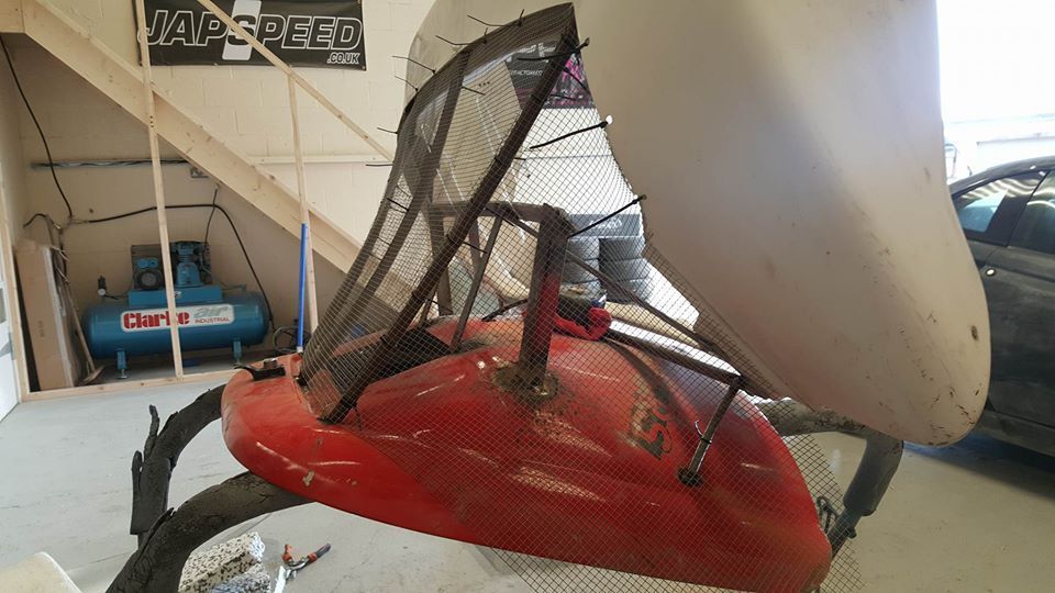

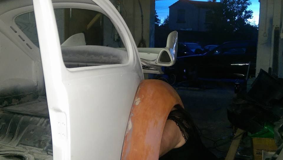

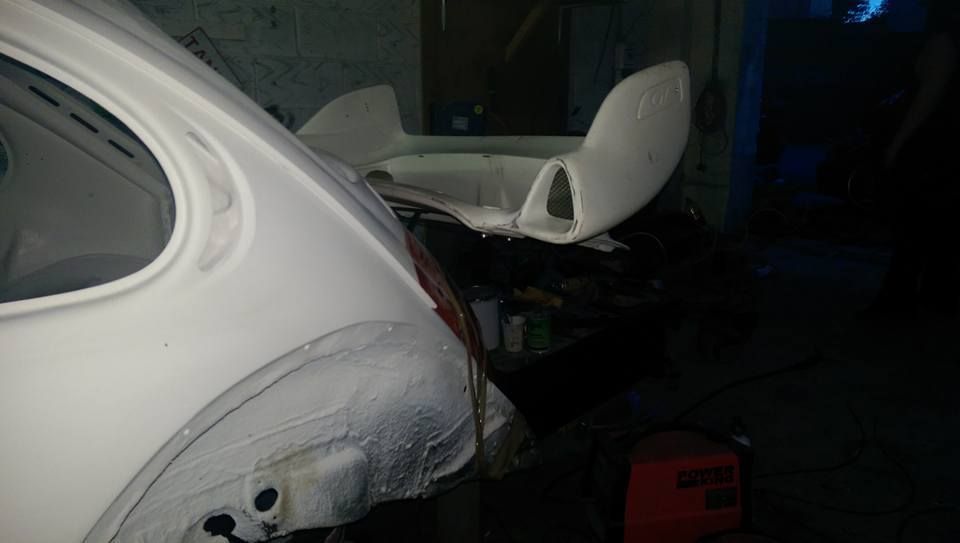

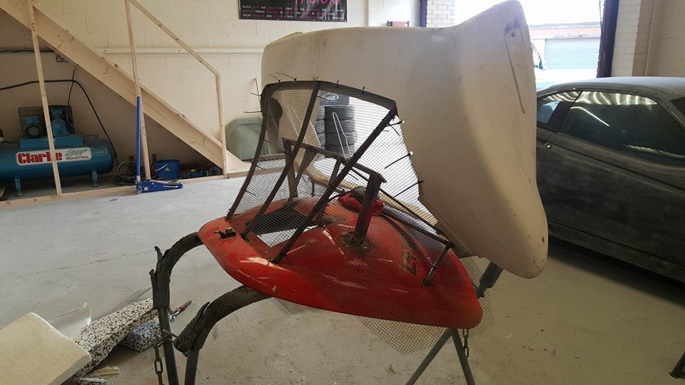

GT2 wing mock up
http://i200.photobucket.com/albums/a...x.jpg~original
http://i200.photobucket.com/albums/a...4.jpg~original
And that is where I am up to so far

looks awesome man. keep up the good work. and keep the update pics coming. where did you source that spoiler? ive pondered getting one myself of that style.
CraigRobbo January 26th 2016 11:21
Thanks for the reply!

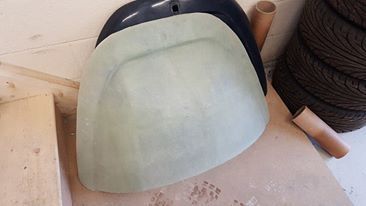

I found the spoiler on eBay, it has now been sent away to be moulded in and glassed into a bootlid so it should look like a one peice unit! Fingers crossed.
The glassing was one of the few things I did not want to try myself, Maybe small parts but not something of this scale as my first try.
Craig

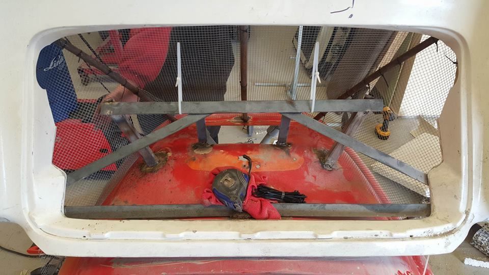

I have a few things being done/bought already to help, I have a rollcage which is going in, that should help increase rigidity (although its only a 4 point it should still help_ I have a front Strut brace and a rear 4 point strut brace, this should reduce flex and hopefully increase handling characteristics.

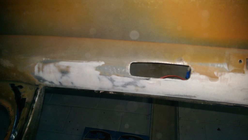

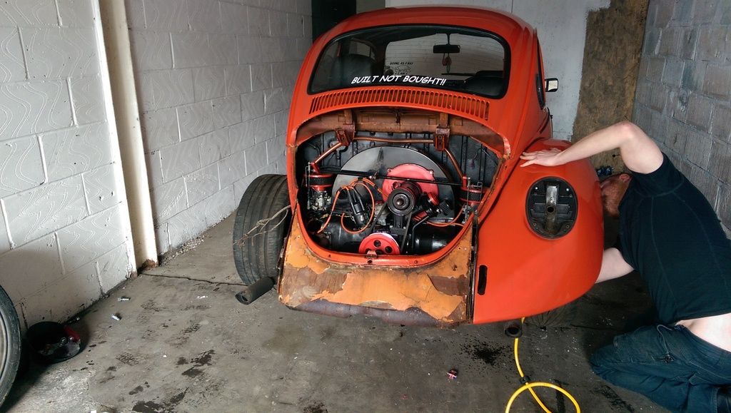

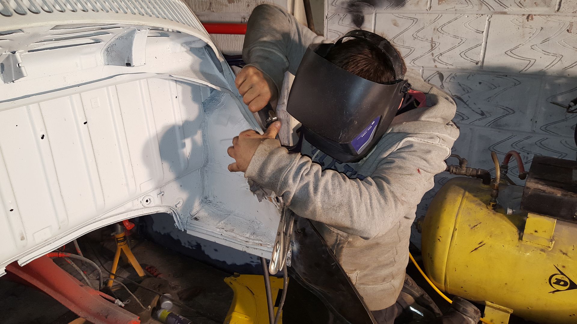

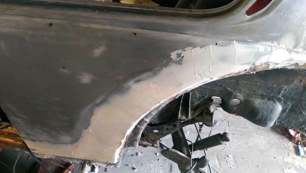

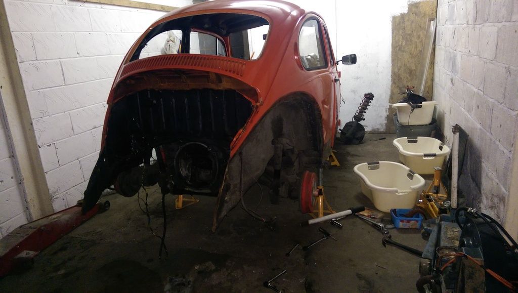

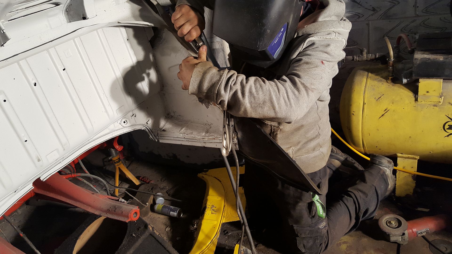

CraigRobbo January 27th 2016 15:05
Thanks for the warm welcome guys.

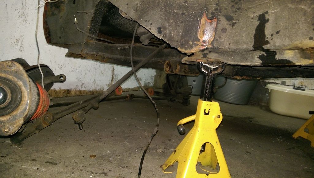

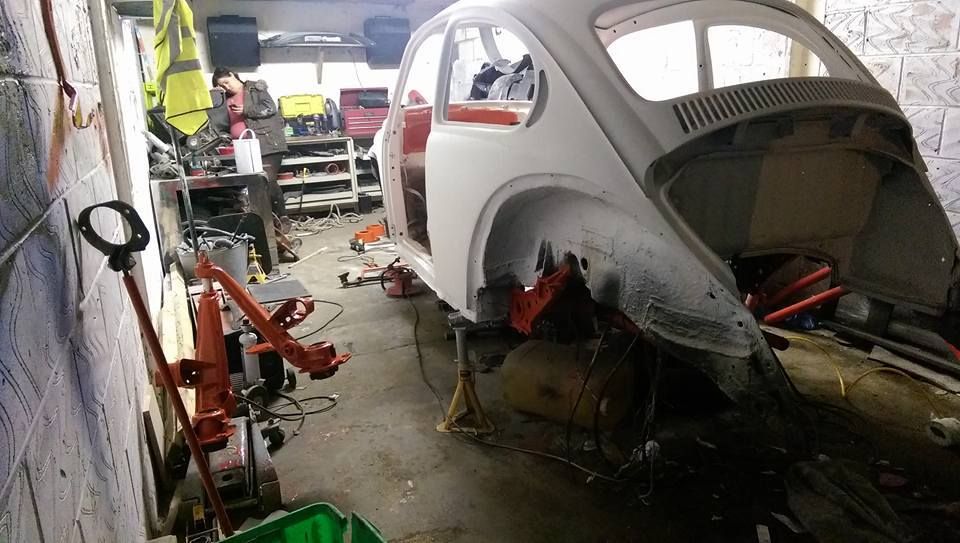

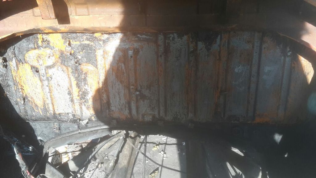

I have some updates from today, repairing the rear panel :)
I seem to have gotten it slightly off but I am sure I can sort that out
http://i200.photobucket.com/albums/a...k.jpg~original

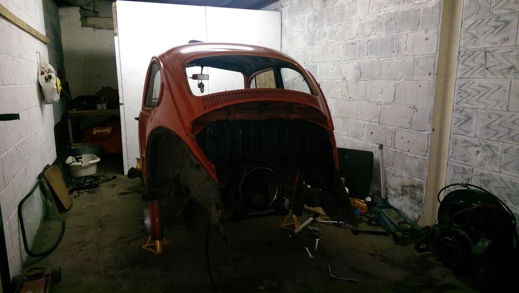

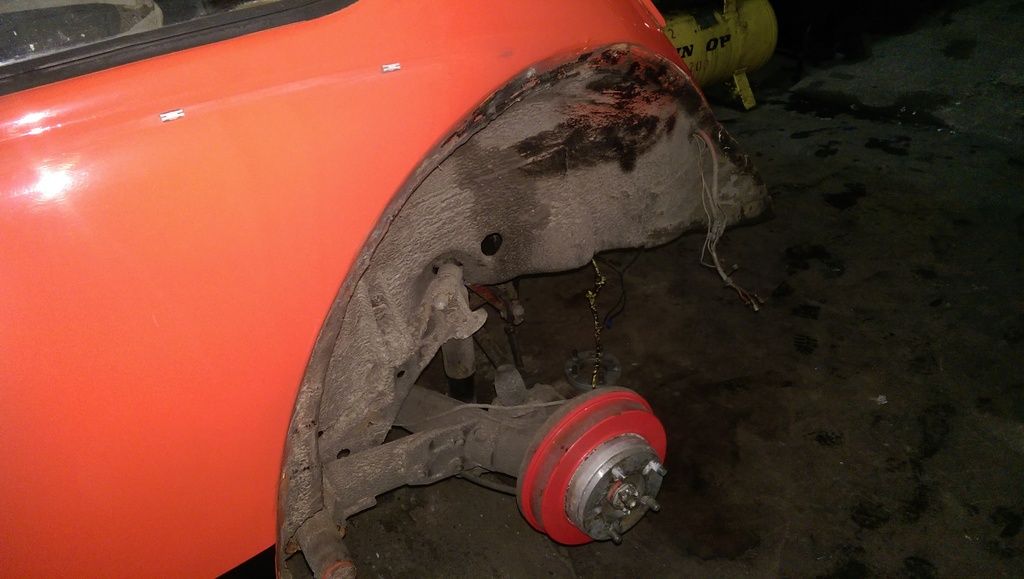

CraigRobbo February 11th 2016 16:30
Thanks, I am not goign insane but she is having a rollcage front and back strut bars but I am already a bit past doing much more and to be honest, Its not goign to be a mental track car just a nice street, / track day' drift car
http://i200.photobucket.com/albums/a...t.jpg~original
http://i200.photobucket.com/albums/a...z.jpg~original
