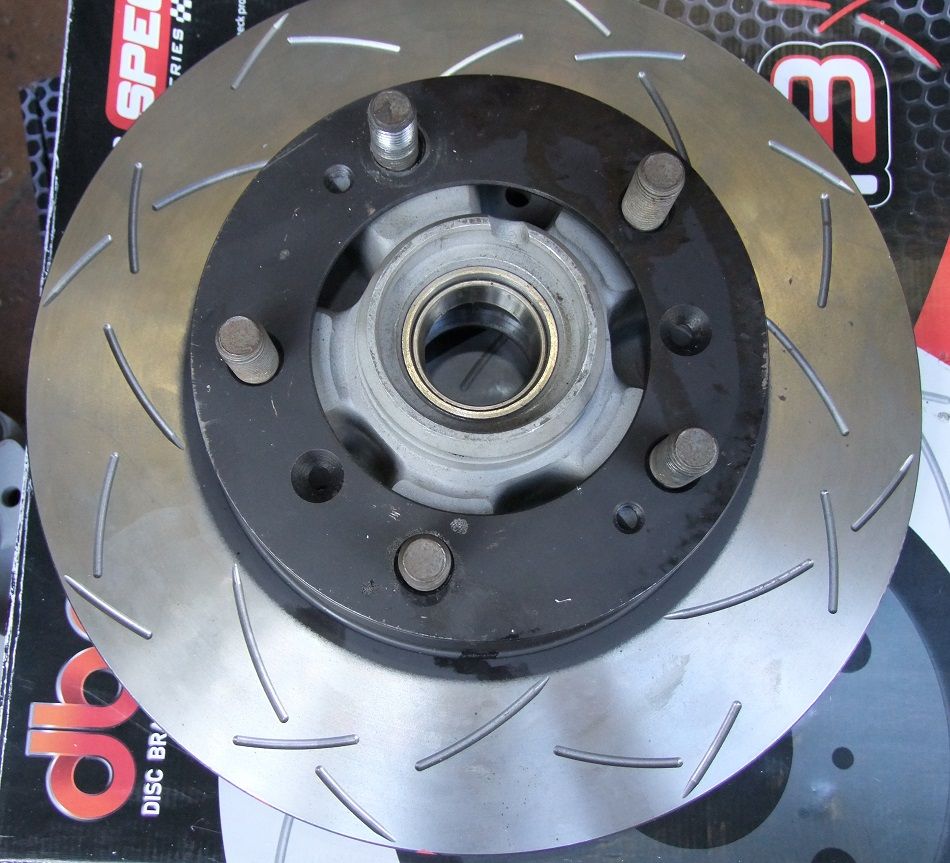

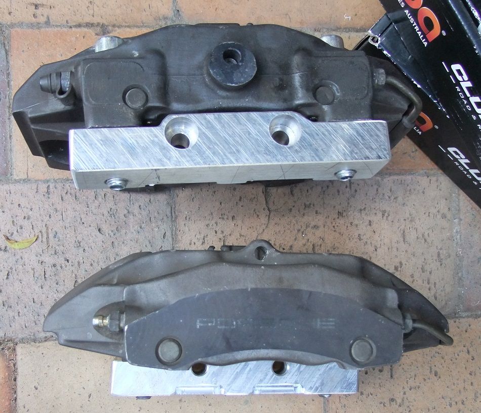

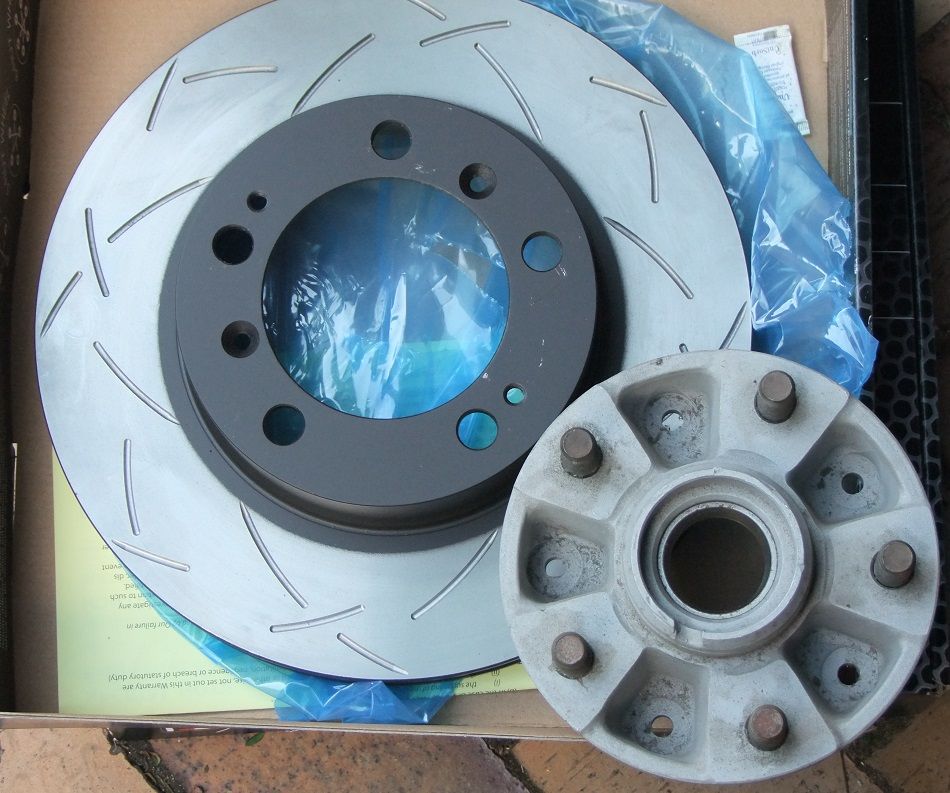

I fitted them to Beetle stubs using 944 hubs
http://i1184.photobucket.com/albums/...6.jpg~original
http://i1184.photobucket.com/albums/...q.jpg~original
http://i1184.photobucket.com/albums/...9.jpg~original
http://i1184.photobucket.com/albums/...l.jpg~original

Recondition the calipers
Hi Steve, Question did you recondition the calipers yourself? If so how are you able to recondition the Porsche lettering so nicely.
Steve C March 5th 2016 17:59
I just painted the outside, so a rattle can restoration and lettering is a decal I bought on eBay, they have stood up to the heat very well.
Lucky I bought a few spare decals as they wanted to to stick to the backing and not to the calliper.
Generally Porsche callipers have stainless piston which don't corrode so I full rebuild is not always needed.

Turn the early hubs down to 157mm and theyll fit the 986s rotor. I can make the caliper adapter but the axial offset can vary depending on how your 944 hubs were machined for t1 spindles.
