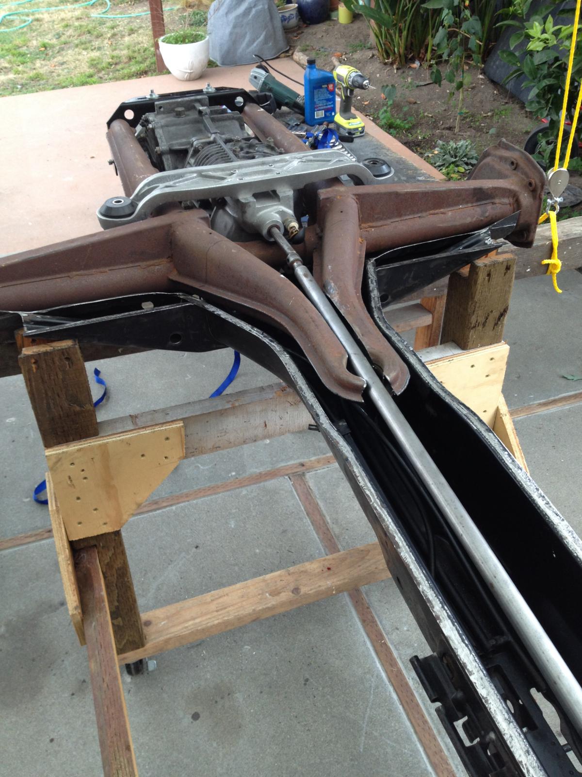

OK, on to the front mount.. You will likely completely remove this entire area of your car, and move the motor like five inches forward, right?:D
Maybe also raise the drive train an inch or two while you're at it?:cool:
Either way, the shift rod on a P-car has to go right up through where this circle is drawn. Your circle will likely have to be about a foot in diameter?
https://www.thesamba.com/vw/gallery/pix/1160039.jpg
https://www.thesamba.com/vw/gallery/pix/1165231.jpg
If you dig around in my build thread there are a bunch of pics of how I tunneled thru the front sub mount, and used four factory torsion tube mounts on the side of the tunnel,
The pan gets modified, build a house under the rear seat, etc. etc.
But I'm guessing you will be solid-mounted, and the front of your trans will not only be different, but way farther forward.. so we'll skip that whole part..
My own build thread is too big for me to even dig thru..:rolleyes:
The shifter is offset to the driver's side in a type 3.
Additionally, there is an elevation change front-to-rear.
I solved both of these issues by using these sealed steering u-joints I got from Summit or Jegs or someplace.
That also means you'll need another shift rod bushing in the tunnel, so it doesn't just deflect..
https://www.thesamba.com/vw/gallery/pix/1165250.jpg

This is turning into a great read, thanks for all the additional info Clatter.
I cut off my chassis forks and made new ones from 1 3/4" roll cage tubing, I used 40 HP length torsion bars (30mm Swayaway) when I cut through the torsion bar area for my G50
