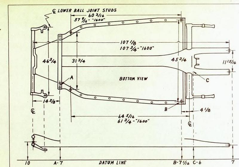

http://www.superbeetlesonly.com/body/framechart.jpg
go to Superbeetlesonly.com, flick to tech articles, there's a link there for chassis dimensions for superbeetles...

That dimension sheet is from the Bentley workshop manual
1200 1961-65' page A28

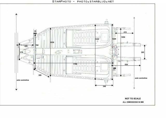

I too need a pan drawing for a standard Beetle.
Goal is to modify a Rorty design chassis for a Speedster, using the front 1/2 from Rorty and grafting on the Beetle rchassis c/w VIN from the torsion tube back. I would go full on rorty but need to keep the VIN for registration.
ajsyrup January 23rd 2007 09:18
i have these of a standard beetle that were saved on my computer hope this helps
http://i17.photobucket.com/albums/b9...t.jpg~original
http://i17.photobucket.com/albums/b9...S.jpg~original
Bad bug January 28th 2007 21:22
Are the dimensions on the first chassis in mm.
wrenchnride247 January 28th 2007 21:41
Yes, badbug metric.
