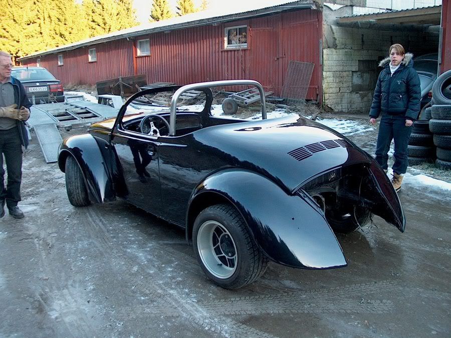

Hi again!
Just took a couple of pictures of this winters project, my girlfriends 1972 1302 S Roadster.
I have many plans for this car, but my wallet doesn`t agree... :rolleyes:
If anyone has a free set of 16" Porsche Fuchs let me know!
More pictures will be added during the asembly process. (Did I spell that right?) The car is planned finnished in the end of April 2005.

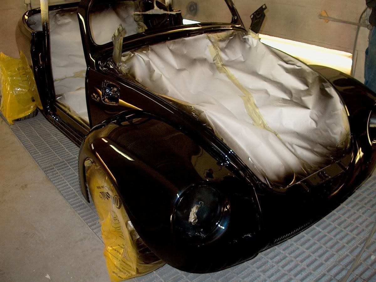

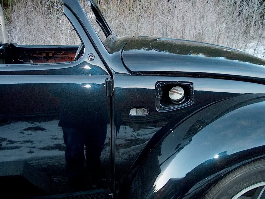

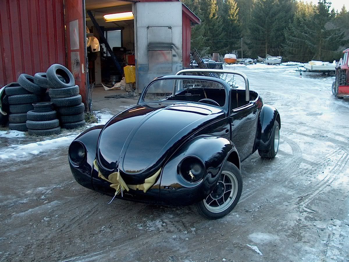

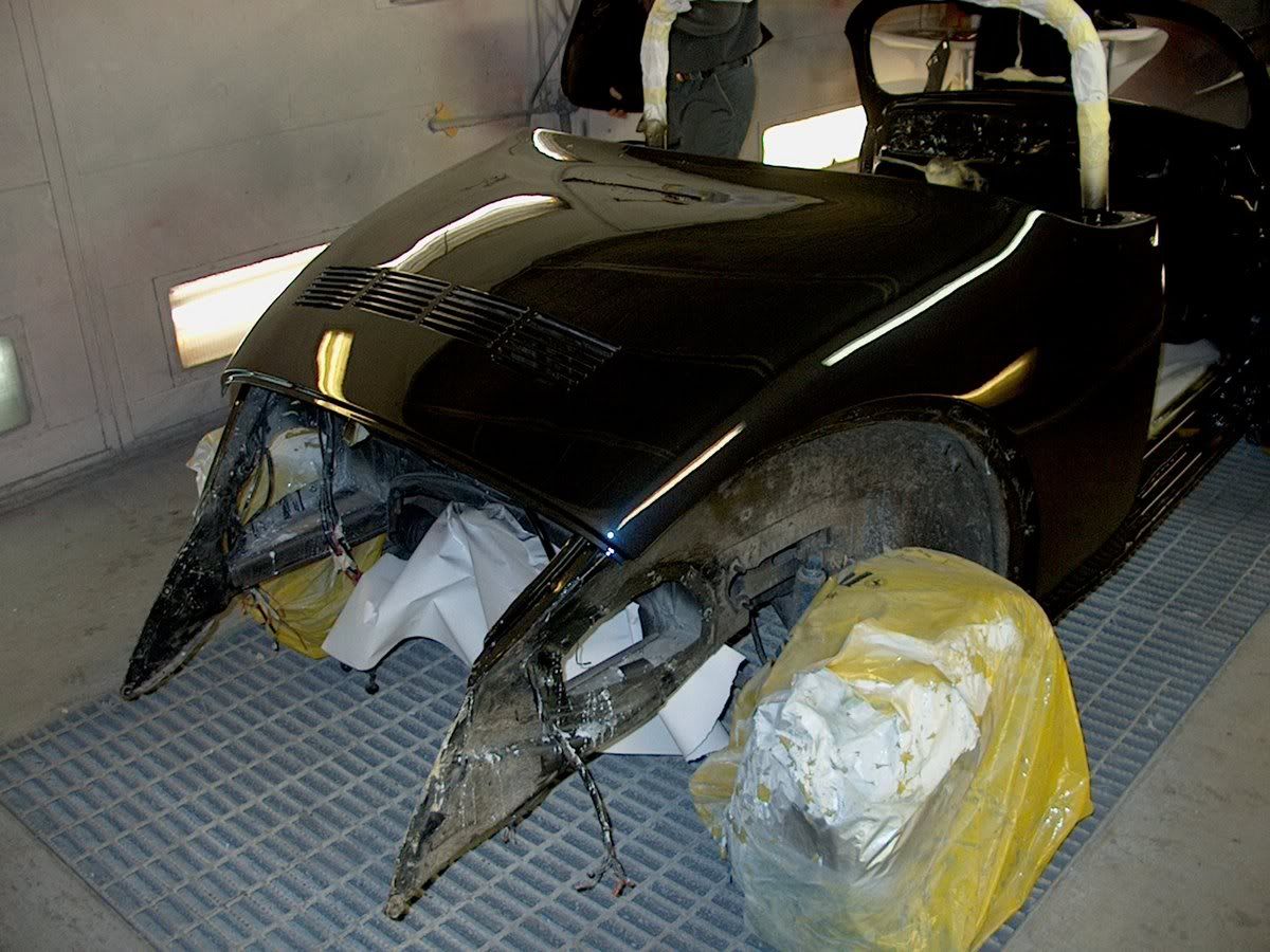

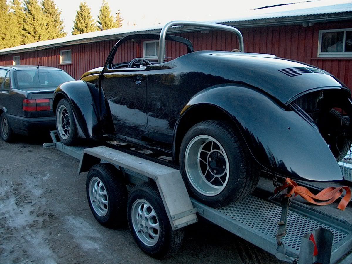

boblebaard December 31st 2004 10:13
Picked up the car today, so here`s some new pictures for you! ;)
