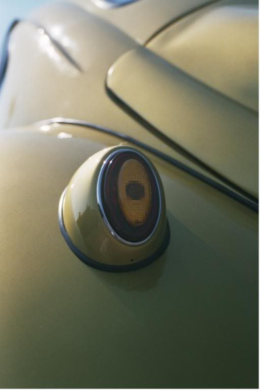

BWE March 7th 2005 20:56
1 Attachment(s)
Domer, LED's in the bumper... version 1.0. Next ones will be better mounted with smaller & brighter lenses. These have two banks each side, one for running lamps/brakes and one for turn signals. New setup will have same but with one bank being tail/brake and the other brake/turn.
