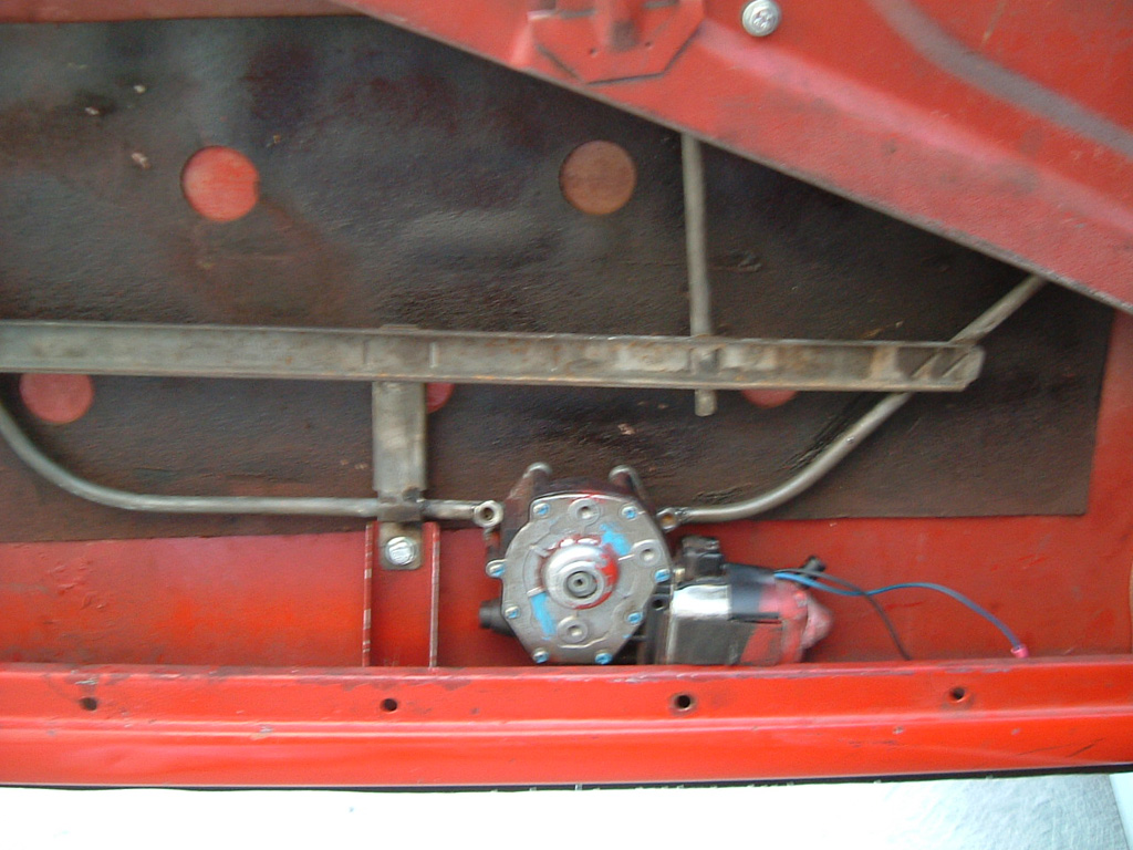

pribs67 May 23rd 2005 00:05
Well, I finally got everything installed in the doors for the power windows. What I ended up doing was reproducing the factory notch in the regulator (that the crank gear sits in) about 2 1/2 inches forward of the bottom window mount. Then I used the RH motor in the LH door and vice versa. I had my buddy weld nuts onto the regulator channel to hold the motors in place. I ended up re-using half of the original crank housing to keep the regulator in place. I'll finish up the wiring and install the switches this week. It really works well and the install was a breeze with the motors at the bottom of the door where they don't interfere with anything. I know I keep promising pictures, but they'll come this week in addition to a tech article.

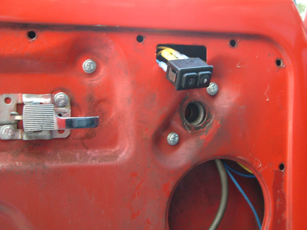

pribs67 August 12th 2005 01:55
Here are some pictures:
http://www.thesamba.com/vw/gallery/pix/221759.jpg
http://www.thesamba.com/vw/gallery/pix/221761.jpg
Feel free to ask questions.
