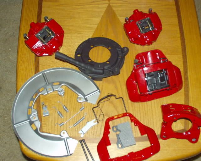

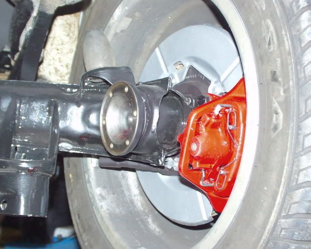

KaferChris April 9th 2006 18:23
Thanks again for the advice and parts.
http://img.photobucket.com/albums/v2...9.jpg~original
