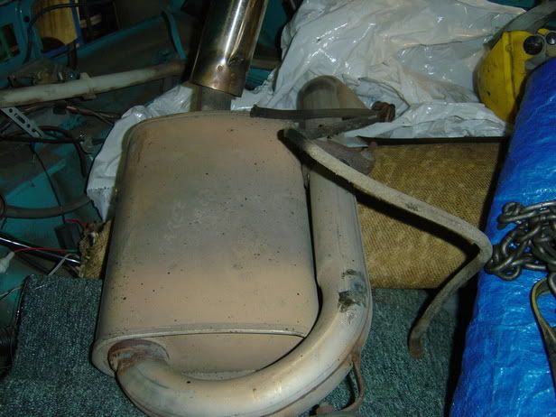

heres mine on my 2L t4 thats in my sbug. i started with shortened kombi heater boxes which attaches to a modified kombi extractor which has been adjusted to fit and finishes in a tuck away exhaust. the whole system is 1 5/8".
http://img.photobucket.com/albums/v3...9.jpg~original
http://img.photobucket.com/albums/v3...8.jpg~original
http://img.photobucket.com/albums/v3...7.jpg~original

i got the pipes bent by a muffler place just went in with a bit of wire the shape i wanted then welded it up my self. im currently redoing the whole car so the exhaust will be changed to a twin muffler setup with one for each side but it will be a while before i start on it cause ive got to rebuild the motor before hand.
