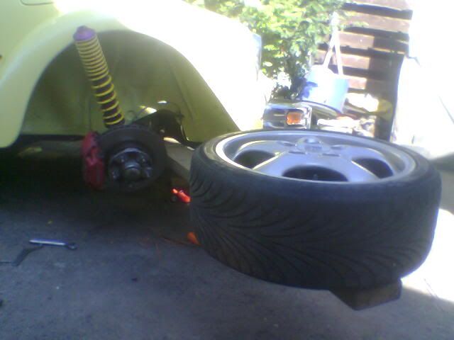

I use Koni yellow, front and rear. The rear is simple, the front is more involved... I don't have to upset my alignment, still a ball-ache compared to the rear:
http://i37.photobucket.com/albums/e5...5.jpg~original
Matt
