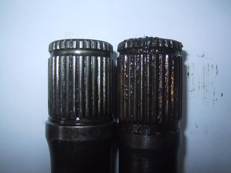

On the left is a type1 axle and on the right a 944, this clearly shows the difference in spline lenght and why a type2 or 944 cv will not fit on a type1 axle because of the difference in width of the cv inner race.

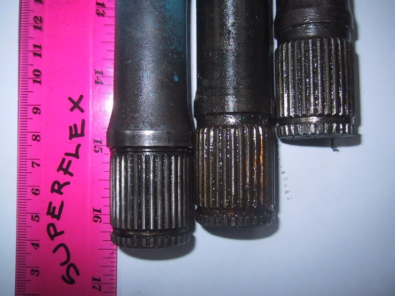

Here we see the overall lenght of the different axles, from the top is the type1 axle (in a lovely shade of blue, don't ask!) then 2 different lenght 944 axles. But why have I got two different lenghts as I didn't think the 944 gearbox was off set?
http://i16.photobucket.com/albums/b1...3.jpg~original

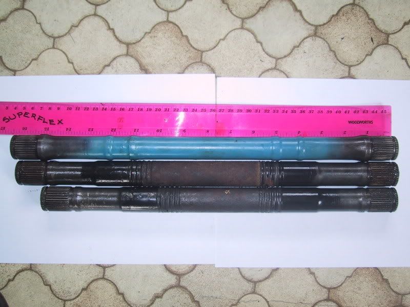

The axle lenghts are :
Type1 416mm
944 382mm & 411mm
http://i16.photobucket.com/albums/b1...2.jpg~original
