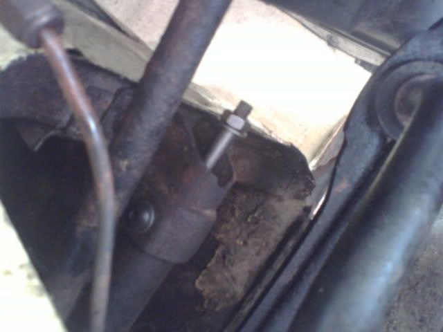

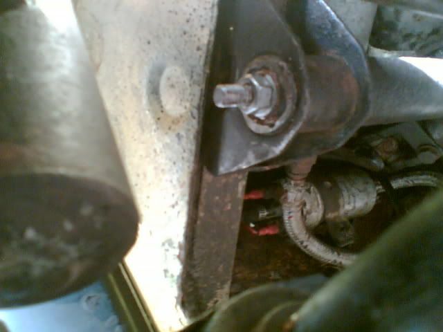

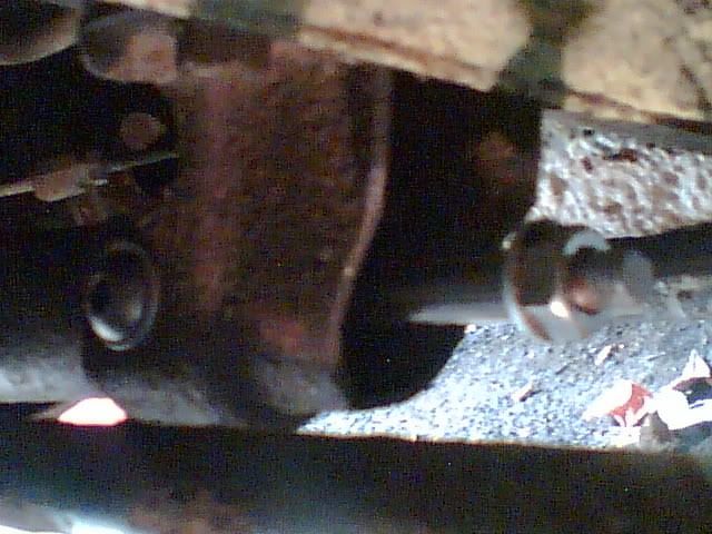

The modification for adjustable steering limits, to prevent your expensive wide tyres from fouling the innerwings/failing your anual inspection consists of 2 screws with jamb-nuts. One each side, they push the foam buffers deeper into the housing, which will pull the wheel away from the innerwing on full-lock on the same side.
Note, my Beetle is RHD.
http://i37.photobucket.com/albums/e5...5.jpg~original
http://i37.photobucket.com/albums/e5...1.jpg~original
You will have to drill through that plug, all the way through and tap it to either M8 or M10.
The M8 nut and bolt that passes through the plug and passenger side mounting bracket will have to be omitted. Drill the holes in the bracket and the housing out to 10mm. Tap the hole in the plug that the M8 bolt goes through out to M10 and replace with two M10*15 bolts. You will need a ~60mm length of tube ID 10mm to put the jamb-nut out beyond the mounting bracket.
The drivers side requires you to remove the cap that is welded into the housing. Either grind through the weld or saw beneath the weld, only cutting the housing and not the cap. The cap will then need a hole drilling in the centre. It has to be removed to keep the swarf out of the grease. Weld an M10 deep nut to a large, thick washer and weld this into the cap so that the M10 screw will pass through it dead centre. Reinstall the cap and reweld it in.
I ground through the weld on the first rack I did, the heat destroyed the foam buffer. Before rewelding the cap back in, send the rack all the way to the passenger side and push the buffer deep down inside the housing, out of the heat. The rack will move it back to the stop. I glued M8 repair washers to the buffers and profiled the ends of the screws to suit. I used M10 studding, and cut 8mm spanner flats for the adjustment/jamb.
Matt
