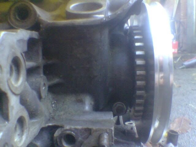

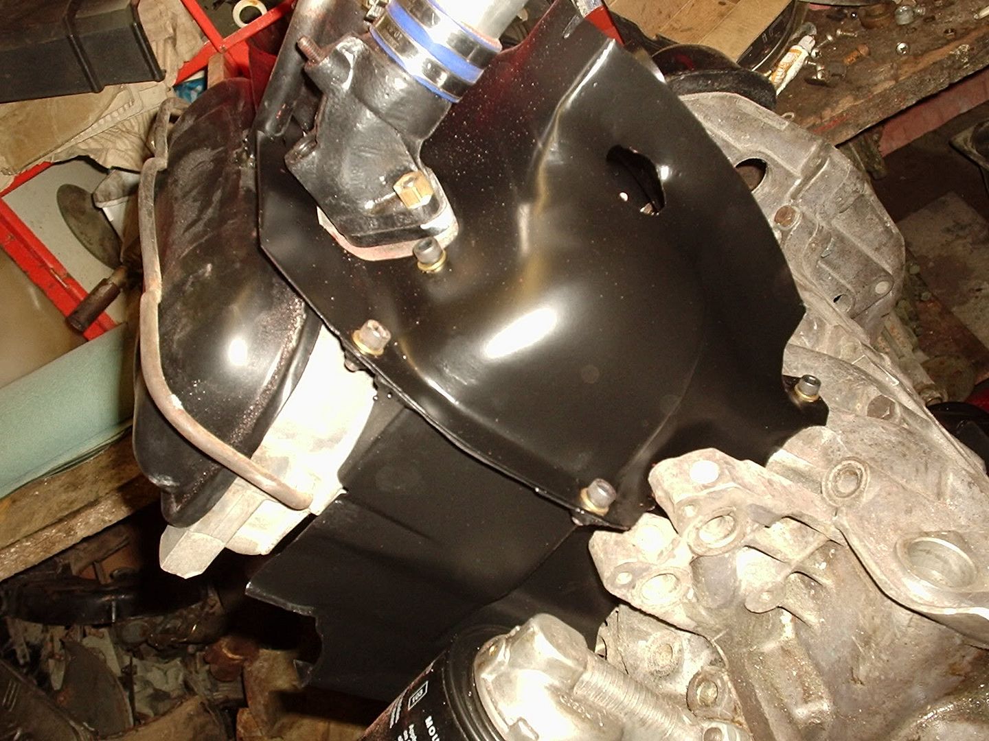

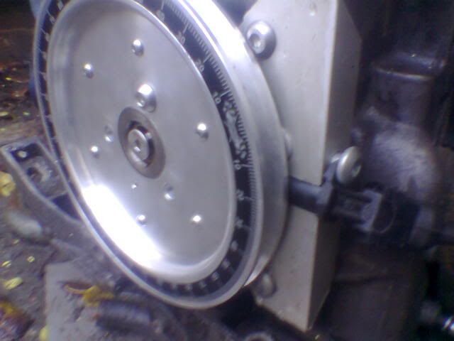

That is the system I've recently installed in my Beetle. To be more specific, MS1 V3.0 pcb MSnS-Extra29q with EDIS4.
The intended T4 is still on the bench but the MS is now installed in the car ready. I've had 20m of cable between the EDIS (in the car) and it's VR sensor (on the engine/bench) and 3m of cable to the wasted-spark coil pack on the floor, even cranking by hand it works. I even got some random sparks by holding the sensor close to the vents on my brake disc, I kid you not. I'm very excited about starting the engine. Here's some pics:
Matt
http://i37.photobucket.com/albums/e5...4.jpg~original
http://i37.photobucket.com/albums/e5...t.jpg~original
http://i37.photobucket.com/albums/e5...2.jpg~original
