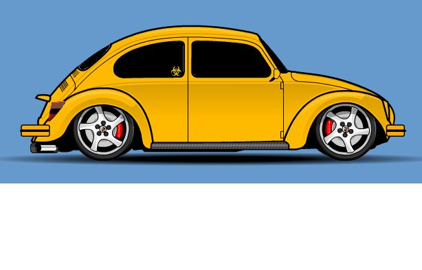

Here's an Idea of what I'm aspiring to
http://i11.photobucket.com/albums/a1...l.jpg~original

hey! that car looks very familiar. i used maxx from topline.the kerscher look like they have more adjustment.they also look easy to adjust in the pics ive seen.the only reason they are expensive is b/c of shipping.in europe they may not be all that bad over there.there are no distributors in the states for kerscher that i know of.
