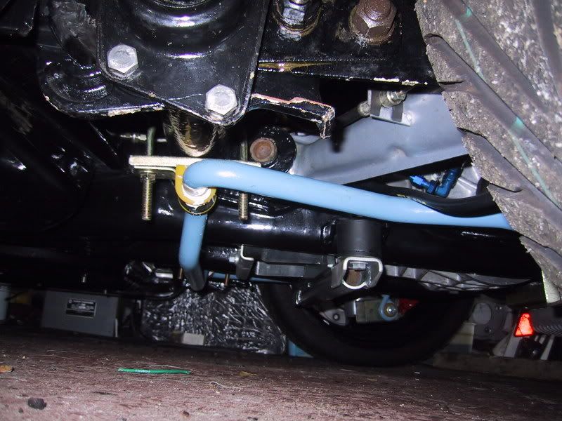

I was looking at the whiteline sway bar this morning on the net and a question came to mind. Would a berg intermediate mount interfer with the placement of the rear sway bar in anyway.

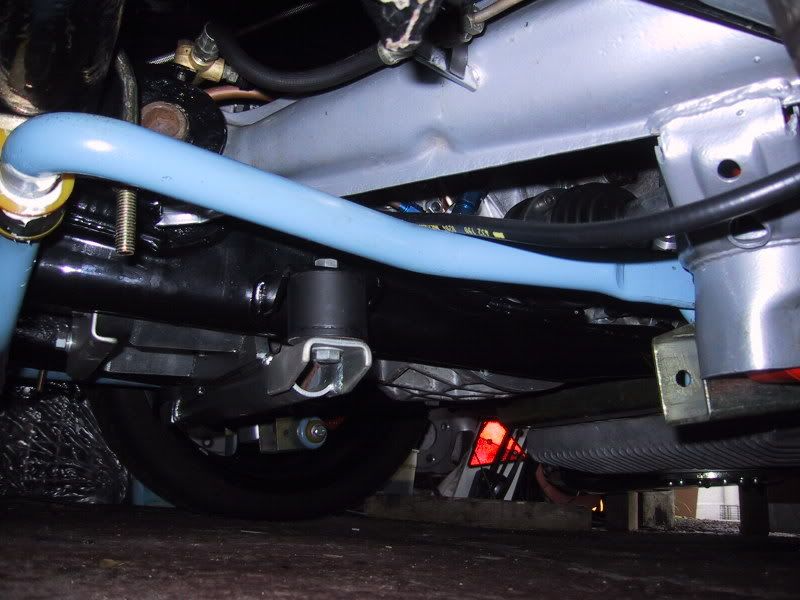

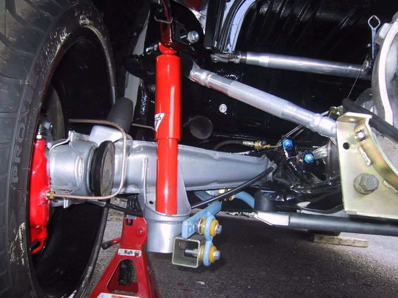

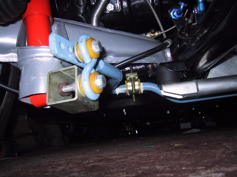

I've got both on a IRS rear and they don't although mind is a Berg 5 Speed nose but that is larger than standard. The whiteline bar runs across under the torsion tubes and comes out near at right angles to the lower shock mounting. I'll post a picture of what I have later tonight.

65Cabby January 5th 2007 09:51
this is the only picture I had that shows off the area.
http://i138.photobucket.com/albums/q...1.jpg~original
65Cabby January 5th 2007 09:52
But as I'm working from home today :) here are a few more.
http://i138.photobucket.com/albums/q...2.jpg~original
http://i138.photobucket.com/albums/q...4.jpg~original
