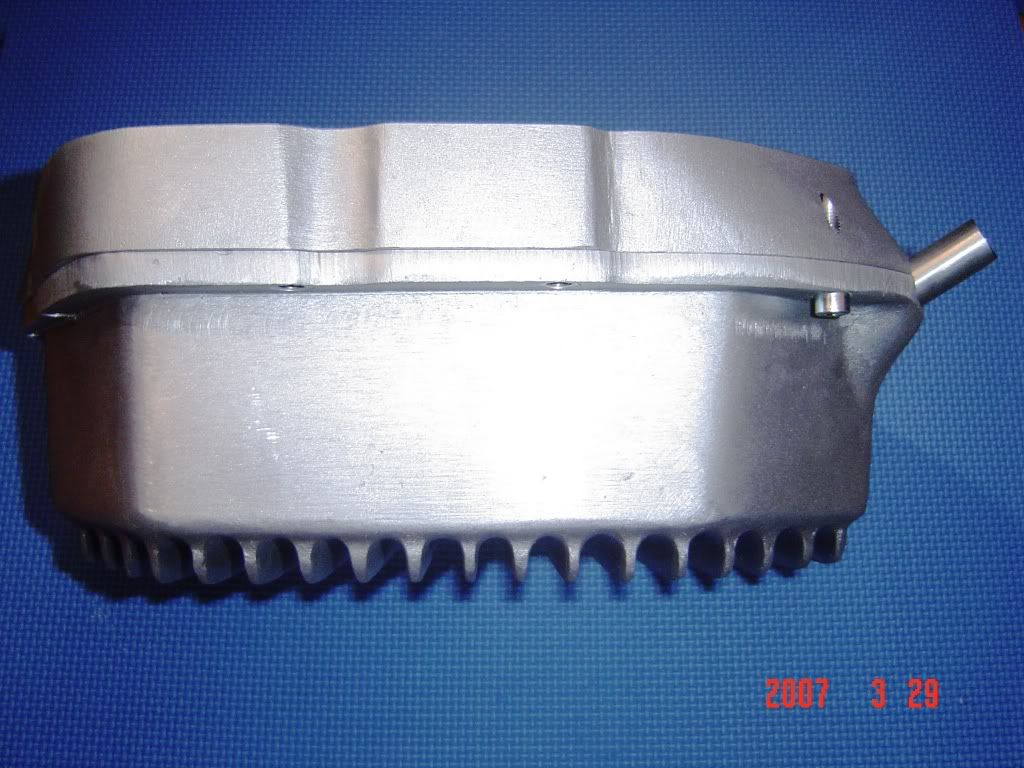

I have a spare oilpan and I'm thinking about shortening it.
I am by no means an experienced welder, and all I have is a hobby flux-core welder.
Do you think this is doable ?
I know Mikey did it, but he's a much better welder than I am... and I'm pretty sure he has a better welder too....
What do you think ? Hints ? Tips ?
Rob.

heres my shortened sump. I have made sure that it carries the same amount that the standard sump carries. 5 litres to be exact. WRX engines fail from a lack of oil as they are under oiled from the factory. if u shorten the sump & decrease the capacity, u may spin a big end bearing sooner rather than later.
My sump cost me $45 to make. $45 for the steel & a mate welded it up for me.
http://www.superbeetlesonly.com/foru...5_6_103994.jpg
http://www.superbeetlesonly.com/foru...95_6_83894.jpg
Hope this helps
regards
Jak

Jak,
How much is yours shortened by? How does it look internally, did you keep all the original baffling? Please stick some pictures up when you get it installed! Do you plan on relocating the oil filter too?
Cheers,
Rich
PS I enjoyed your update on the aussieveedubber forum, nice to read about some real world experiences...
jakriz October 13th 2008 14:45
I shortened it by an inch. This makes it level with the standard headers, I could see no point making it shorter then that. The standard oil filter & cooler stay in the factory position.
regards
Jak
