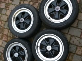

Carreralook -Sorry to hijack this thread, but I was going to ask a very similar question, and it may be useful for Carreralook as well... :)
I have just bought a set of 4 16 x 6 fuchs. The offset is 36 mm on all of them.
Is there anyway that these will fit on the front of a 1303 with standard width struts/springs? If not, whats the minimum needed to get them to fit and clear the struts / arches?
What tyres would be recommended for the front on these wheels?
The cars lowered by about 2.5 - 3 " already (using shortened springs) and has drums all around. These will be replaced by redrilled items.
http://i82.photobucket.com/albums/j2...1.jpg~original
Thanks and hopefully this will be helpful for CL as well.
Monkey
NO_H2O March 29th 2007 08:20
I don't think the 16x6 will fit with standard springs. I have 16x6 C2's on my 1302 and used MaxxStruts. The "Sport Springs" might work well for you if the MaxxStrut is out of reach. I run a 195/50/16 on the front and a 205/55/16 on the rear with stock fenders.

Jak Rizzo from Autralia had 16 x 6 front & 16 x 7 rears and had to run
a narrow spring in the front to get them to fit under the stock fenders...
